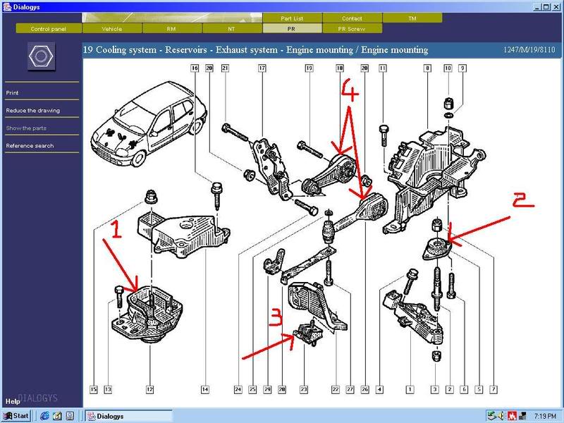

Is the dogbone the gearbox mount?
Could you explain where the 4 mounts are please?
The dogbone is the bottom engine mount that controls the horizontal movement of the engine. Use the oe metal mount and powerflex inserts. What a difference!
i think there's a picture from the workshop manual on here somewhere, but there's the engine mount above the cambelt, the upper gearbox mount (under battery), dogbone (underneath car at back of gearbox), and this little block that's fitted at the front of the gearbox
