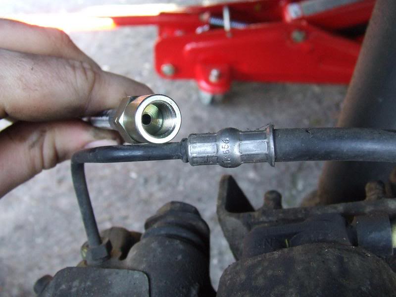

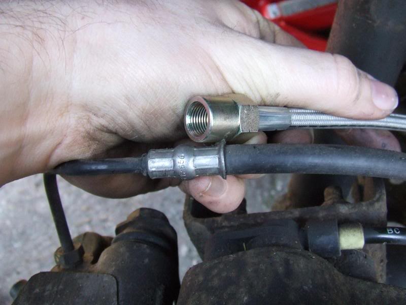

Went to fit them today looked at the back brake line and there is no way this fits:
My clio is a ph2 172, have i gone and got ph1 hoses?
The front ones look like they would fit, but don't want to risk it?
The back ones dont bolt onto the caliper like the front ones do they fit further underneath the car.
Follow the existing line under the car you will see where the back ones fit :)
You sure? as i thought they replaced that rubber bit?
Well not 100% sure no but thats how they fit on my old Golf VR6.
Was surprised to find they didnt fit near the caliper but there you go :S
Just had a quick look, there is some hoses that could be replaced under the passengerside at the back? but isn't the point they go by the calipers?
Not really, standard hoses can expand under heavy and prolonged braking, the goodridge hoses just stop this.
The pipes to the rear brakes are mostly metal anyway apart from a small length of rubber hosing.
Thats how they were on my old golf, if the piping you have found is the same length as the goodridge hose than id say they are the hoses to replace. :)
The hoses most suppliers offer. Are only for the connection from the underside of car, to rear beam. And not to the calliper.
I had some made up to replace the calliper high pressure hose. (Which you show in your pics.) Which also gives better protection and completes the system.
Hope that helps.

I know they go there, just the fittings don't look right to me.
