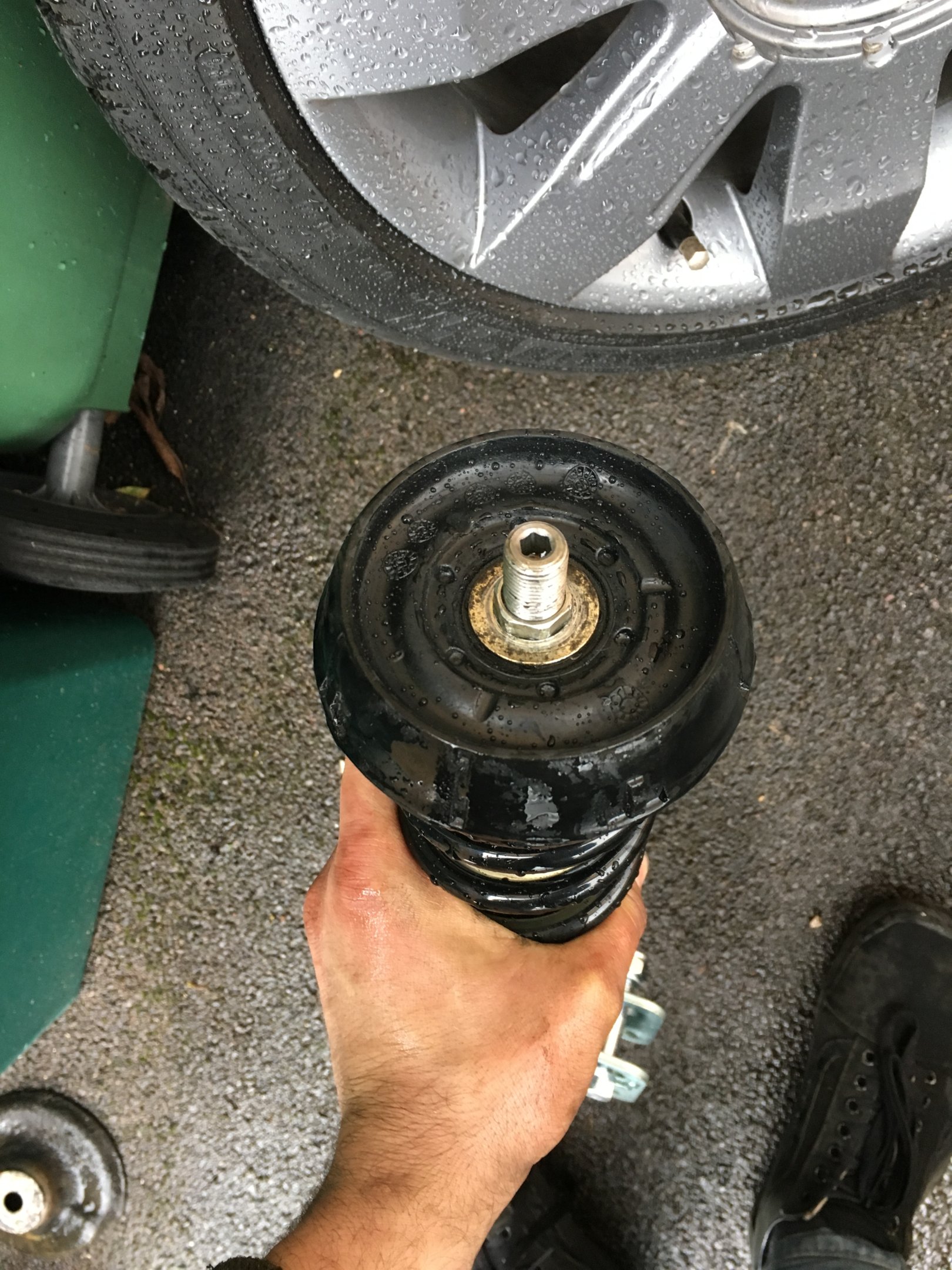

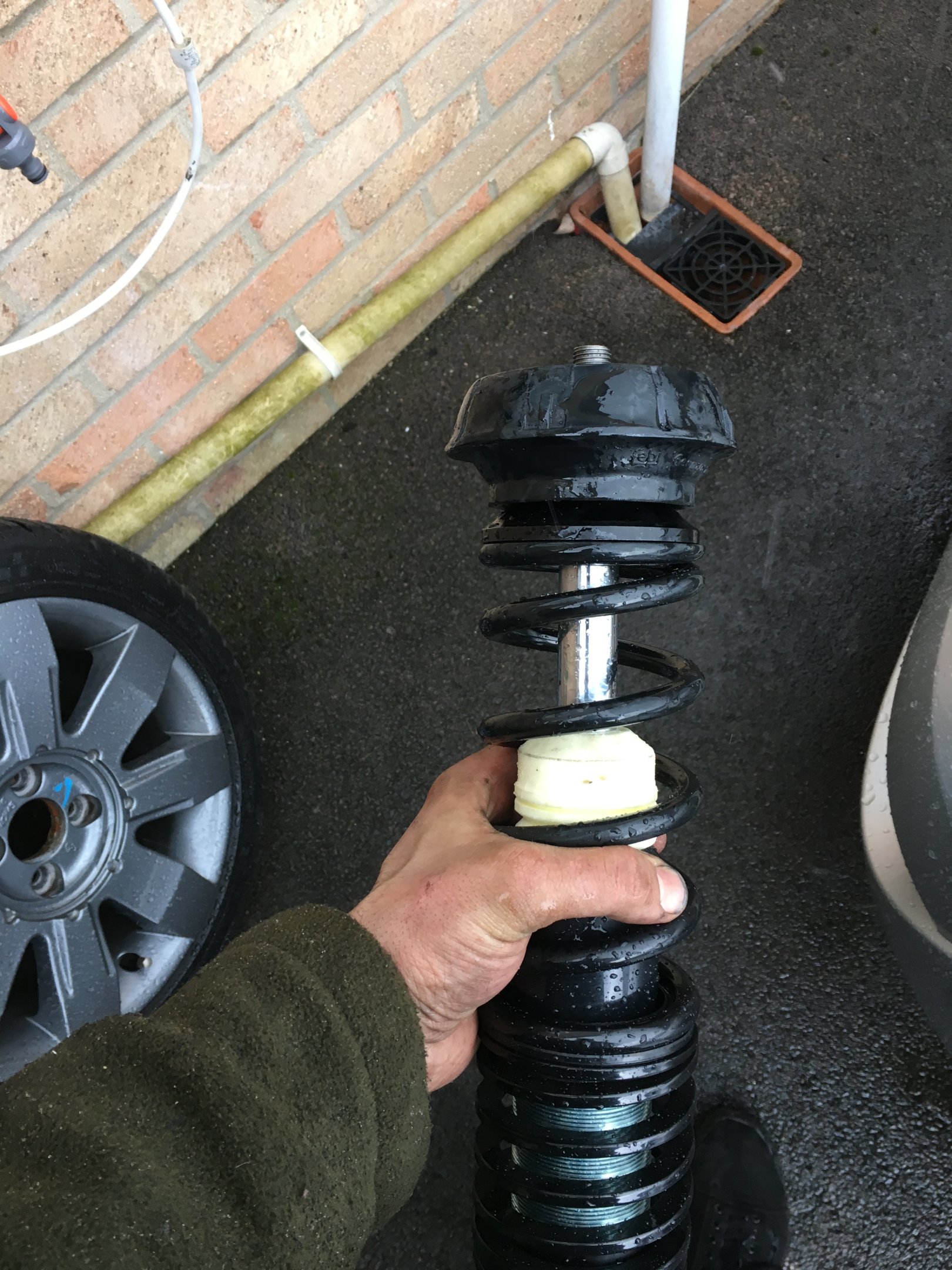

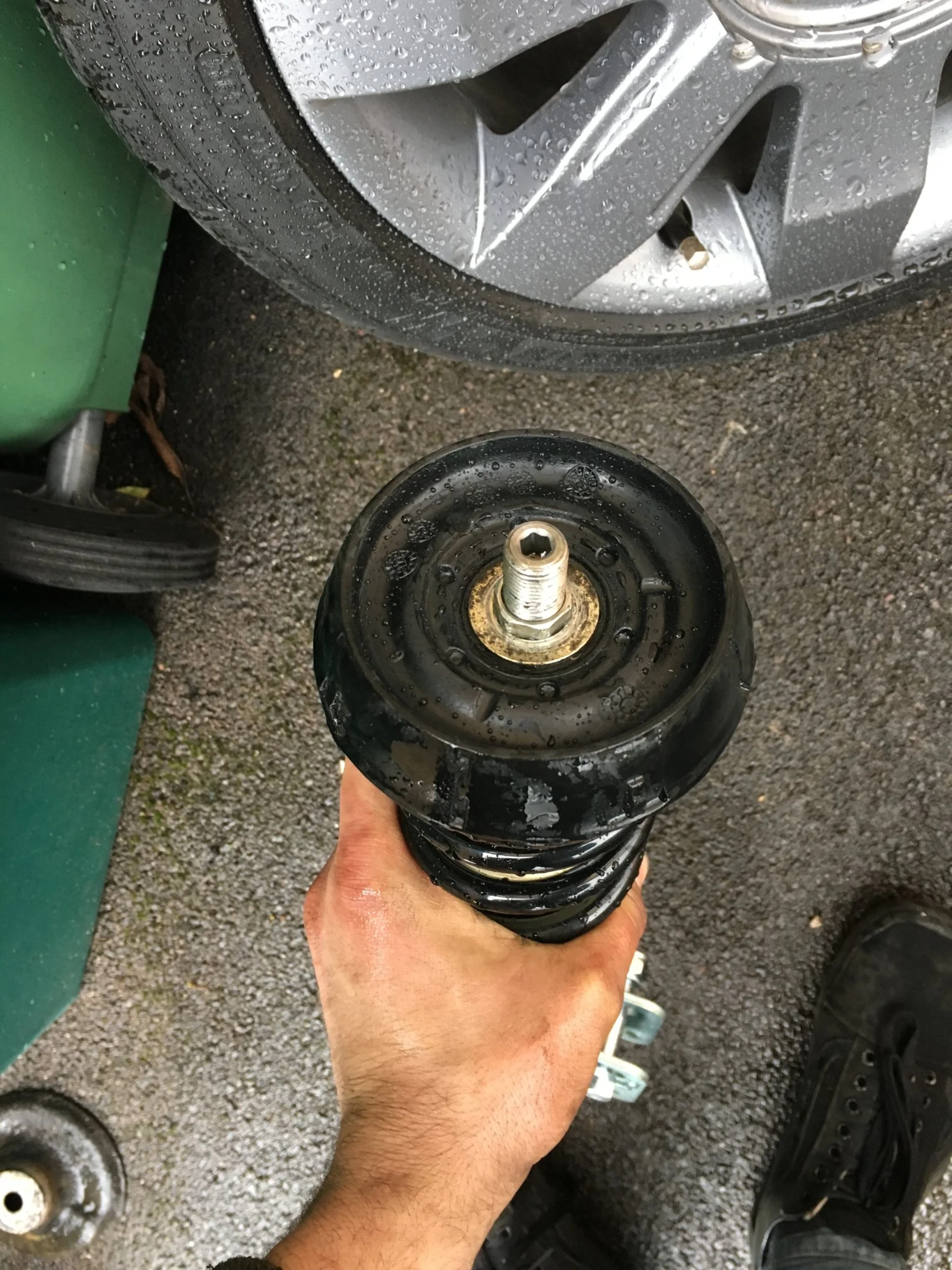

Hahaha yeah ended up having a go myself. Was a little worried but it was easier than expected. Bought a cheapish impact wrench and breaker bar to help out. I put new top mount donuts on like the image below. Look correct?

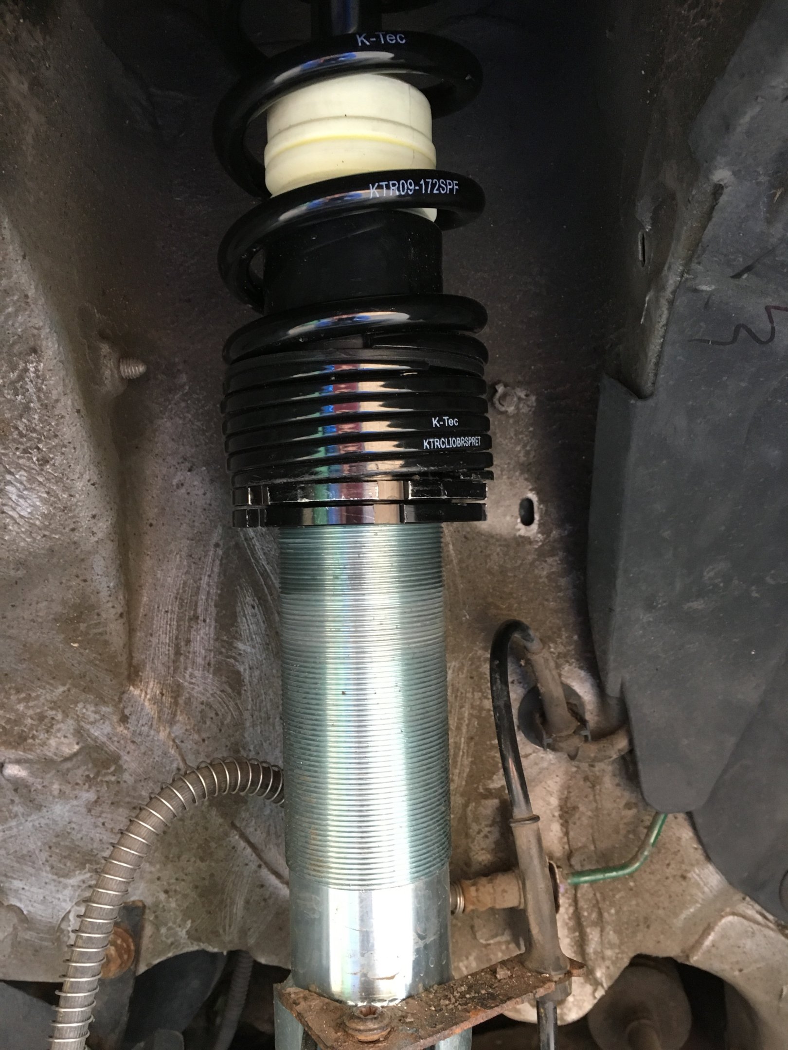

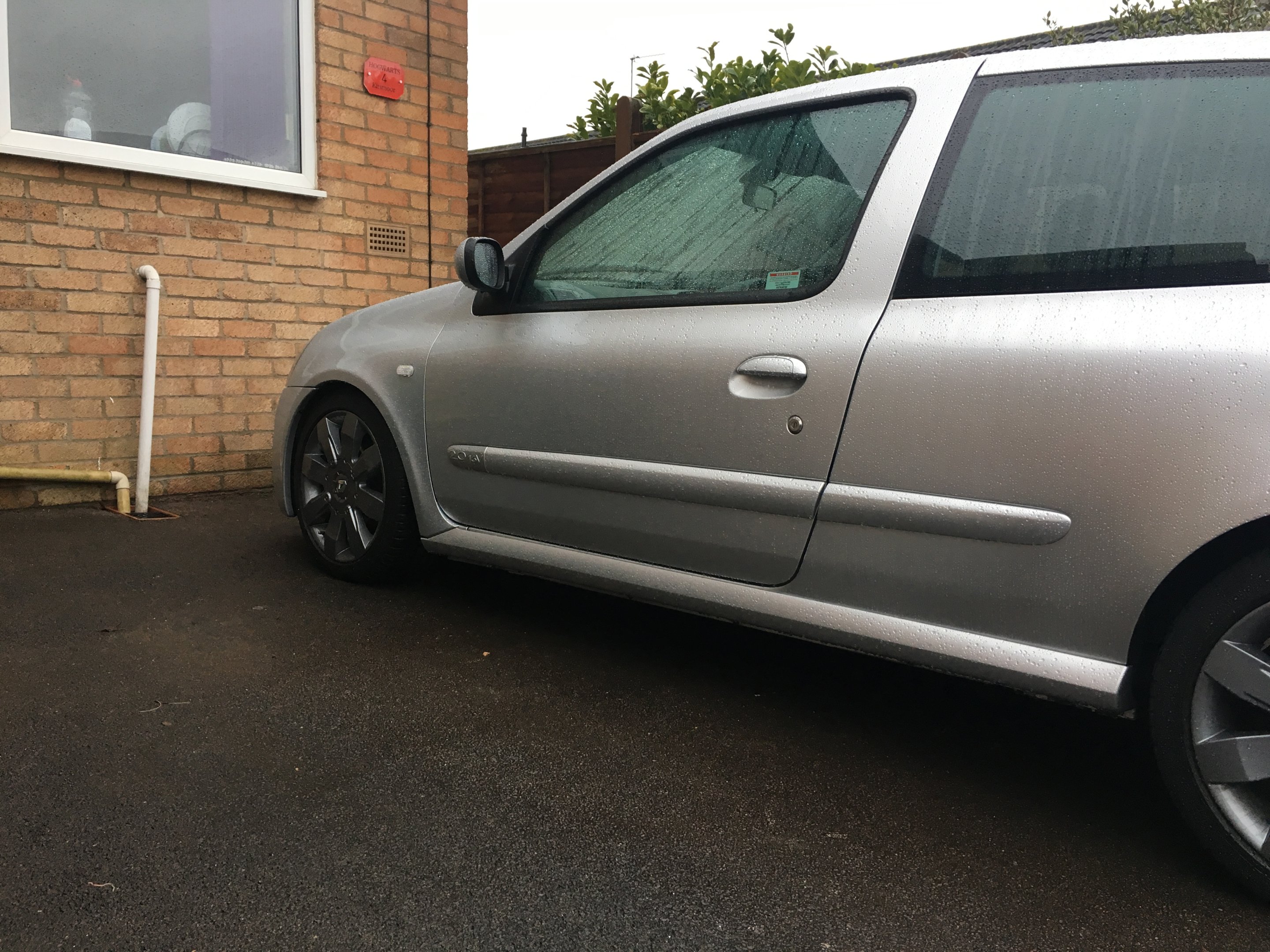

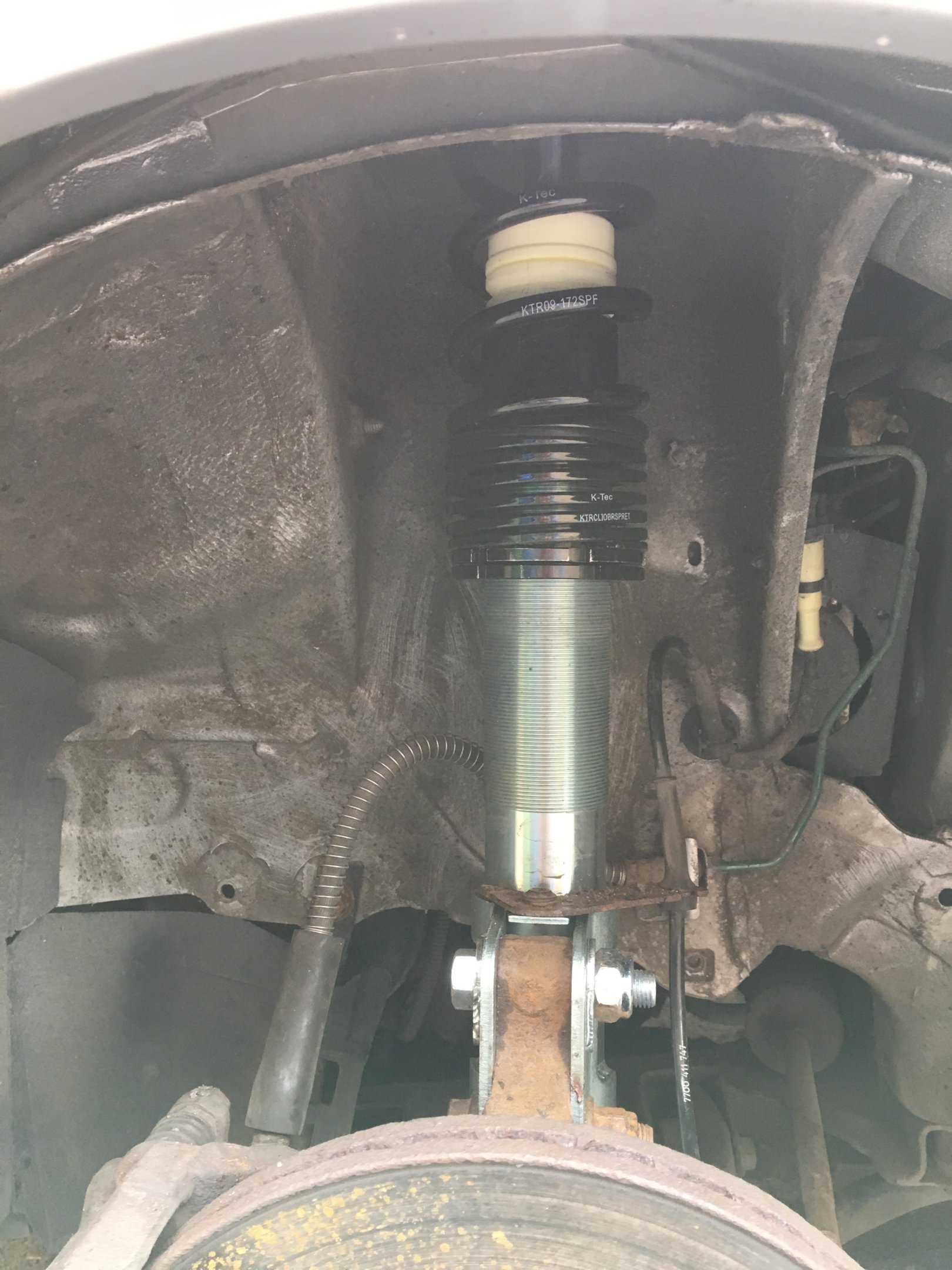

So to get the car higher as it’s way to low and scrubbing I can barely turn, I need to unlock the collar and wind the spring collar up. The set is -45 to -60. I assume the thread travelled isn’t directly relatable to the ride height?
Sooooo low!
Another shot of the donut. This is correct?
If you have a jack and basic hand tools have a go yourself, it's a very simple job and if you are worried about the top mount nuts just pop to a garage first and ask them nicely to buzz them off for you. Obviously retighten to sensible level before venturing home
Coops Mk1
  Lots of Scrap...
Yeah looks spot on and pretty much yeah move the platform up 20mm and you'll up the ride height by that too
  2005 Silver 182
Okay dokey. I believe I set them at lowest at first when fitting (spring just meeting the collar at bottom and spring cap up top. The pick above of the whole car is taken after winding them up at least 3 cm still not much lift. Wondering if the coilovers option was the one to go for! Suppose a few people on here run the Ktec coilovers without issue? Could the fact I’m on cup wheels have an impact? Was wanting some 2118’s soon. Maybe spacers to. If anybody was local and willing to come check it out that would be ace! I’ve also read some people remove the arch liners and cut the bumper bracket with dremel (which I’ve got). Any negatives to doing these two things? Cheers for all your help to!!!!!
Have read people cutting back before so should be okay. And you can go lower on the 2118s being a 15", a lot of people prefer the handling of 15's as well

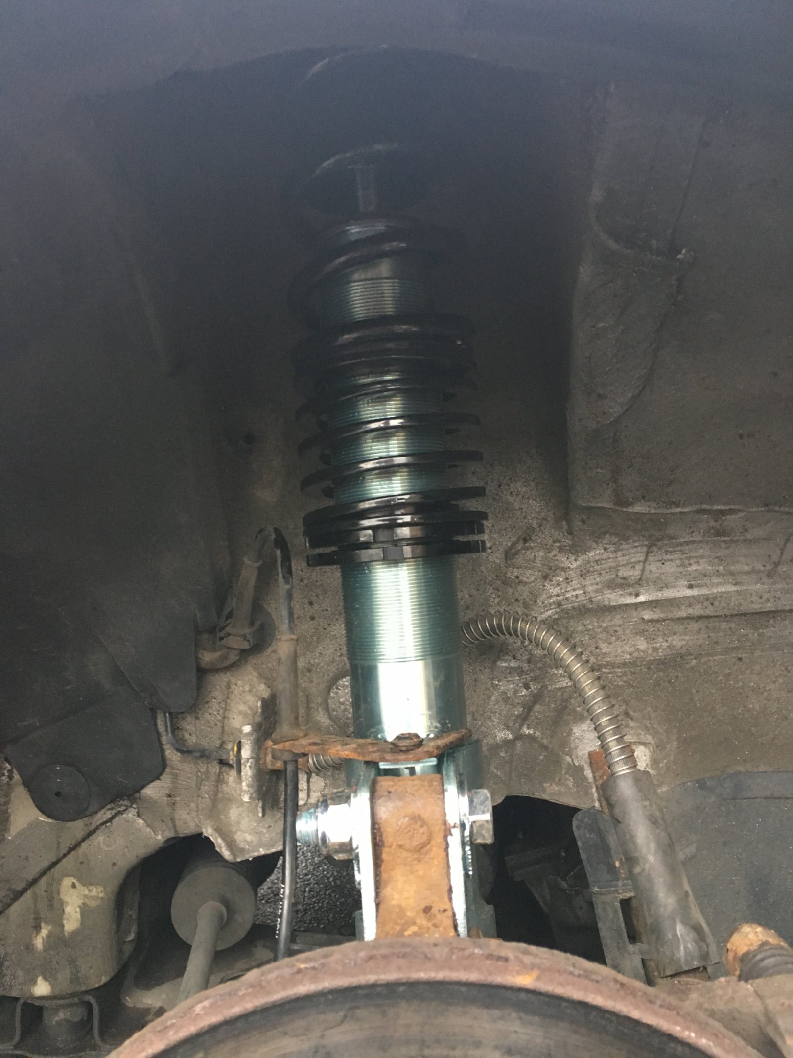

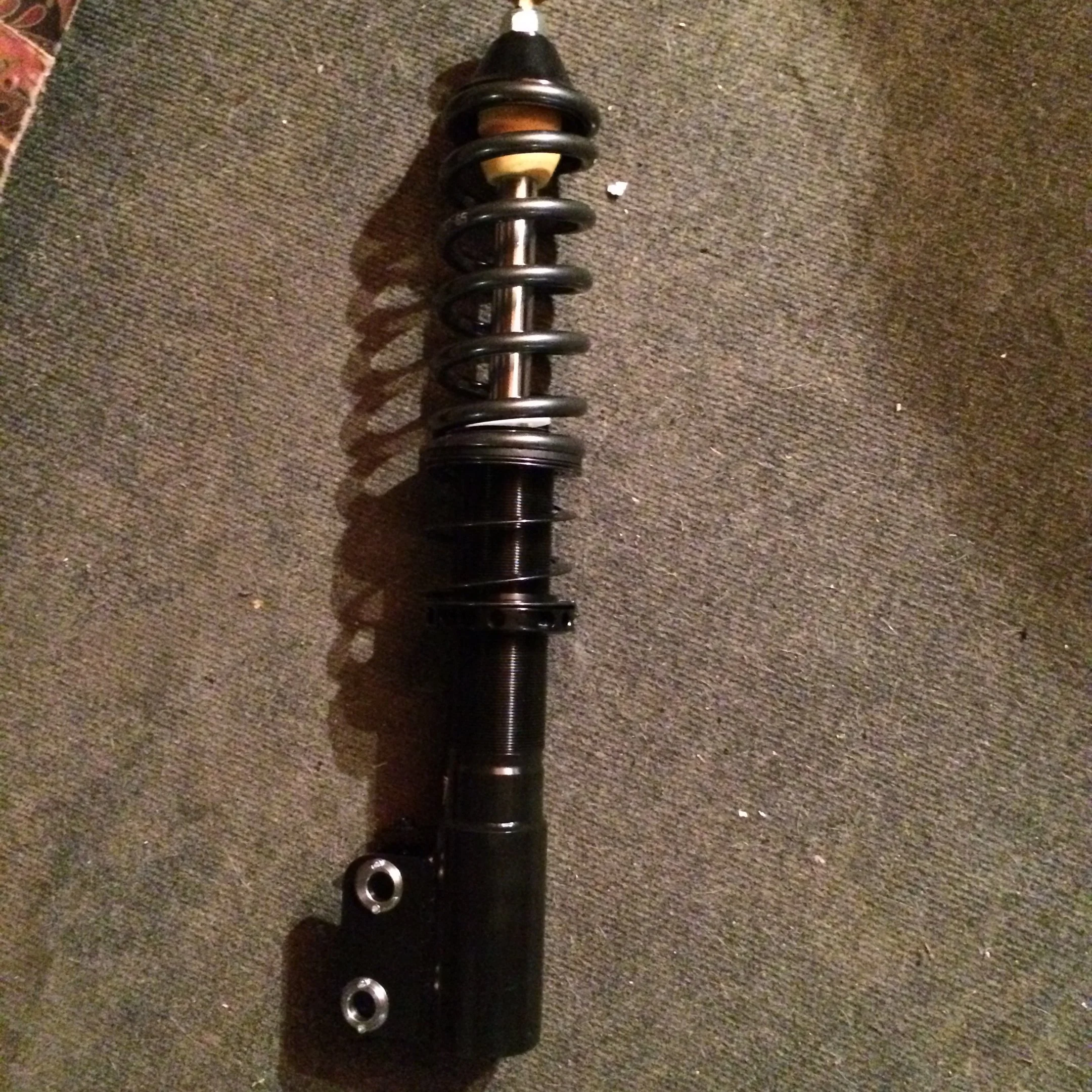

Okay so does anyone have Ktec coilovers fitted that can get a pic of how there springs are wound up. I wacked up the collar as far as I could really. The pre load spring doesn’t look overly happy though. I’ve modded my bumper brackets and liners just want to see how others set theirs up without rubbing before I set it back on it’s wheels. Thanks
green
  Hi comp phase 1
The helper spring will extend when no weight is on the shock keeping the spring in place from rattling around.
Well I think that’s how it supposed to work.
I’m sure someone more knowledgeable than me will be able tell you.
NorthloopCup
You're correct mate. The helper spring just keeps the spring seated at full droop.

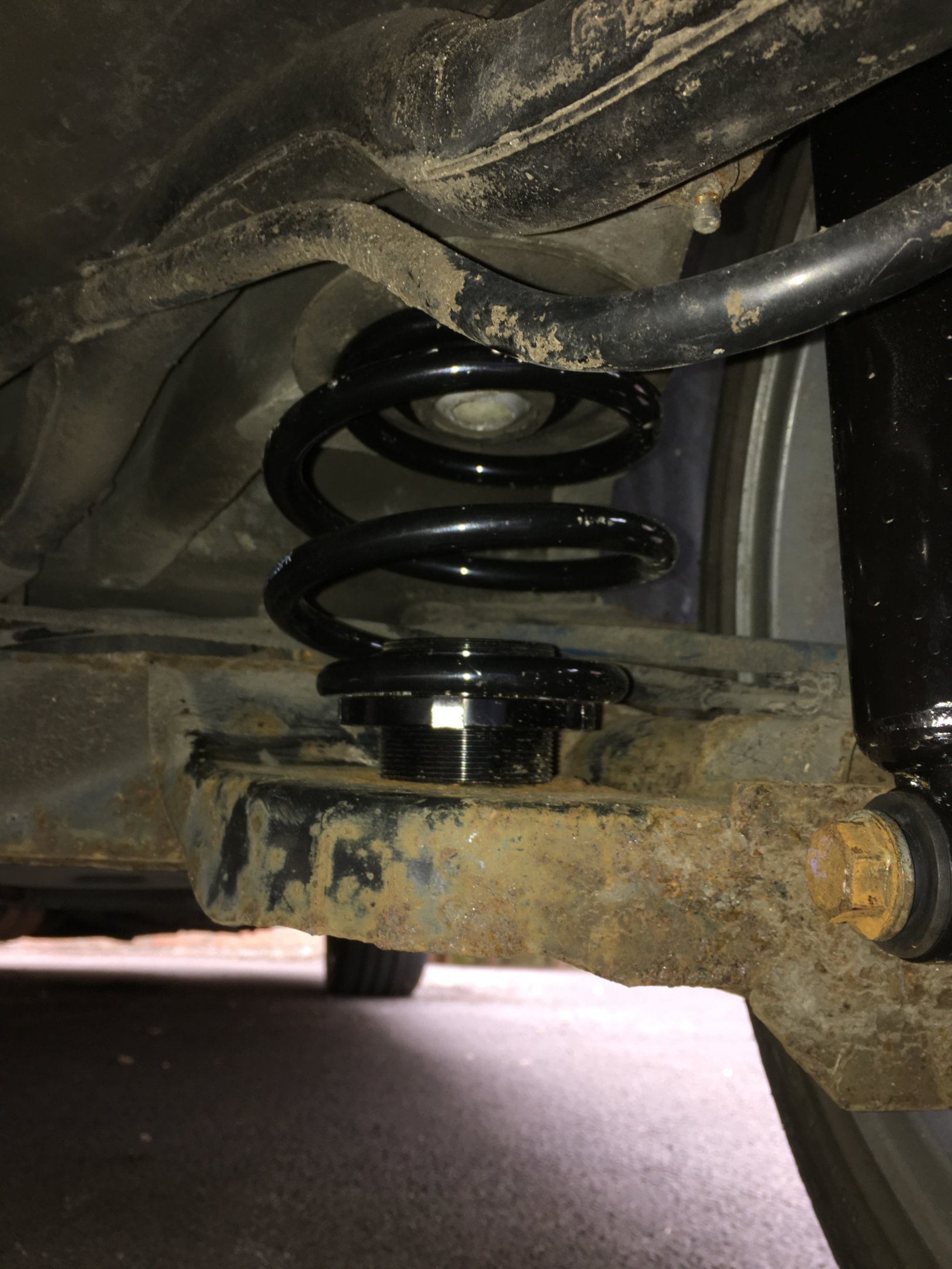

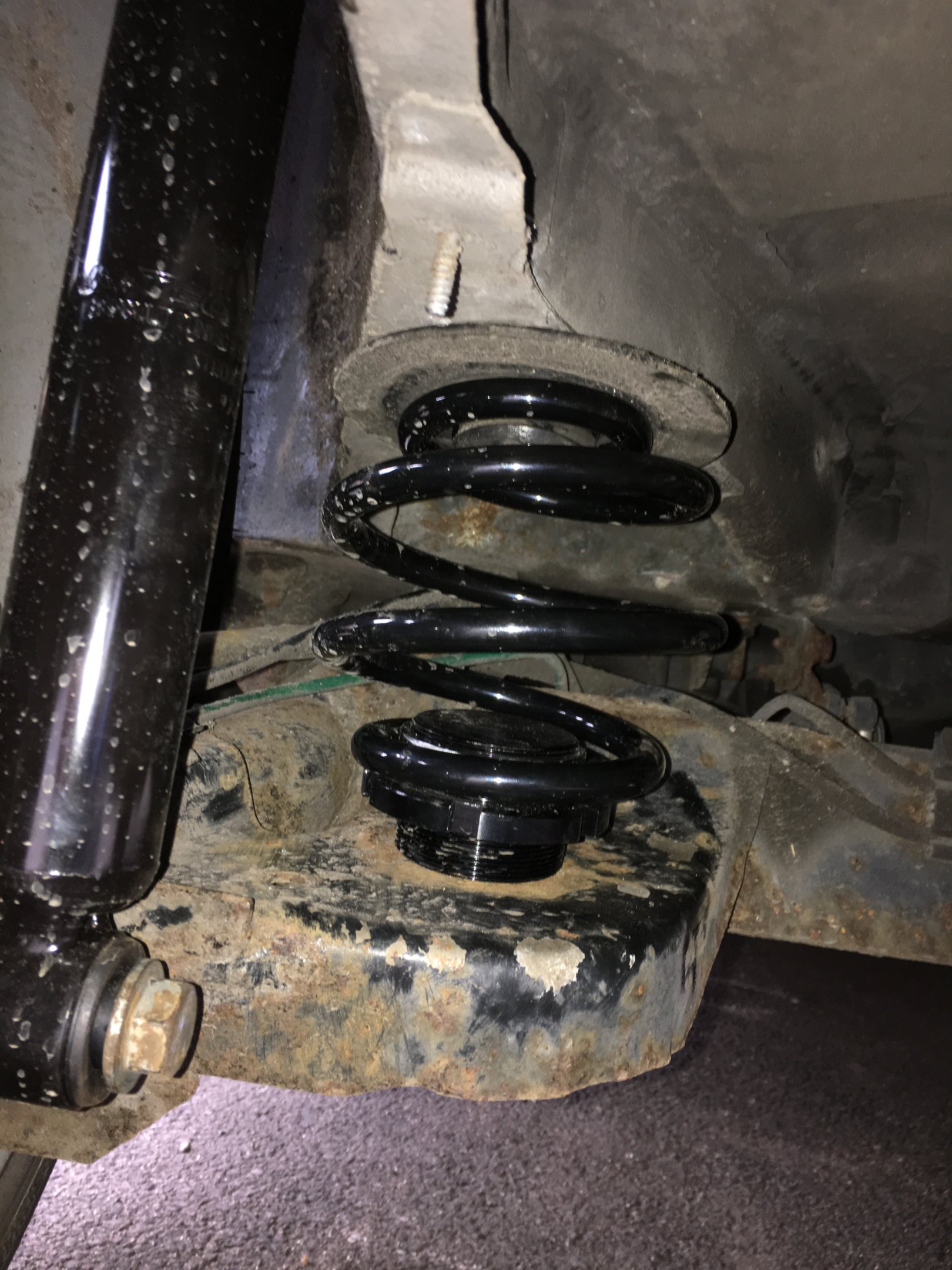

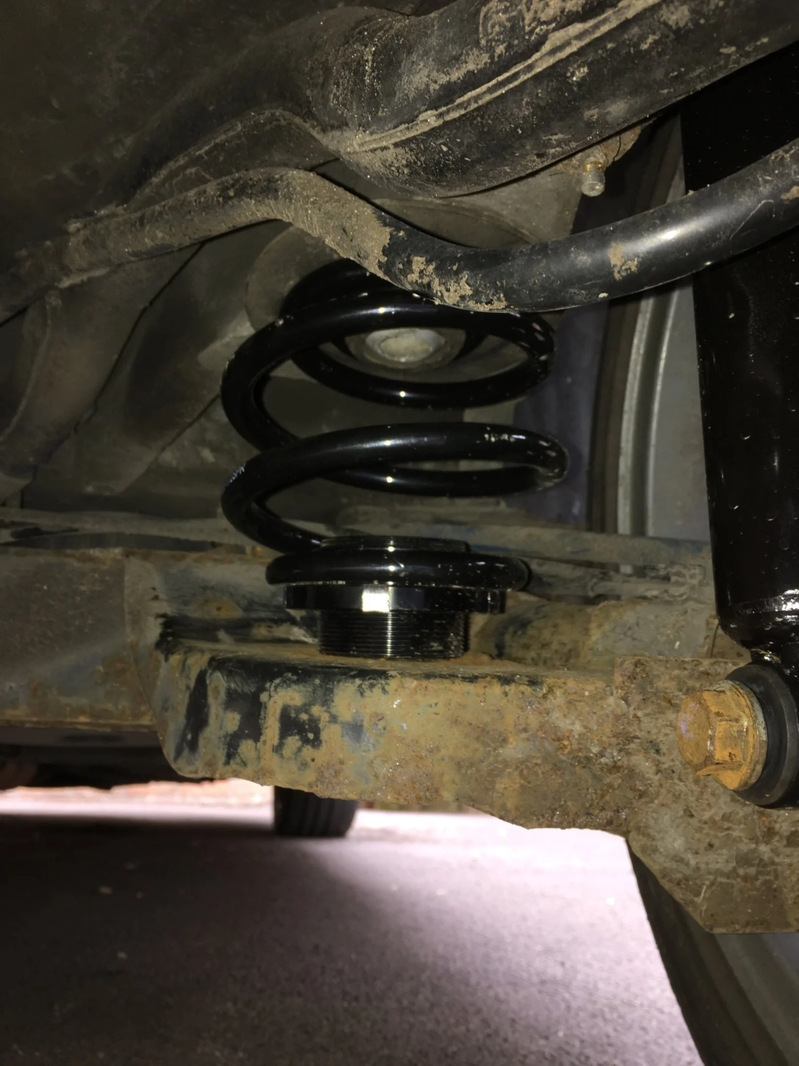

One last bit. Do the rears sit like this? The bottom OEM rubber doesn’t fit the adjustment seat top nor the bottom of that where it meets the beam. A large washer then the bolt is on the underside to secure it directly to the beam (metal the metal?)
  2005 Silver 182
Right it’s all done. Tightened up and drives properly! Thanks again for all the advice and help! Top job
