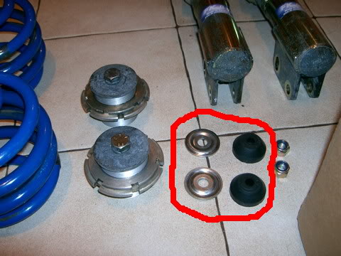

Here is a pic he posted when fitting them in the past:-
The parts in the red circle are the ones I think are missing.

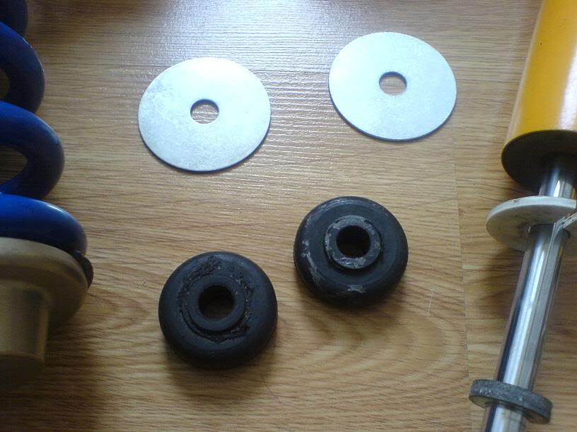

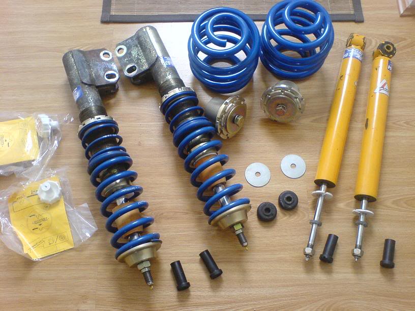

Here is what I got:- [Is everything there???? If so where do the loose parts go???

i *think* you need 2 more rubber mounts and washers. The bits in the last pic are for the rear shockers, you need a rubber mount and washer (wheel arch side) and the same in the boot.... they sandwhich between the car body. these are the bits under the rubber caps in your boot. Hard to explain
i think you do need the bits in the top pic you've circled, as thats what i've tried to explain how they work, and where they go
so imo you need 4 rubber mounts and 4 washers. My h&r's are different and use the reno mounts, but these look like the rear gaz set up

cant I just take the rubber mounts and the washers off the std suspension that I will be taking off? See the top of the 2 x middle dampers in this pic:-
those are the new washers K-Tec sent me with the coilovers - as you said you just use the rubber bumpstop and top cap of the O.E shocks and then the other rubber gromit goes the other side and the washer on top - I know you have said the washer does not fit but I did not try them - that is how they came back from FK - I only opened to take a photo.
I will speak to K_Tec and get the correct washers sent out tomorrow and apologise for any inconvenience. All parts are definately there for the front shocks. Definately only 2 washers needed if they dont fit. Ill ask about the correct rubber mounts as well but as I siad the ones you have work perfectly - they are the same as the Renault ones.
Cheers Tim... The washers are huge in comparison - and the hole does not even get close to fitting over the piston.
