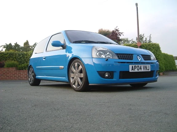

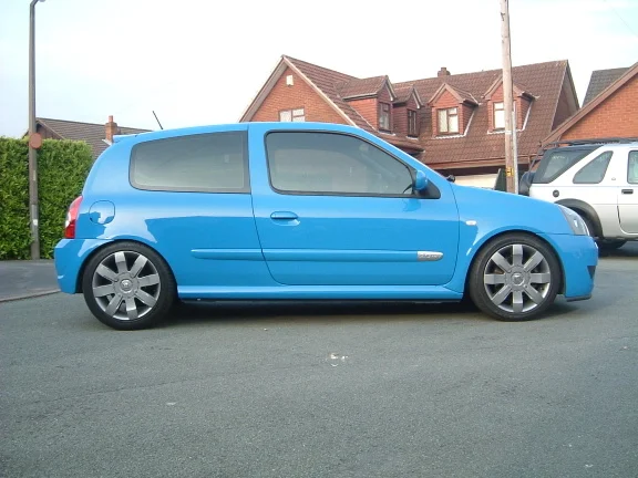

Coilovers are the best for handling.
H & R's :)
thanks for the pick mate how much are they bud and how much do they lower the car by cheers again looks awesome
  K20 EG Hatch
I think they are about £800 but not sure now, they may have dropped or gone up.
The rears are as far down as they can go but the fronts can go down a fair bit more! But you wouldn't want to imo.
