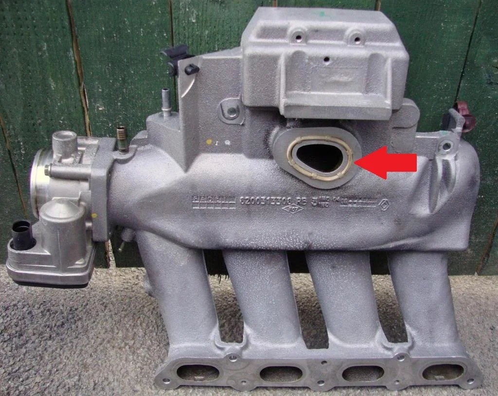

Think you mean you've broken the breather pipe? Yea for it to rev up you must have an air leak after the throttle body. Plenum - inlet gasket ok?
Yep reckon it must be the plenum gasket, must have come off when i took it off -- its no where to be seen though???!!?! I've checked all down the back of the engine but i can't see it anywhere.
How much for a new gasket? DO i have to order from Renault?
Pic below, doesn't seem to be a seal on mine here i can only assume it has come off.

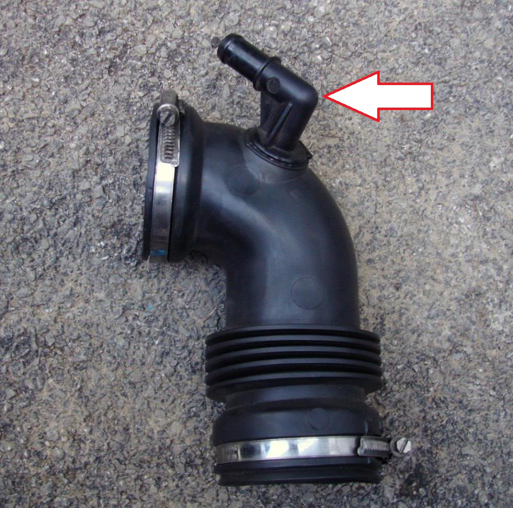

This is the pic of the bit i have broken - this would cause a leak but surely not to cause the high revs that i have mentioned?
Thanks for the replies :-)
The snapped off breather wont really cause any short term problems. Can get gasket sets off ebay but a renault one should be cheap enough.
Edit: just realised u mean the oval rubber seal under the inlet?? Use some silicone for a short term fix.
