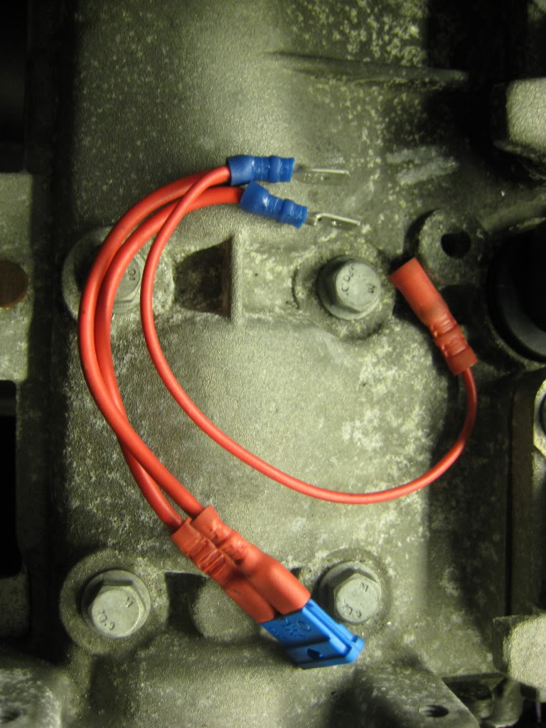

Where does this go?
remove a fuse (think it's the 5amp one) and check for a switched live. fit this lumper where the fuse WAS, the spur off does to the switched live wire for the ECU.

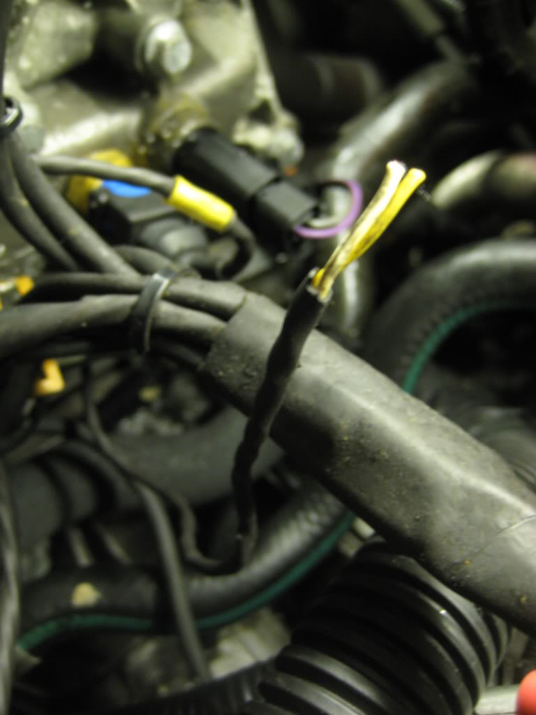

Does is need soldering to these?
IMG]http://i466.photobucket.com/albums/rr24/chrispy_clio/IMG_3591.jpg[/IMG]
[Crank sensor, white to white, yellow to beige/yellow, feeds the std ecu to make your rev counter work

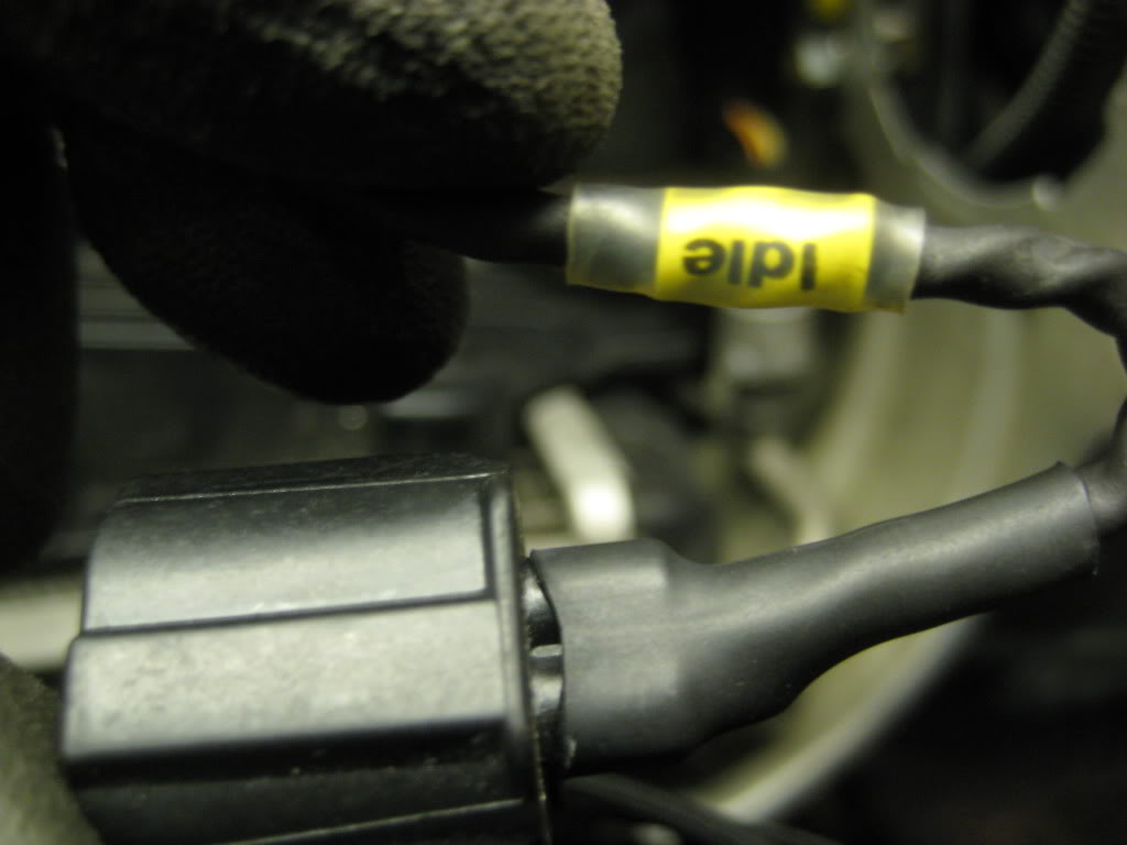

Where does this go? I assume its somthing to do with the idle but cant see where it could go
unused, it's for stock inlet with an idle motor

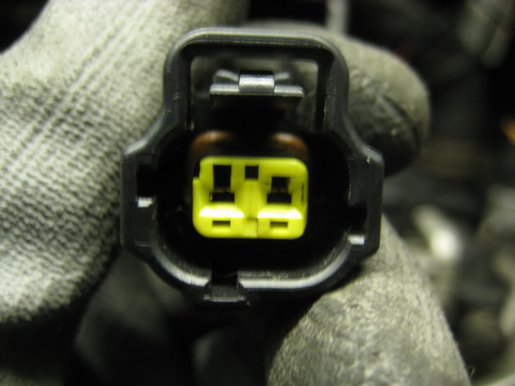

Whats this sensor for? Do i need to keep the standard part of the loom in there?
unused, that's the standard knock sensor

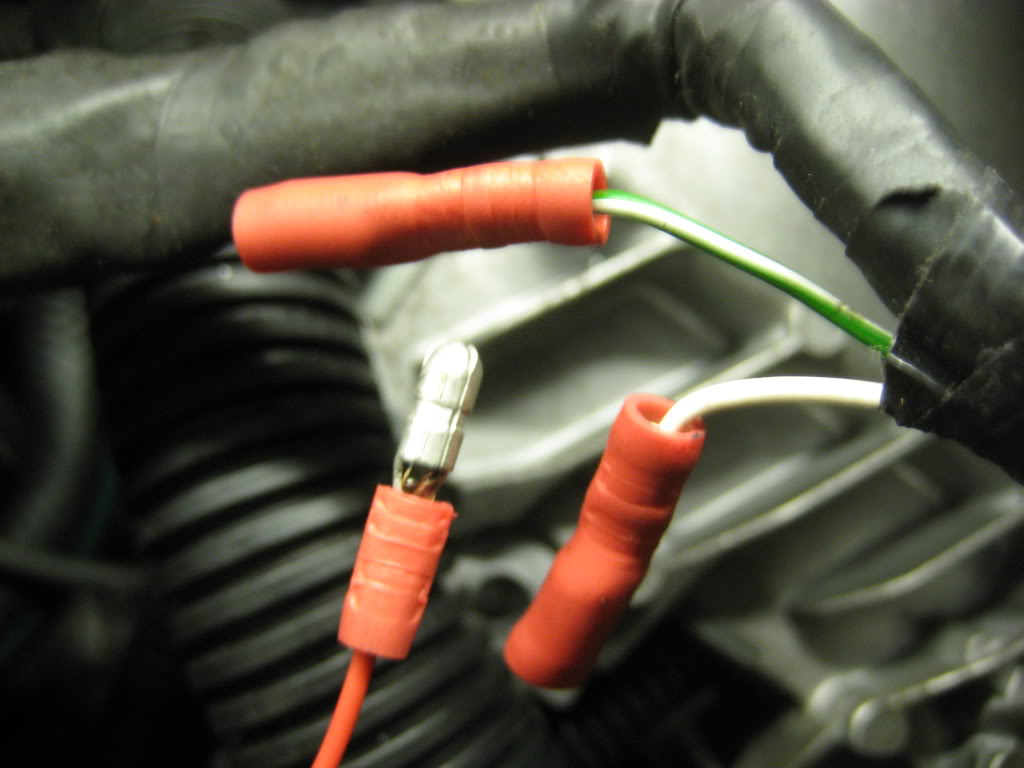

These are coming out of the ECU loom plug. Do i need to plug the red line into the Green/white line or the White line?
not sure what's going on with that
