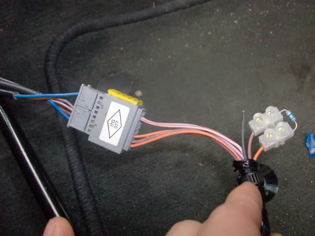

DAOES ANYONE LIVE IN SHEFFIELD WHO HAS CHANGED THERE SEATS I HAVE JUST PUT A FULL SET OF 172 FULL LEATHER SEAT IN MY DCI NOW HAVE THE SERVICE LIGHT ON AND AIR BAG LIGHT ON ALL THE TIME I HAVE GOT SOME RESISTORS FROM MAPLINS JUST IN CASE .ITS DONE MY HEAD IN TODAY SO IS ANYONE FREE TO GIVE ME AN HAND SATURDAY IF YOU HAVE DONE THIS ON YOUR CAR ANY HELP WANTED ASAP THANKS ..I AM IN S20 AREA THANKS GOSSYGSXR.............
Have you tried disconnecting and reconnecting the connectors under the seats? Some people recommend soldering the wires.
Need a resistor for the seats, if the connectors are broken.
Resistor is from Maplins cod M3R3.
I took all my connectors off and just soldered each wire to the correct wire it's meant to join, works a dream and no airbag lights at all!
