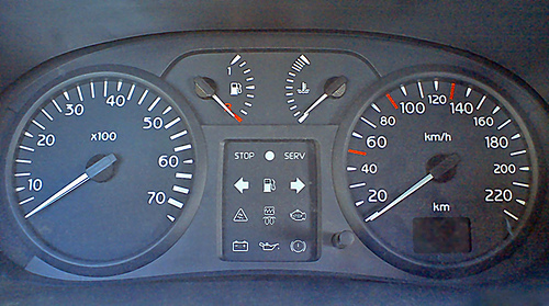

Once replaced when driving a light came on, on the dash (The one underneath the petrol light)
I pulled over, turned the car on and off and it went, but the engine management light came on in it's place.
