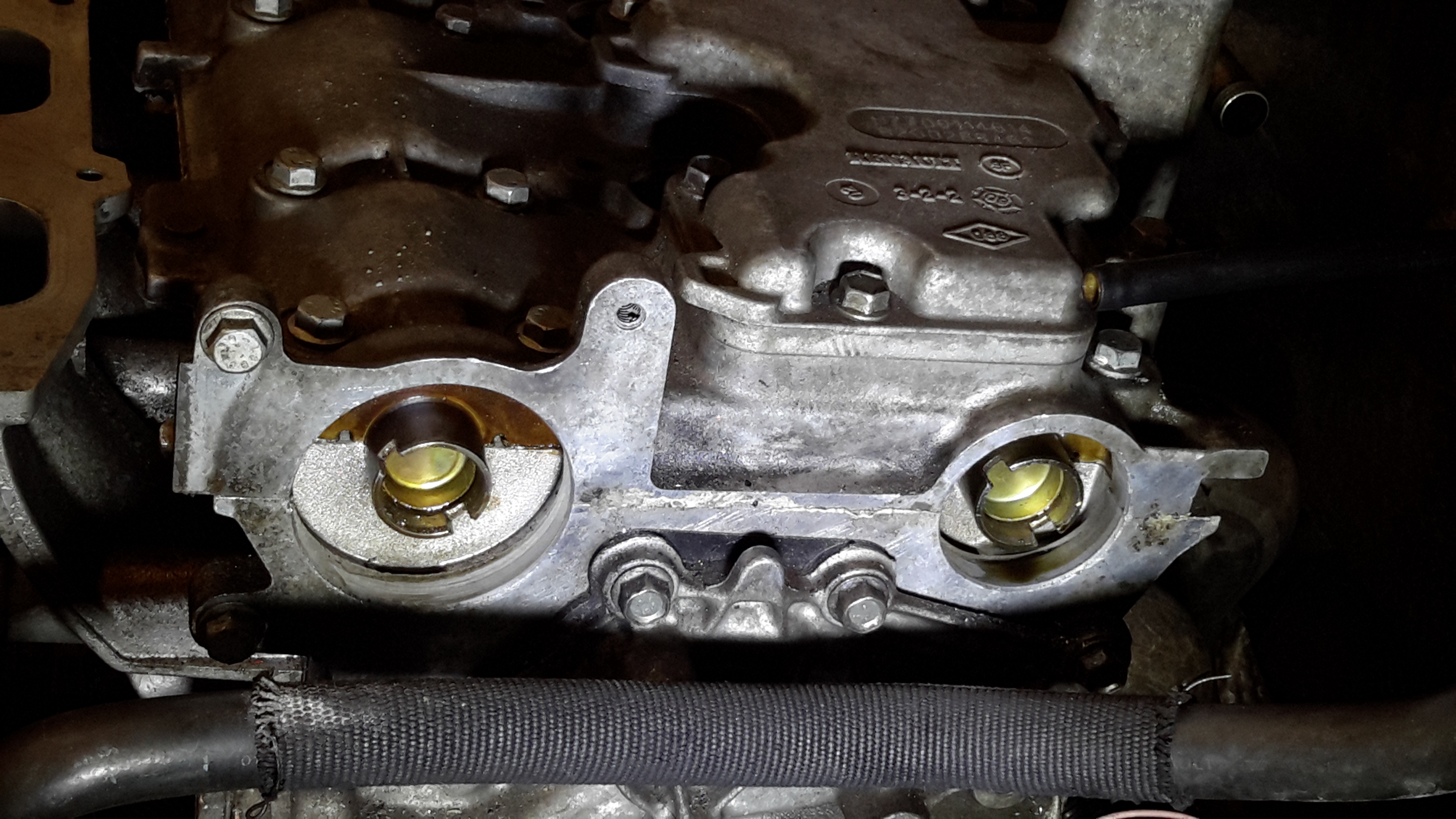

Right can anyone tell me if they see an issue with the position of these cams......not ideal pic but havent had time to get car jacked up and find tdc but any help from what yous can see would be appreciated
  2002 clio 172
No its not yet. Havent had time to get it to tdc car just wheeled into garage then end caps off car has sat in my drive for months.
