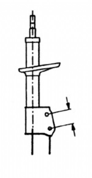

Could someone describe exactly what im measuring please so I buy the right car? what exactly is the hub bolt spacing (pictures would be even better!) :-)

Nope, it´s the distance between the bolts that fix the front shocks to the hubs. Try to measure it with wheels on full lock.
Distance between the two holes where the shock absorber mounts to the hub.
