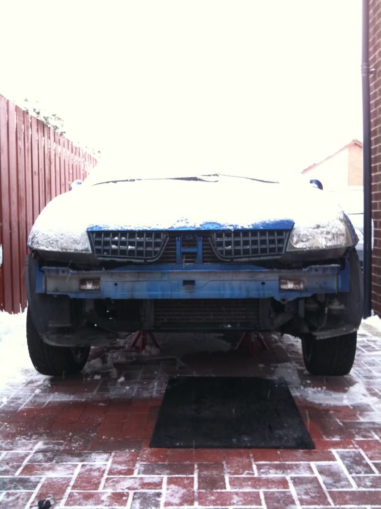

ok managed to get the bumper off so it's looking like this the now...
i tried to get into the bonnet catch but it's set quite far back and the grill is in the way so can't see a way of getting to it unfortunately

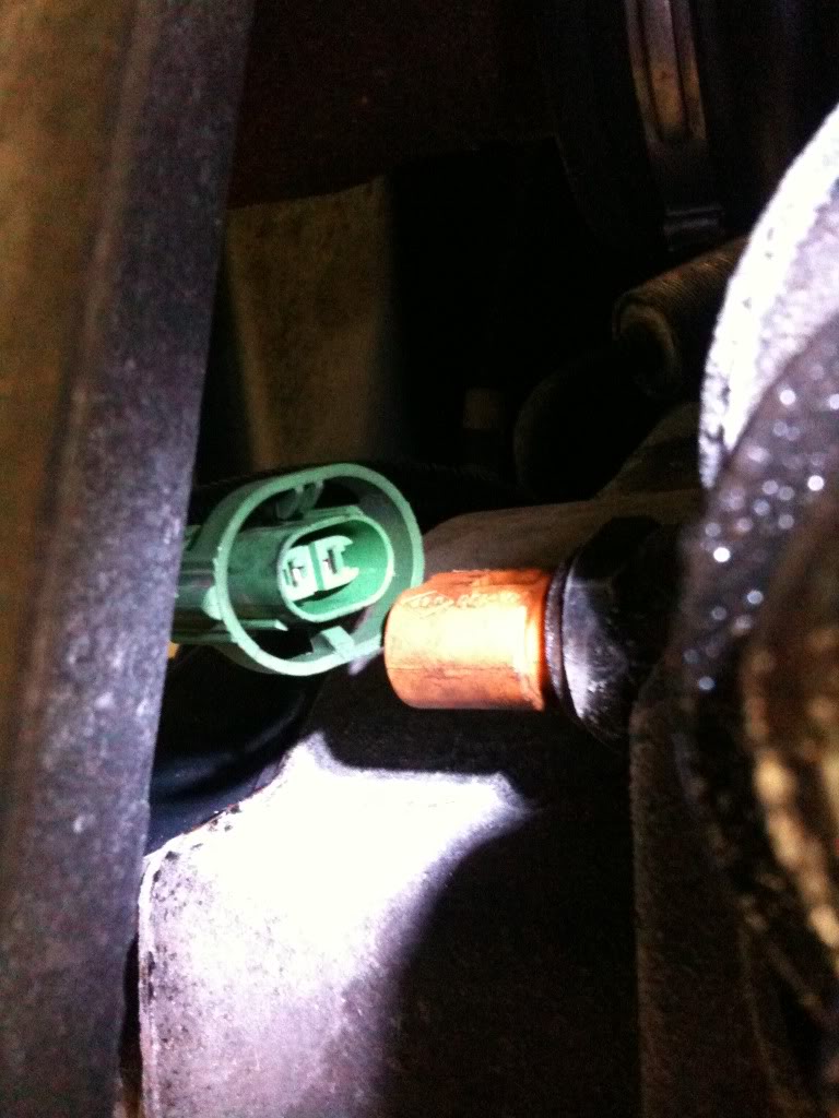

i managed to find the reverse switch aswell but with electrics not being my thing at all i'm not sure where to put power to, with it being a switch am i right in saying that both connections would be positive so it wouldn't do any harm in trying to put power to either of them ? Pic below of the switch
i can see a small bit of the altenator through the front but i don't have a clue where the positive is on it so don't have a clue where i could put power to it, anyone got a pic or know where the positive is on it ?

well i managed to get power to the reverse switch earlier and yes it does turn the ignition on (aswell as the alarm) only problem is that it still wouldn't unlock with the key fob !!!

I could be wrong here ( never tried it ) but the fob's dont normally work with the ignition on.
You would need a long rod through the door gap and press the unlock button on the center console while it's being back powered from the reverse switch.
