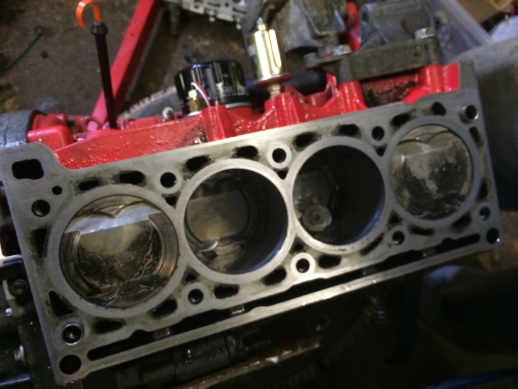

Is it just the angle of the light, or is there a chamfer (sloped edge) at the top of bores 2 and 3?
Also looks like there are very indents on the face of the block.
I would be livid about that, who built the engine for you?!
It doesn't help now, but... You should have taken it to a reputable specialist in the first place, Engine Dynamics or @Michael Woodford MST are local to you
I'd take the whole thing to them and see what's salvageable, rather than fixing what you think is OK and having something else fail!

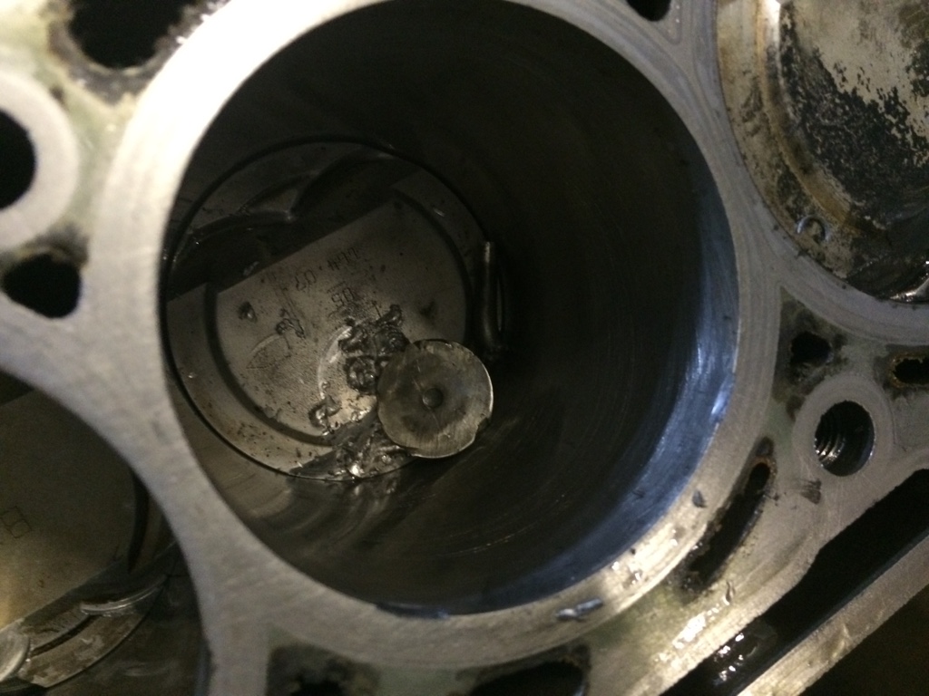

Vvt or non vvt 422's? If it's vvt 422's then you need to keep in mind that the dephaser pulley advances the timing by around 16 degrees at around 1200rpm. You can measure as much as you like, but if you don't take that into consideration your fucked all roads round tbh.
I'm amazed that you couldn't hear the pistons doing the skinhead moonstomp on the valves as well tbh. Takes more than just a couple of taps to knock valve heads off!! Even standard valves usually just bend if it's not doing silly rpm.

Then cut out n no more starting as it was stuck on valve at tdc
Clearances also change when you get heat and high rpms involved as I found when I was learning on my fiestas CVH a few years ok. Clipped a valve when I was going for it that measured what I thought was ok when I was building it.
Yup 100% it engaged the dephaser and started knocking the valves.

Anyone timing that up to renault specs would have the same problem the cut outs in the pistons as std aren’t big enough for the lift of 422 cam unless you deepen the pockets.
