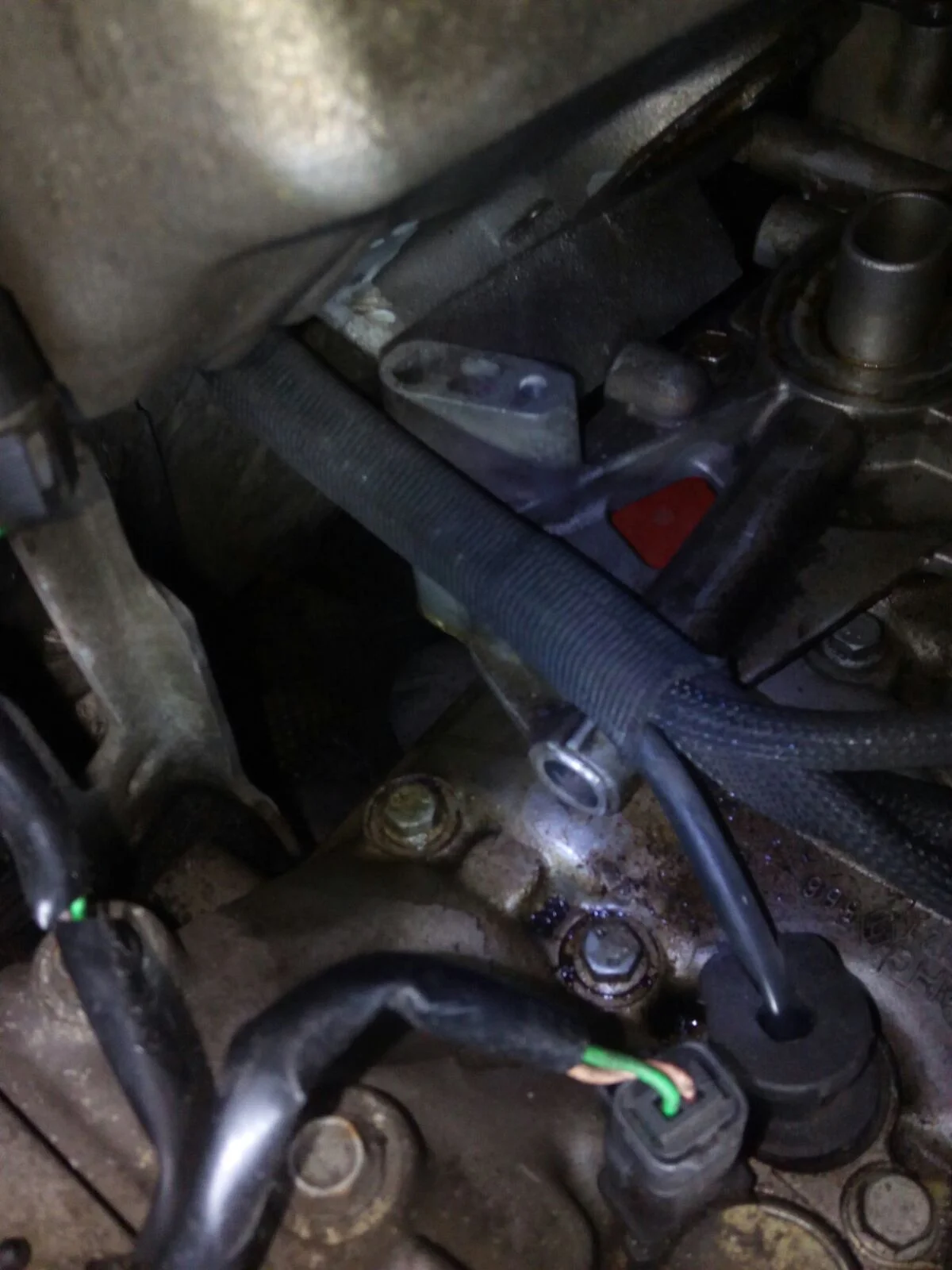

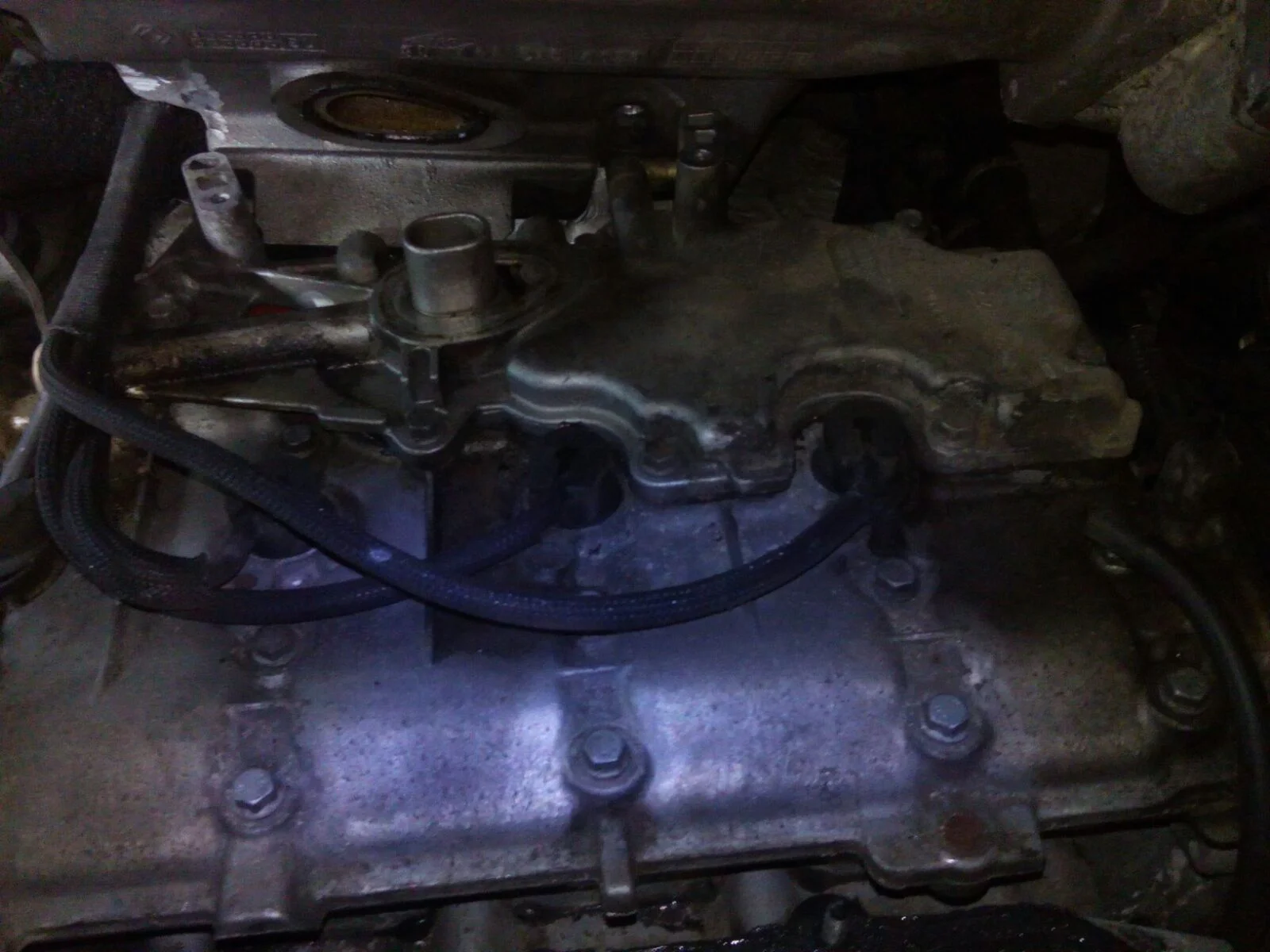

I've had an air leak which has caused the car to rev at about 6k constantly, I've took the manifold off to find this pipe with nothing on the end..... any suggestions what should be there?

Yep normally a hose to the canister.
Plenty of people remove the carbon canister so just cover the hole and you should be fine.
