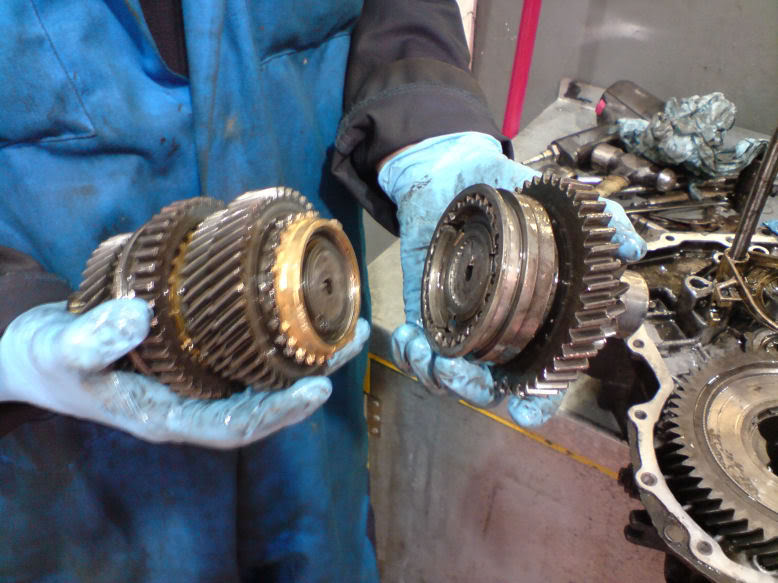

on the way home from the g/f's this morning it was hail stoning, pulling away from the lights i wheel spun, not on purpose!
changed to second gear, then third and nothing, i only have first and second, not even reverse
whats the damage?!

they are taking the end casing off for me today to check if 5th has popped off
  Skoda Fabia vRS
5th has not come away, nothing obvious at fault, something must be wrong inside the box so its gonna have to come out

I couldn't 100% remember but seemed to think I swear thats supposed to be 1 piece! New box time? Or is it repairable? Whats broken?
  Skoda Fabia vRS
well the shaft they are on is £200, so considering other box parts could easily reach another £200-£300 ive ordered a refurb box
