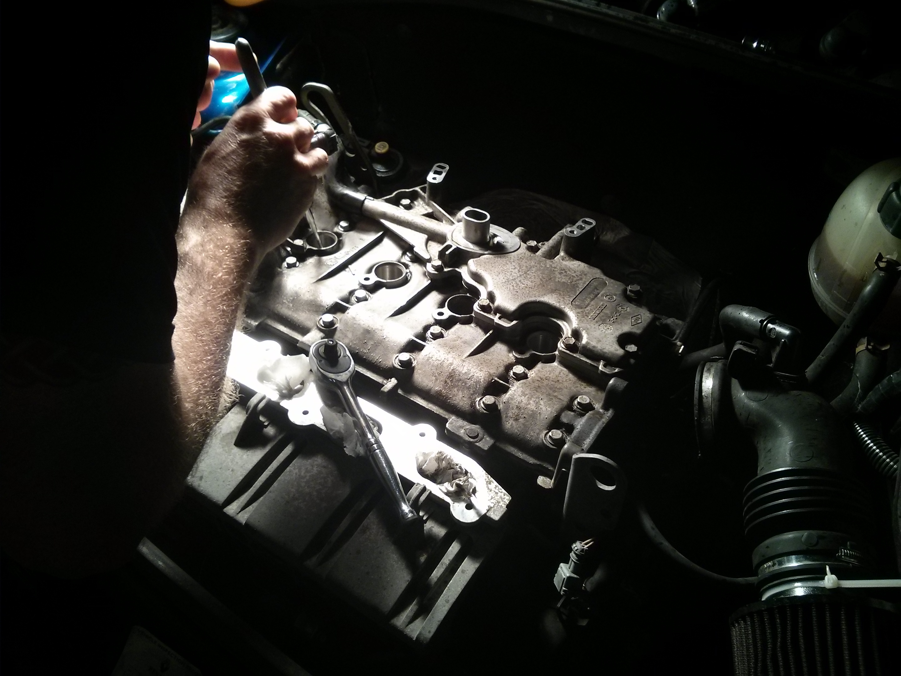

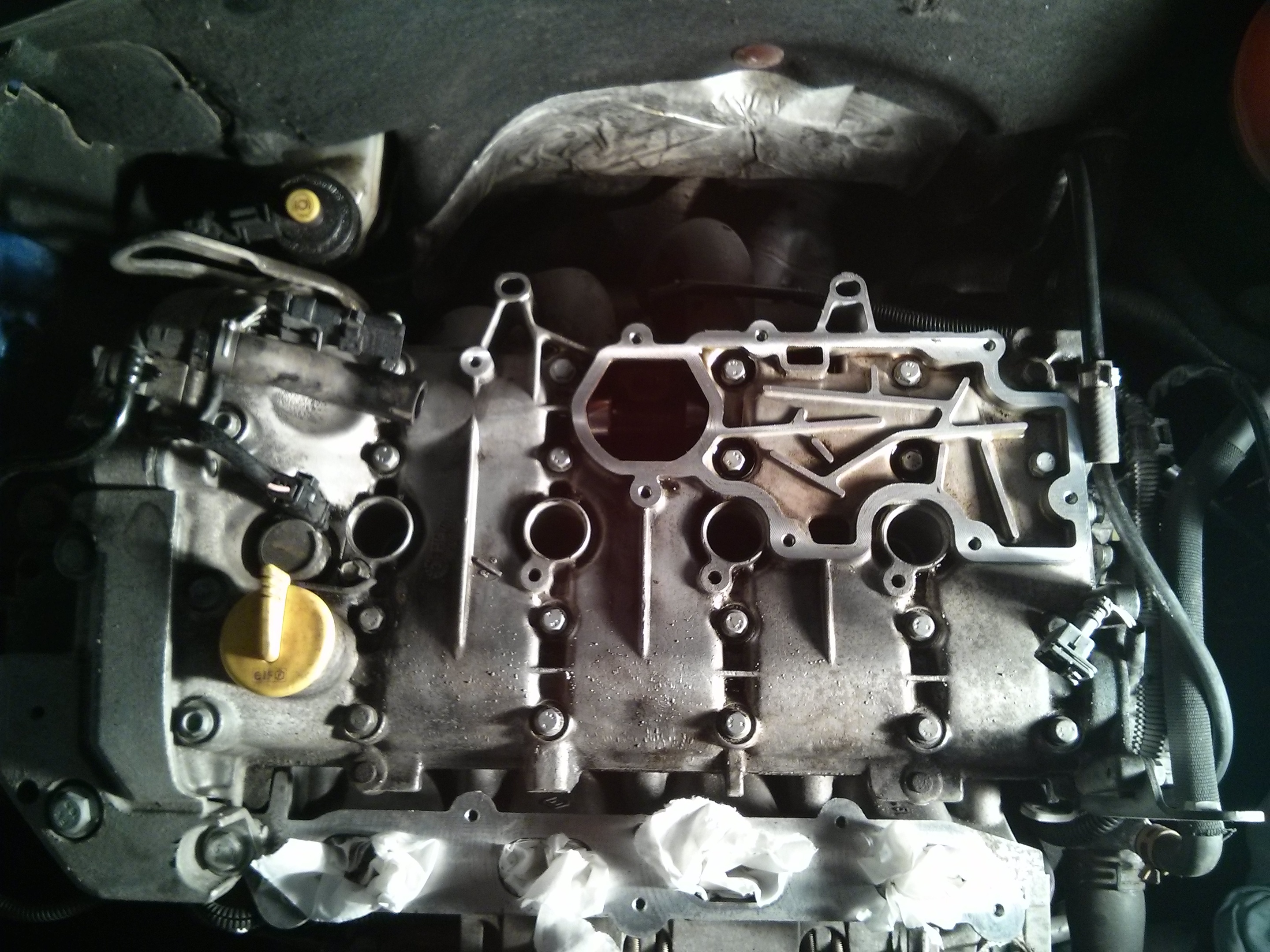

The labyrinth gasket leaked on mine causing the spark plug tubes to fill with oil. This destroyed the HT leads casing a horrible misfire. CHeck that there isnt any oil seeping through the labyrinth box under the intake plenum.
What's a labyrinth box?
It's the box above the right two spark plug tubes. See the below picture of mine after I'd cleaned the oil away.
This is what the labyrinth looks like with the cover off.
