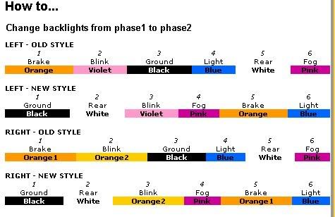

Can anyone else tell me how to propperly wire rear mk2 phase2 lights to a phase1 mk2???

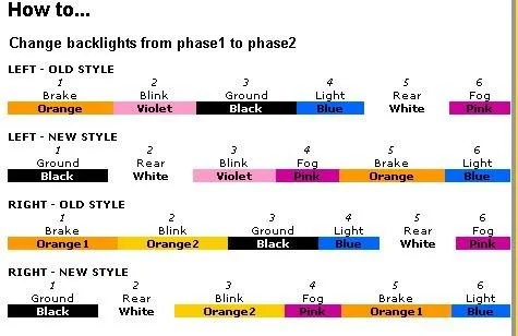

Heres the wiring diagram mate
