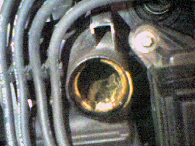

Final part to the long post.... I took the filler cap of and there is mayo looking substance around the top, ive heard this can mean the head gasket is on its way out? or is it likely to just be because the engine has been misfiring?

Edit - See attached pic of filler cap

mayo in the filler cap is quite normal for the 1.2.

no misfire this morning but light was still on, called the aa out who plugged their clip in and cleared the fault for me :)
