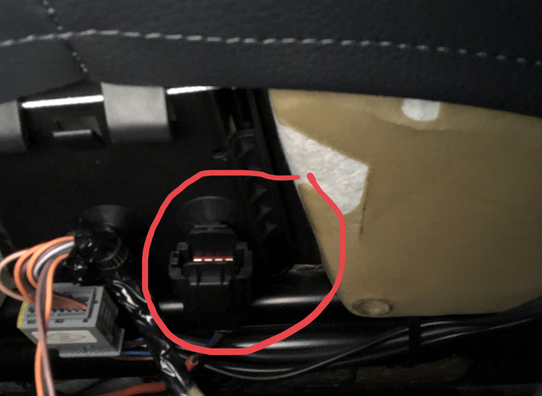

Recently changed my Cup seats to the 182 leather seats with airbags in the side and had the below lights on the dash.
Service
Airbag
ABS
ESP
Changed the OEM steering to an OMP and have used 3.9ohm resistors in the airbag connections. This has cleared the airbag light but I still have the Service, ABS & ESP lights on.
Any help would be greatly appreciated or can anyone advise on the correct plug in resistors for under the seats?

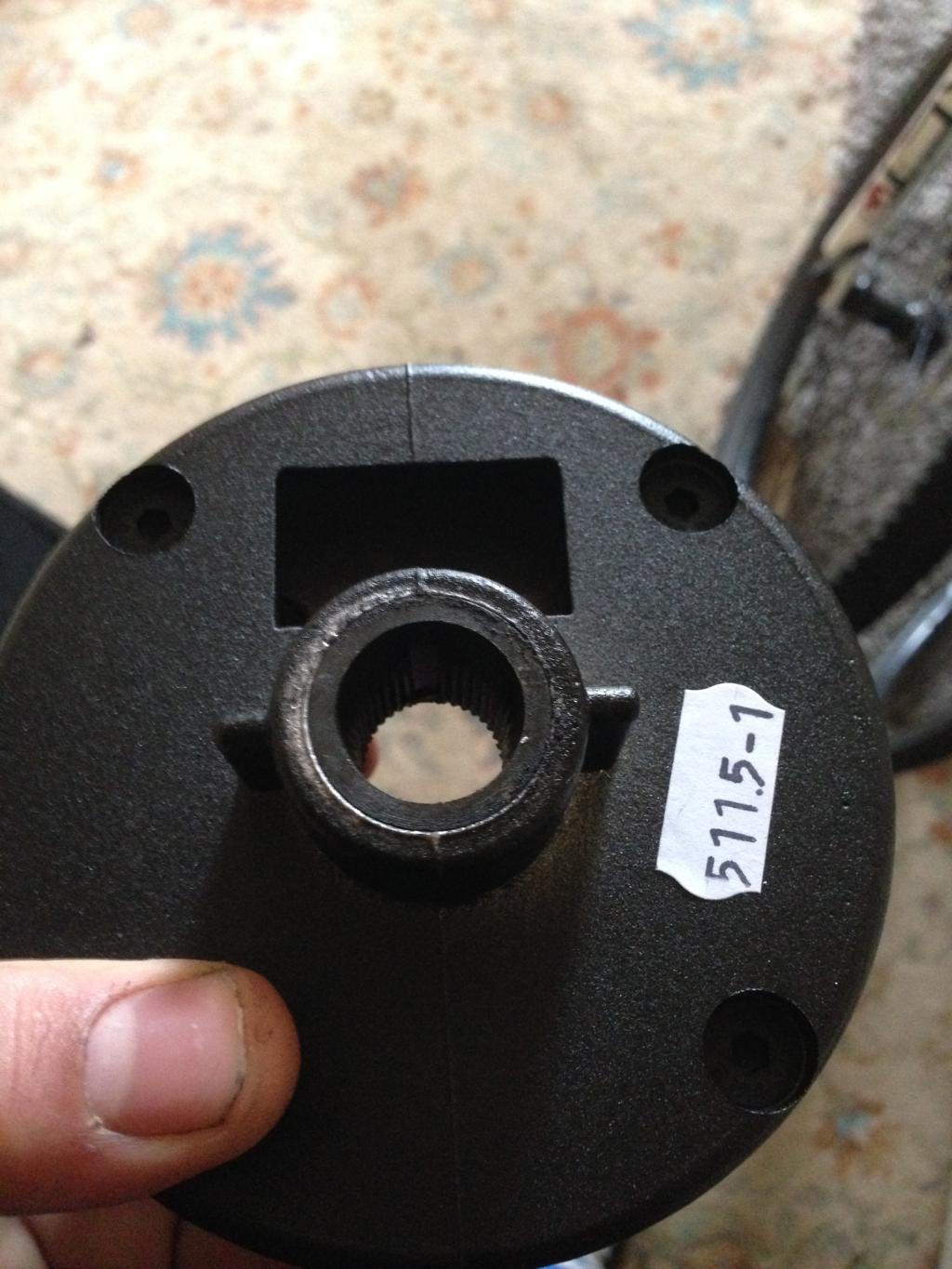

Do you have the correct boss for esp squib ? Some bosses do not have the locator peg fitted which will throw the angle sensor miles off.
As far as I know. It’s the OMP one to match the wheel.
As Brigsy said then, does your steering boss have the tabs that locate into the squib.
OMP ones don't tend to have them. The Momo ones do.
I’ll have a look bud. Maybe the issue then. Cheers.
Any links to the Momo boss?
You could possibly add a small bolt/self tapper to the boss to create the tabs if you dont want to buy another boss.
