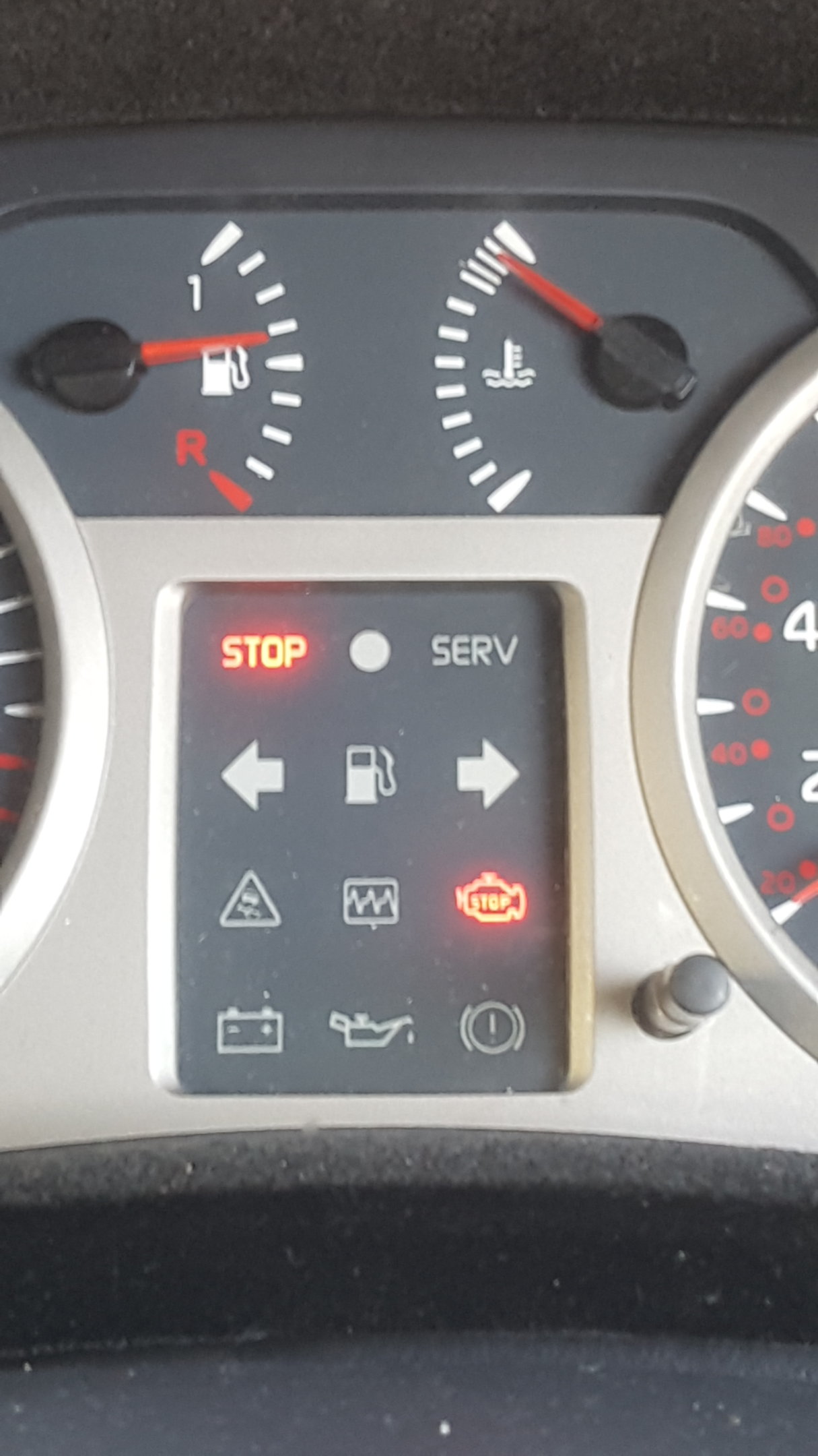

HELP, water temp right up and 2 dash lights
My cars been sat for a few months, took it for a very short drive and now Ive got 2 dash lights on and its overheating.
Any ideas of the cause?

or the waterpump.
but as others have said, get out and feel what the temperature of various parts are.
Also - do/did the blowers produce any heat?
it's not necessarily boiling hot, it just jumps up and throws lights on so you don't ignore it.
checked the water?
As in the level? Yeah looks ok
Does the actual temp of the coolant represent the temp gauge, is it boiling away in the header? And is it recirculating?
I need to start the car up again and see if its actually overheating, or if it just THINKS it is :smirk:
I'd think it could be either the thermostat or the coolant temperature sensor.
Which would you advise changing first? Or is it worth doing both?
Also, if Im changing the thermostat, are these worth buying? Seems a similar price to OEM

or the waterpump.
I guess if it was the waterpump it would heat up really quickly from cold? It wasn't doing this, took a typical amount of time to get up to temp, was only after I finished the 10 min drive that I noticed the gauge. The heaters were giving out heat yes
Ah right I see!
