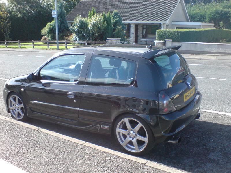

  "Navy" N17 TWO
Got a quick snap in he sun after a shower of rain
You can see the water clinging to the sides - when the sun dries it in it marks the finish - don't like that :dapprove:
How can I keep the finish looking mint? :)
