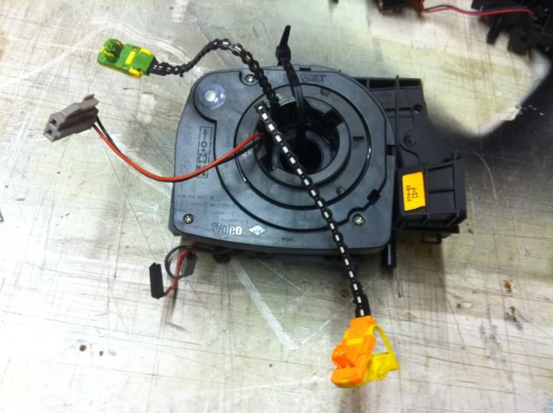

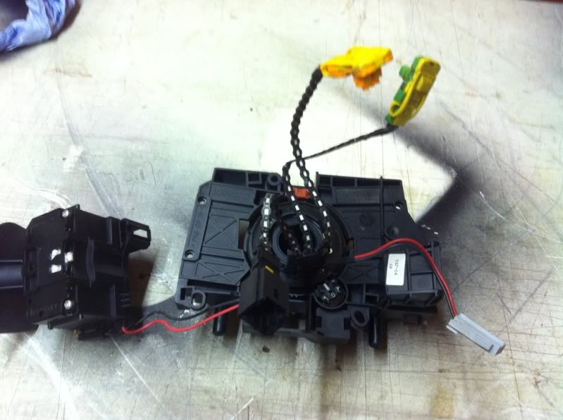

*HELP* What does a 182 cruise control wiring Squib look like ? Is it one of these ?
Can someone tell me which one of these wiring Squibs is for a 182 with Cruise Control ?
Am I right I thinking it's the one in the second picture ?
Cheers
Richard
Re: *HELP* What does a 182 cruise control wiring Squib look like ? Is it one of these
there the same top one has the added angle sensor for esp on top of it that just pops off
So on the top picture where does the the plug for my cruise control buttons plug into ??
Bottom picture is the CC one mate, however they're both missing the steering angle sensor. Make sure whoever removes it removes it from the car with the wheels straight and get them to cable tie it in position so it doesn't move, otherwise you need to plug it into clip.
There is a big black block connector for the CC.

Cheers mate, I thought it was the bottom one.
