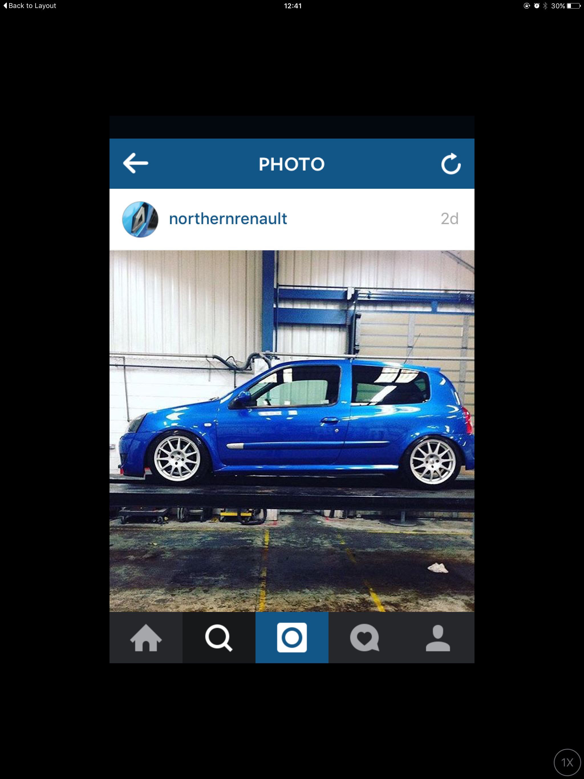

It seems thats the comprimise, i really know f**k all on how this set up work but im sure its set for track but i done plan to ise it that way incase i bin it. Rather take her up santa pod, much safer.
Like this
  172 cup
I had it lower with softer springs on the back, I kept playing with it and raising it up because it drove s**t. How you bought it was as good as I could get it between being low and handling good. The biggest problem was that to keep the front the front lower or at least level with the back the front anti roll bar would hit the subframe and I think that was what caused handling to be s**t. I'd say either leave it as it was or buy bigger wheels or see about getting the kit someone sells on here, ball joints and track rods with extenders. That will drop the bottom arm and anti roll bar down again away form the subframe.
  cup 172 , Saxo vts
@notfastnotfurious I think it looks lower than it is on that pick if you seen it on Instagram add me mikeprout91. You'll see on other pics it's not as low it's on standard shocks and 30mm springs but it's a cup I believe they sit lower anyway if yours isn't one ?
@mikecup172 yeah i got a cup model, i have 15s so your turinis will sit fuller in there anyway, i seem to be sticking to the ground fairly well still so i wont go any lower now. Think im 50 or 60 down. How does yours handle?
