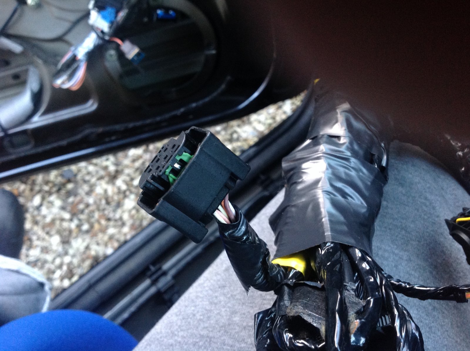

Question 2 - How do you remove both the rear seat belts interim faults (DF252 and 253) I have no wiring in the car and can somebody help me understand the wiring of these, are they to do with this connector under the seat? If not what is it for?

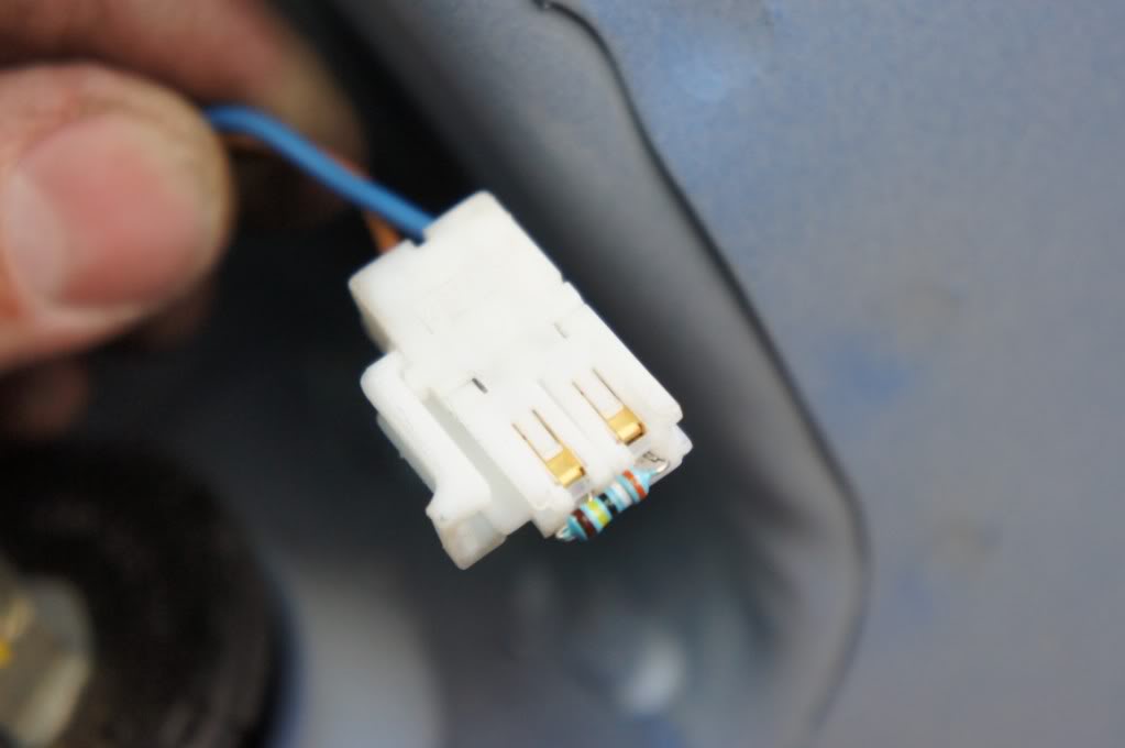

The rear inertia connectors look exactly the same as the speaker connectors from memory, think they have a browny/orangey wire and a blue wire going into a white 2 pin plug, these I 'fooled' using a resistor

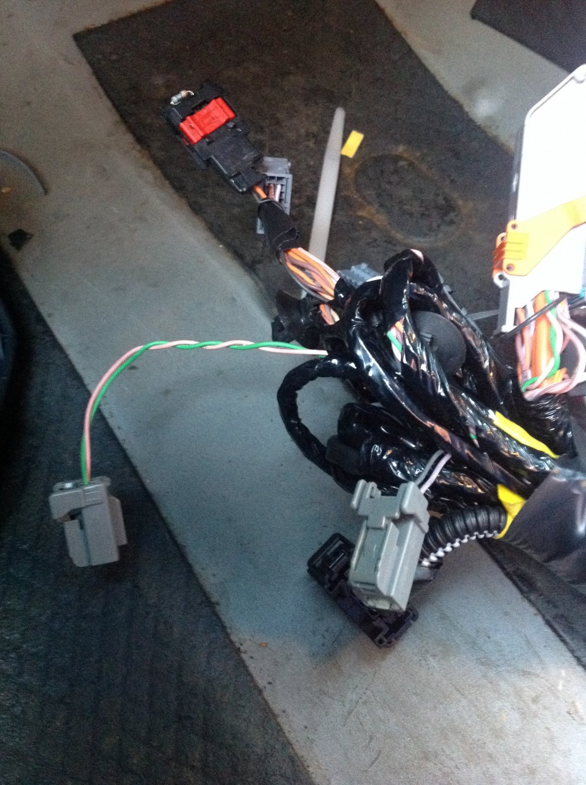

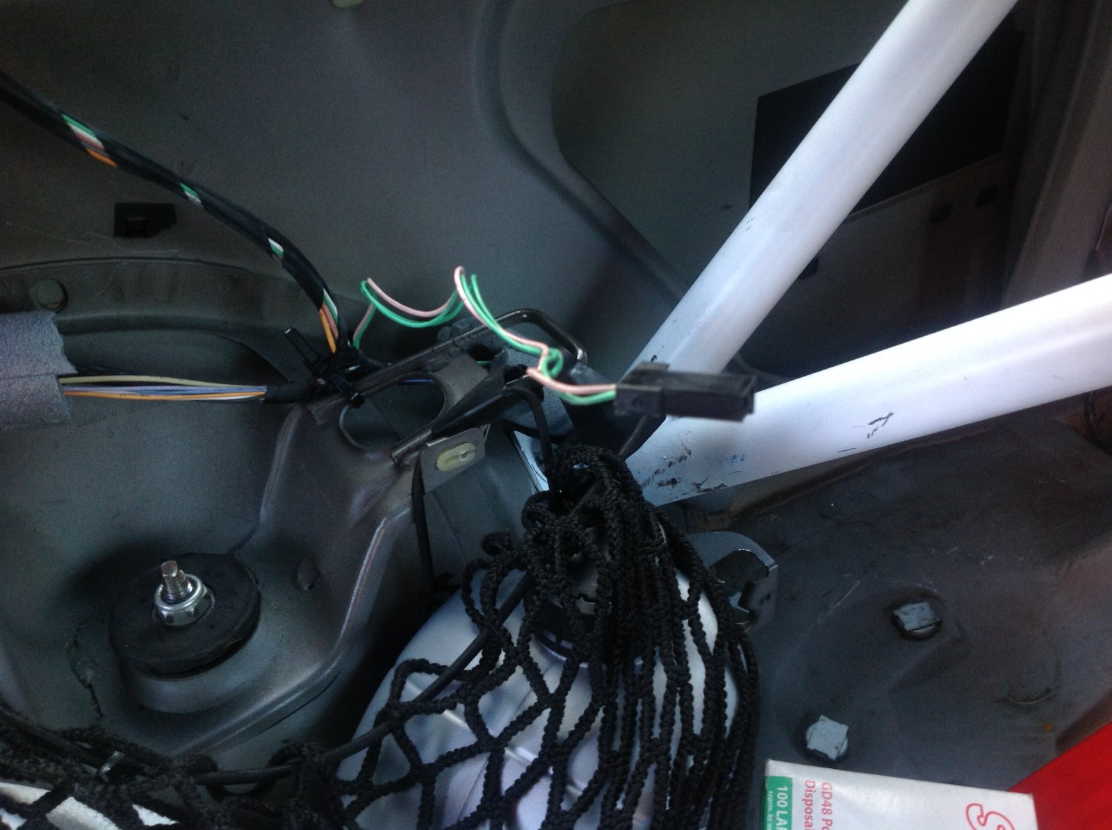

OK thanks, I wil buy the sensors, this is the only wire in the boot, but in think it is the speaker wires? Two green wires and 1 pink wire to a black connector?

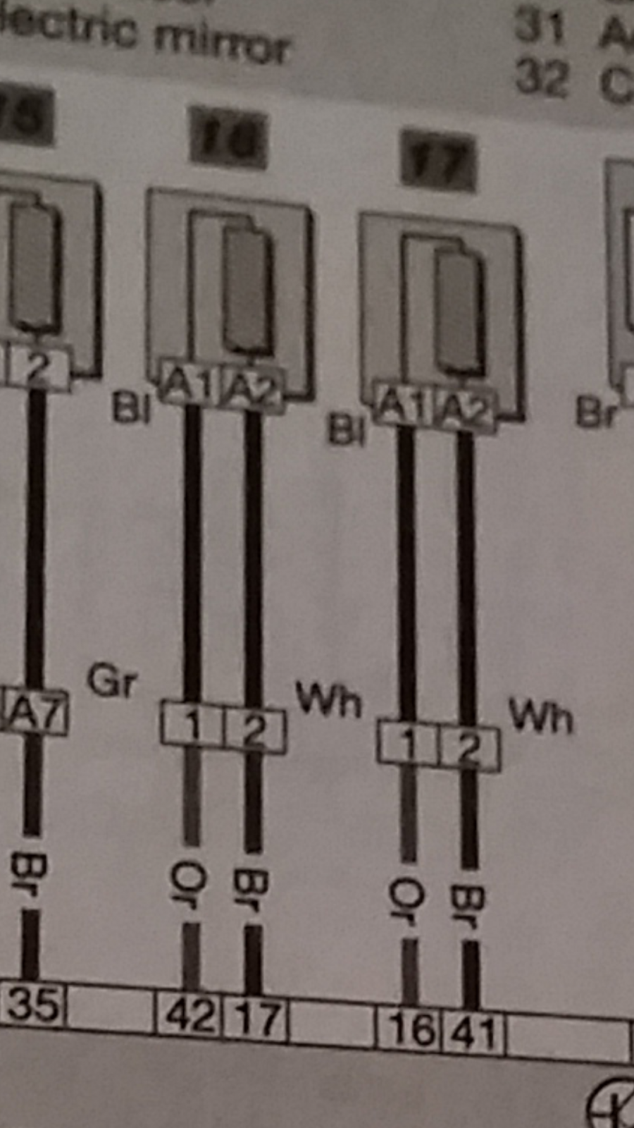

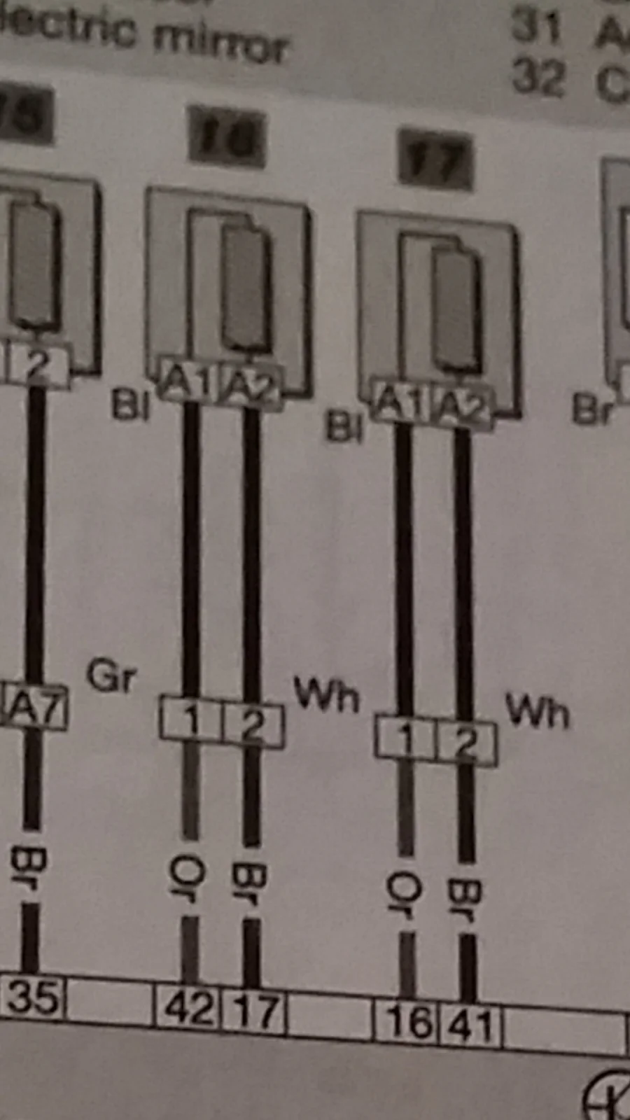

What I need is where do the 2 pin white plugs go? How are they wired into the car? So if you have a picture or can trace the White 2 pin plug back to where they are wired in that would be great! Cheers Simon
This is a picture of the connector I found on the Internet where does it go? How is it wired in? Does it go directly into the wiring loom?
Sorry it's not the best photo no 16 is the LH rear belt and 17 RH, they are wired directly back to the airbag ecu and should be at the pins shown
The black connector with the two green wires and a pink/red is for the boot light as well
Ads, thank for that but I simply can not find the wiring on my car, I have all the airbag ecm wires in a bundle and they only connector that I do not understand is the 6 pin. Do they run from this connectors? But the wiring diagram states I direct connection? I will also take another look in the car.
