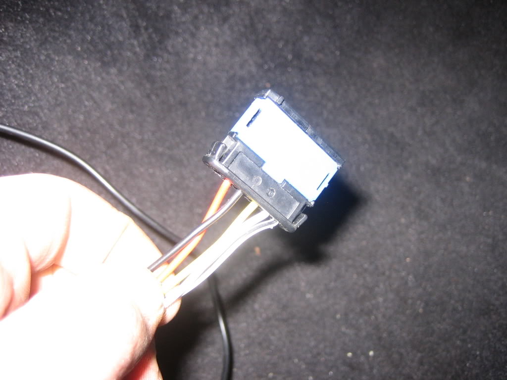

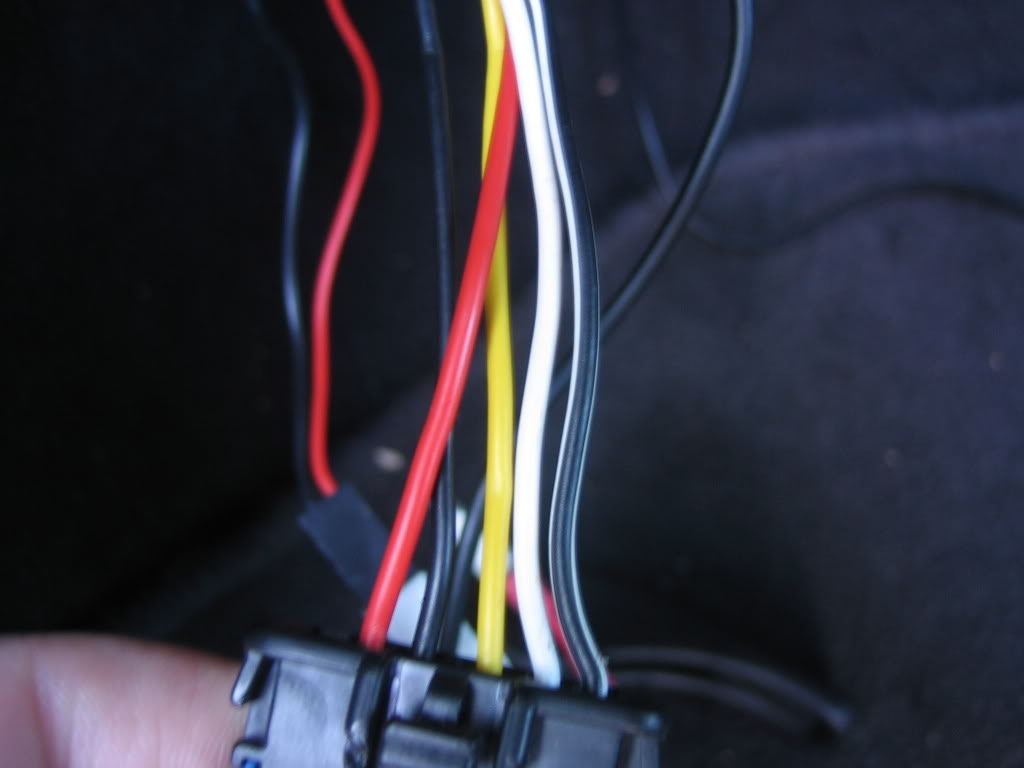

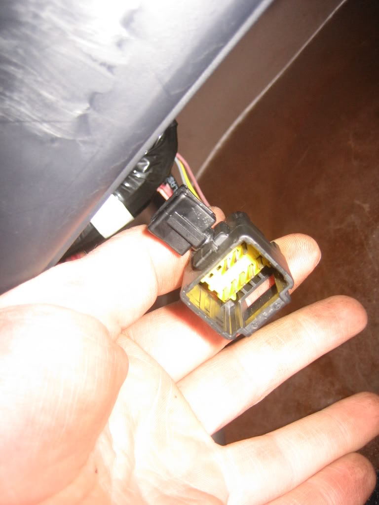

ok. this is my 3rd thread now. i've got the wires into the car behind the glove box but now, where do i plug in the main wire? i've found a spare female conection but it isnt the right size. where is the correct conection i need to plug the main wire into?

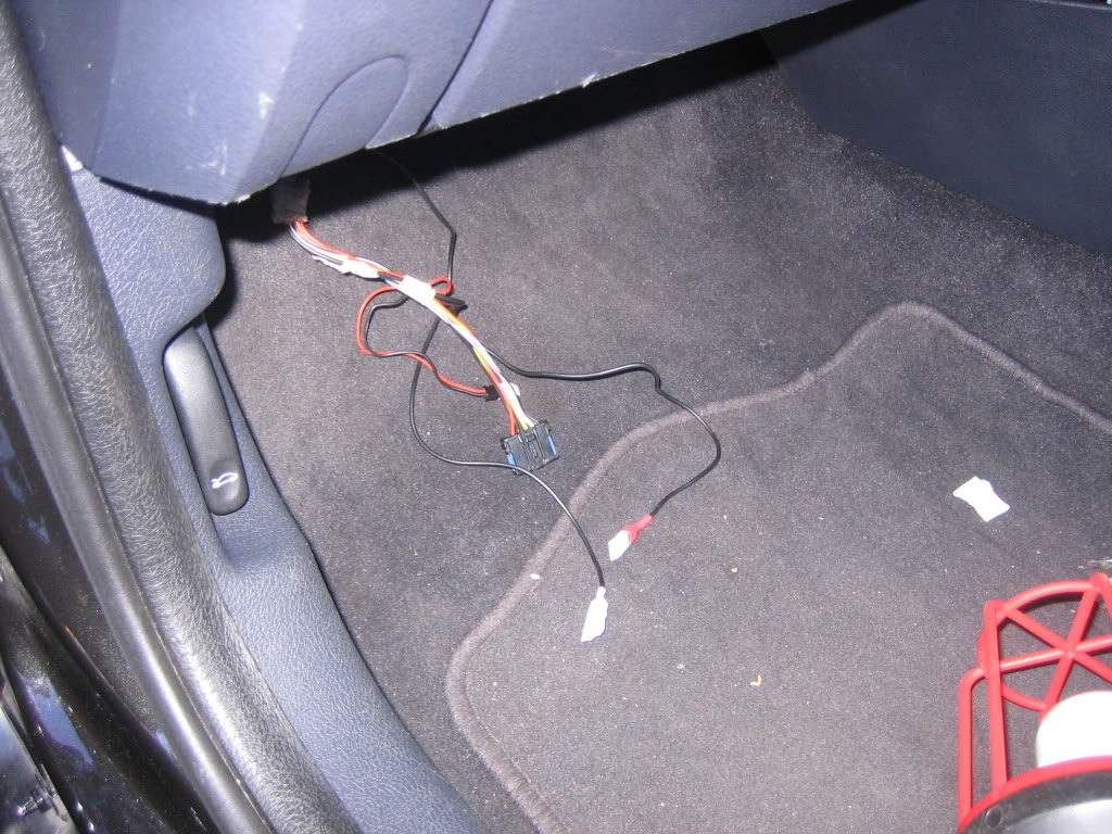

these are the wires for the alarm brought through into the car.
this is the main wire.
this is the female connector i found behind the glove box. totally the wrong size.
please help me!
  BMW M135i
Which alarm? Any instructions with it? Thats the alarm prep connector but obviously its not compatible with whichever one you've got.

Nope that is the correct alarm, however it was also fitted to another model (Espace I think) so I think you have to cut and solder the wires, or it may plug straight into your UCH, which is a black box located between the engine bay and the fusebox, remove the plastic trim on the left hand side of the passenger footwell to access it.

Isn't that female connector for the phone prep? was it clipped to the bottom of the glovebox? think its the wrong one as the male connector is correct.
  Clio 172
yeah mate. it was on a little clip right on the back of the glove box. im glad i've got the male connector right! so do you know where the female one is hiding?? lol, the manual that comes with it makes plugging it in look so easy!!

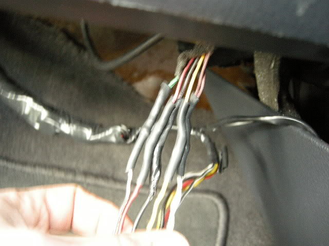

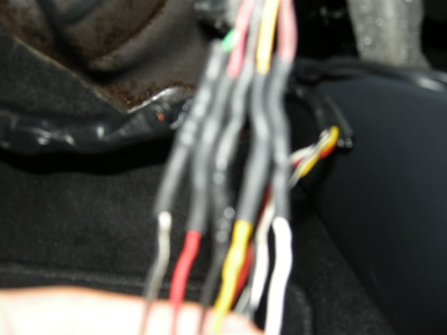

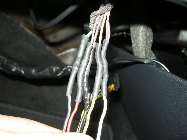

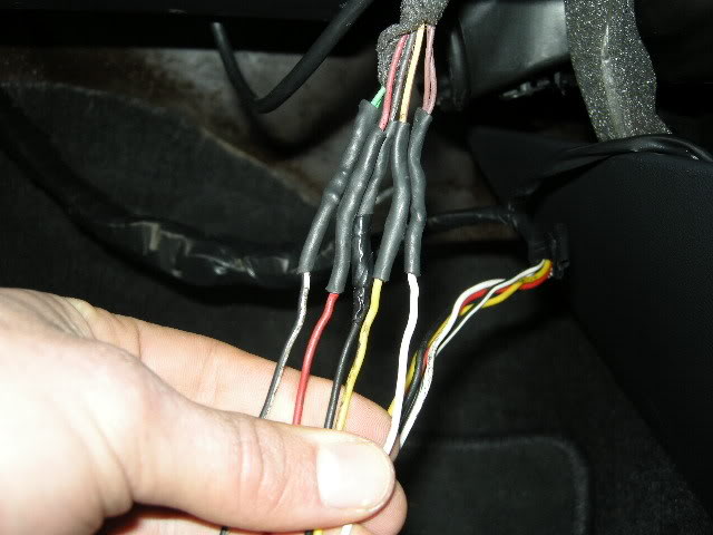

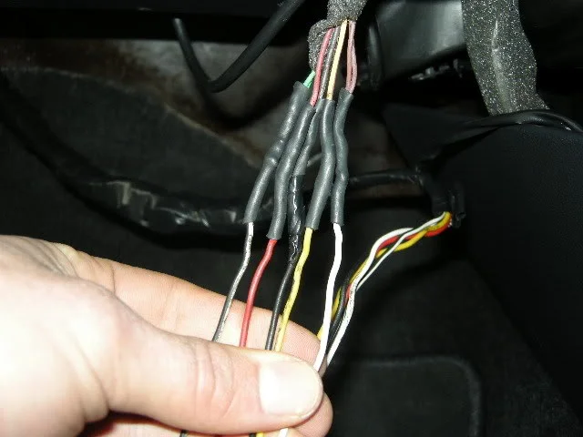

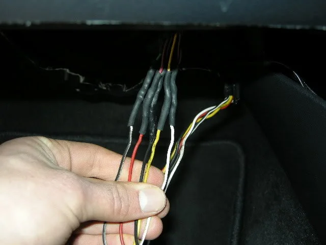

right mate, ive had a look at mine and it is not plugged in, the wires are cut and soldered, and mine was factory fitted. The wires look like they have been seperated from the rest at the factory though as they have foam wrapped round them, they are under the glovebox closest to the centre console.
The wires run from the uch, over the top of the glovebox to the centre of the dash.
I dont know exactly which wires join what as it was dark, but I can tell you the wires should be two green, two purple, one red/purple, one yellow/brown and a couple others. If youre still lost I'll have a look in the morning and untape the wires and see what joins what. If someone has the haynes manual though they can give the wires colours and what they are.

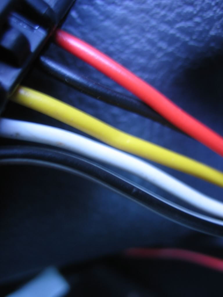

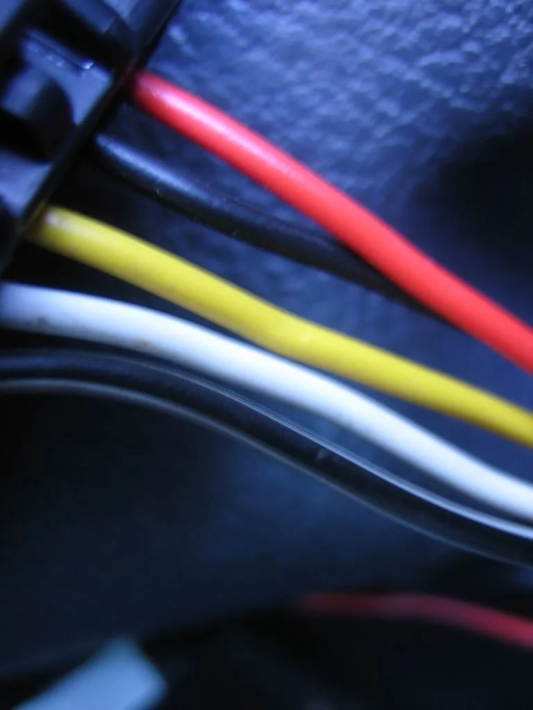

OK then, i've given up looking for where to plug in the stupid connection and i've decided i'm going to cut and solder it in. can someone tell me exactly which wires i need to connect up. the ones that i've got from the alarm unit are; white, white/black, yellow, black, and red.
  Clio 172
here are better pictures of the alarm wires i need to solder into the loom. help!
Black and white, white, yellow, black, red.
  Black Gold Trophy
Ok mate, the wires on your alarm are the same colours as mine, and on the instruction manual I posted on here.
