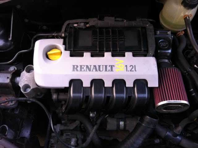

My 1.2 16v (2005) Fitted like this:
Might be an idea to check your engine bay.

The one in the picture that james posted is a PH3 engine, and the airbox mounts different to the one in the ebay advert.
Check your engine bay as to where the throttle body is located. If its a ph3 the standard airbox is plastic on top of the engine/down the right side, and the TB is on the right side.
On the PH2 engine the TB is different and you need an adaptor plate like the one on the ebay advert.
Post a picture of your engine bay up and ill tell you which one you need.

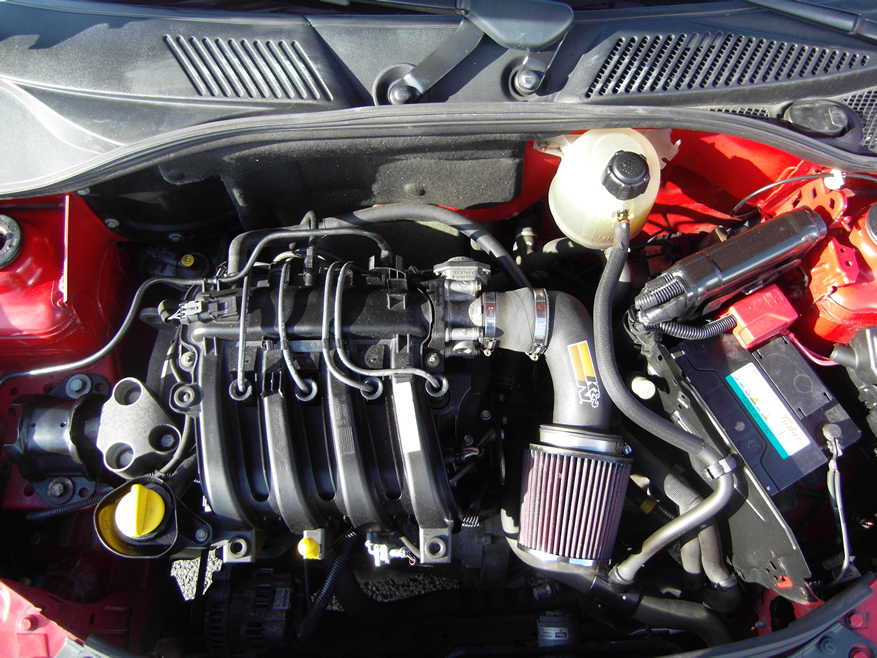

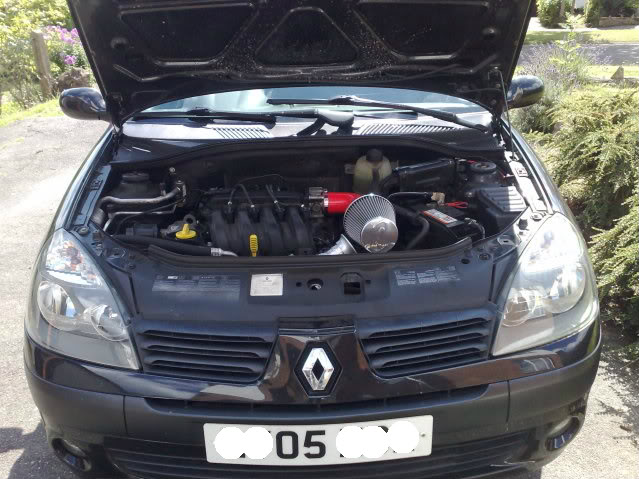

Here you go,
My PH3 engine with K&N:
A PH2 engine, with unknown Cone, Note the adaptor plate and location of the TB:
The air filter you posted will only fit a PH2, and unlike in the above PH2 engine bay it will not have the re-locator pipe to bring it to the front of the bay, it will sit next to the engine on the left.

Here you go,
mines like your second pic 2002 Clio 16v thanks
