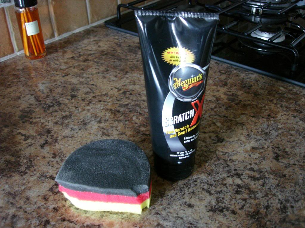

I have a tube of scratch x and a german applicator....

2. Which side of the applicator do i use (yellow/black)?

Yellow side should be the polishing side.

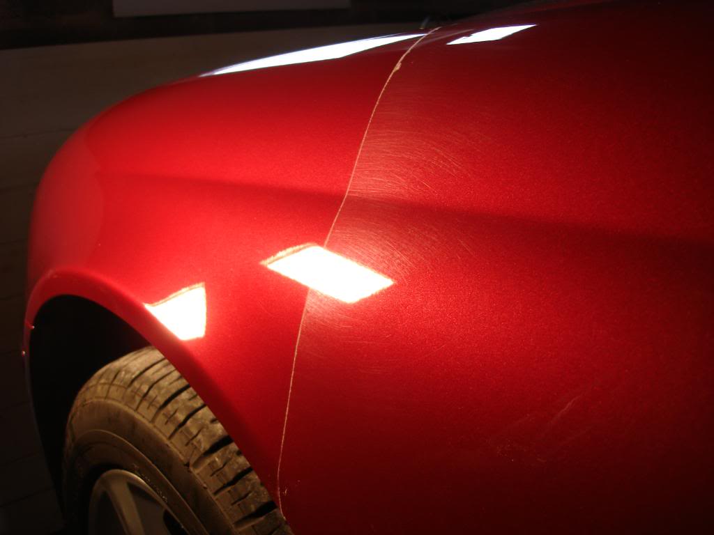

Car is brand new only 1 month old and the missus took it through the car wash :mad:
so i need to get rid of the swirling.
could be the sonus pad then!!
just assumed it was the german one as it looked like the german flag! lol!
the 3 coloured one ?
used it for about 2.5 hours on a small area and managed to achieve this:
It was with this pad:
yeah that second picture is exactly what i have,
