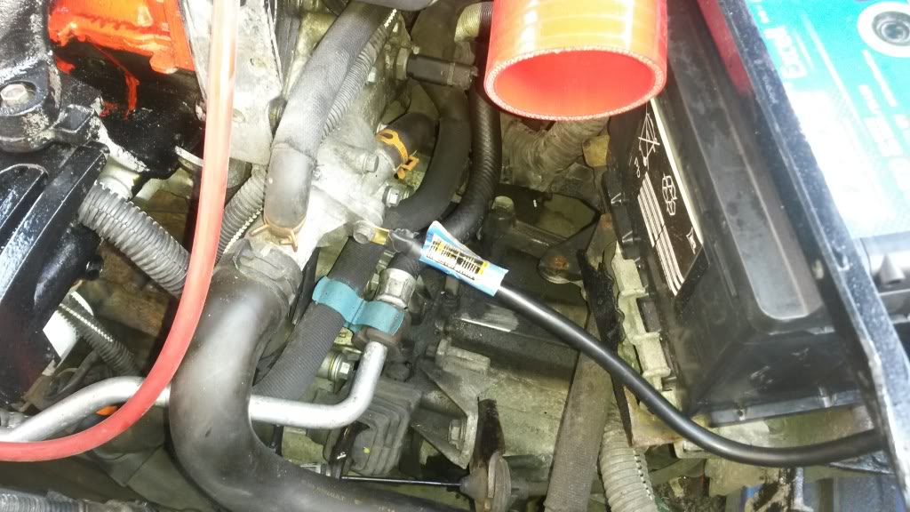

Get some jump leads from the earth of battery and clamp onto the engine block, or gearbox... see what happens.
Earth strap from gearbox to chassis passenger side common for rotting....
Just earthed it with jump lead to engine block straight into life will try again in a hour to make sure its no a 1 off :quiet:
