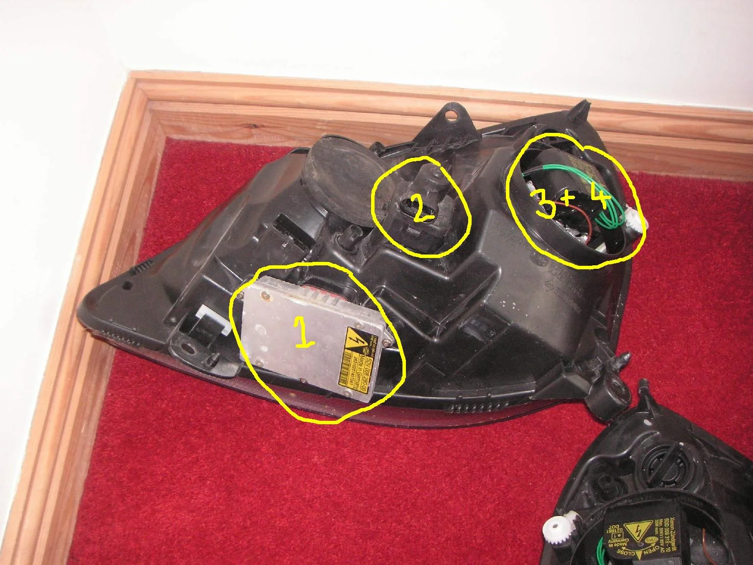

hi jua got these 172 xenons this morning,should i have two of thesegrey/silver boxes?one on each unit? can somebody tell me from the pics if i have everything for that light to work? also the xenon projector lense seems to be very loose,can this be tighted as there are screws surrounding it?thanks

As per my labelling:
1) Charge Pack
2) Leveling Unit
3) Xenon Bulb
4) Ballast
The xenon bulb will be under this, but be VERY carefull if you decide to "unplug" it all to have a peek. Its hard to put back into place.
You must have 2 of everything above! ^^^
So each one per light unit.
I know exactly what you mean by "loose" i had the same problem.
You are now faced with 2 possible outcomes:
a) Its simply just the leveling unit un-hooked itself from the inner light (easy fix)
b) The unit has been damaged bringing it internally damaged (no fix) !
PM me if u need more info mate. Possibly see you this weekend?

just 1 thing tho Has, you've got 1) charge pack and 4) ballast the wrong way round ;) The ballast is bolted to the headlight unit whereas the charger/starter is attached to the lamp :)
