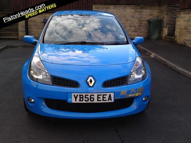

anyway here some pics to try and explain it better
in the first pic this shows just normal headlights, not projector

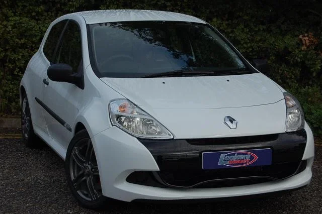

next is a picture with 200 with projectors, notice the little glass ball, (this controls where the light is dispersed)
hope this helps, its not an obvious difference but will make a big difference when you fit hids
cheers mate dont think i have the projector ones, are they an expensive thing to buy??

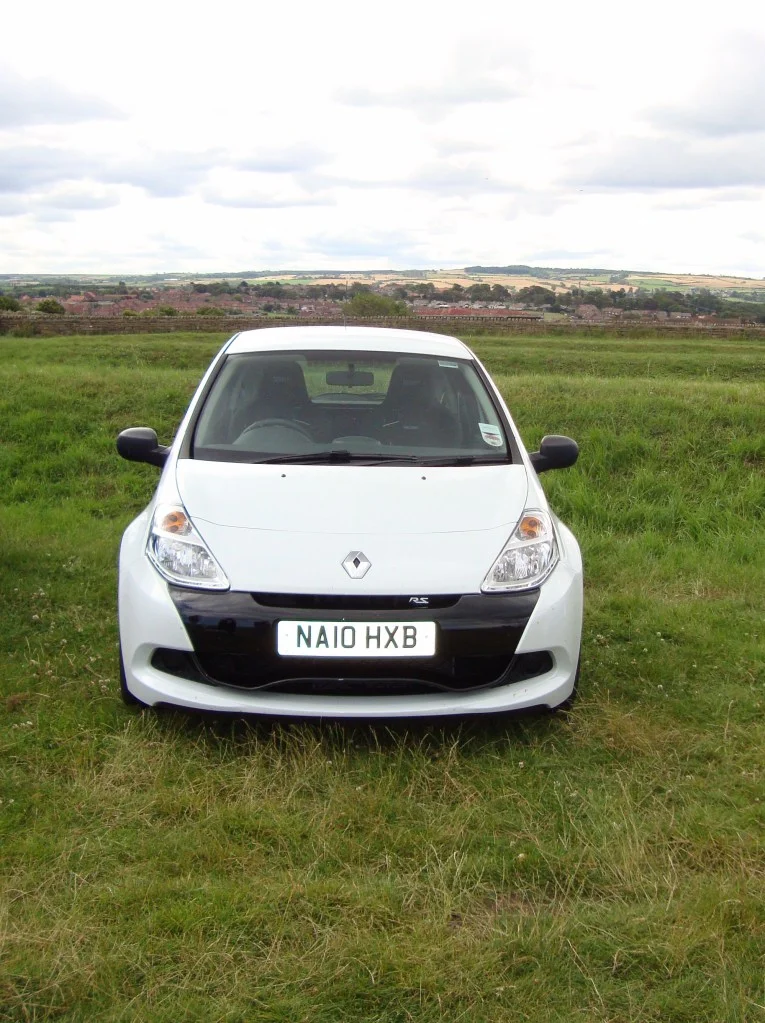

You dont have the projectors mate , below is a closeup pic of mine (with projectors) which shows the projector.
The fitting for the NON Projector is H7.
Ive changed the bulbs 3 times now to try get a better output , the only ones Im kinda happy with are the PIAA bulbs.
Ive not gone for the HIDs yet as I wanted to exhaust all legal avenues first.
