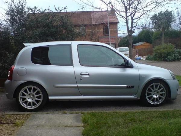

Len_Beach is my best mate and he used to feature on here an awful lot. He decided to get a 172 circa 2004 after rolling around in Cavaliers. A bit of a search produced 'The bullet' as he called it, owned by a woman in Wakefield - standard apart from a CAT back exhaust.
At first, it was his pride and joy. Treated with the upmost respect, cleaned and clayed regularly with only super-unleaded for hydration and subtle modifications to produce: "The bullet" - LOL
This was taken in 2006 (I think). The car is a 2001 reg and was a few years old when he got it, but even at 5 years old, it was in great shape.
And it remained pretty much in that state, with the later addition of a V6 spoiler (and springs were changed to eibachs) until May 2009....

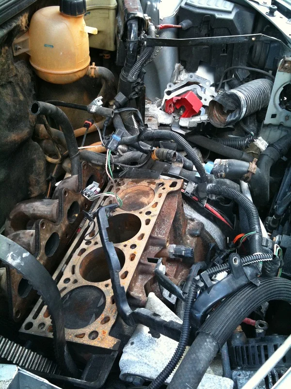

We had it recovered to my house and my old man agreed to replace the headgasket and getting running again...
So he stripped it down after work....
and thats when we got a bit upset.
You should be able to see the block - and the crack running along it...
If it was going to be back on the road, then it would need a new engine pretty much. I was all for giving it back, but my old man said that fitting a new engine would be 'pretty straight-forward'. He was not so optimistic a week or so later...
