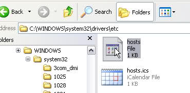

I doubt it's a hosts file entry, but you can check by looking in your C:\wINDOWS\System32\drivers\etc you can open it with Notepad. There shouldn't be anything in there [that's uncommented apart from a single localhost redirect], unless you have a custom list of bad URL's added. If you see anything related to 64.233.181.99 comment it out/remove it and resave the file.

Did you open the hosts file in the following directory:
C:\WINDOWS\System32\drivers\etc
I don't know what you mean by "the hosts file"

You open it with notepad and see if there is an entry that has google in it:

Removed them in the "host" file, and offski the problem went, well that was something I never knew.

There are two with google in mate, remove them and then CTRL + S?

After you save, right click the hosts file, choose properties, then clikc the "read only" option. This should stop anything screwing with the hosts file as easily.
