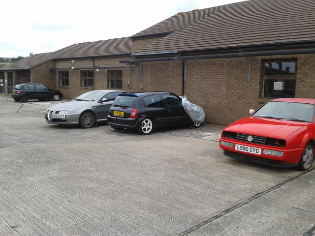

Blue wheels are no more, fitted my pro race 2 wheels today
think they look ok for now
turning in to a wheel *****
