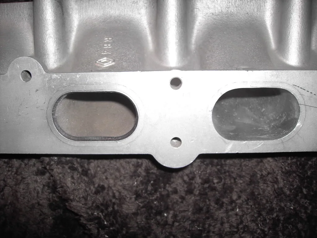

so whilst waiting i started on boring out and matching my inlets and plasticoating my wheels

Any before and after pics of the inlets? want a go at doing this myself as i don't fancy ktecs prices. What exactly is the procedure?

Ref the inlets its far easier to let a pro do them tbh
i made loads of measurements / drawings ect and tbh im totaly stabbing in the dark
All i done was measured the shape / size of ports on the head, then replicated it on to inlets through out the whole inlet tract
only comparison pic is the one posted in your reply
its very easy to make it worse though, but as im doing forced induction it should not matter too much

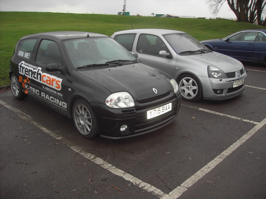

Yeah Danny i won it, it was originally the K-tec Built project car for Performance French Car Magazine
Sent 5 text messages in to the competition they ran to win it = £ 5 = clio 172
yeah now in the process of fully forging, supercharging with a set of cams in there too for good measure
