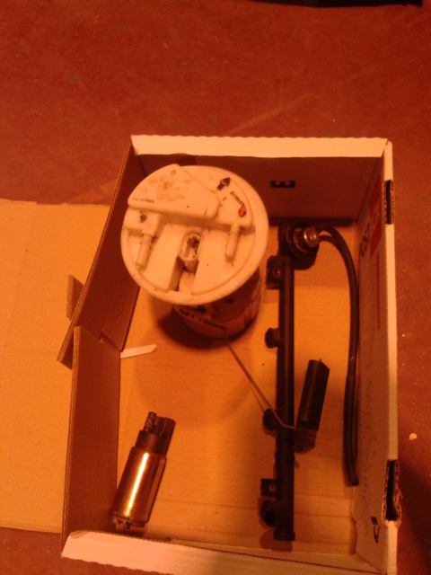

finally got a ph 1 fuel set up sorted, now need to trim it and fit a walbro 225 pump

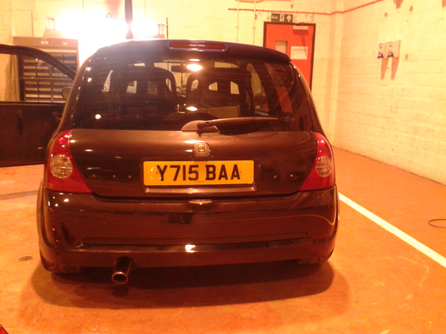

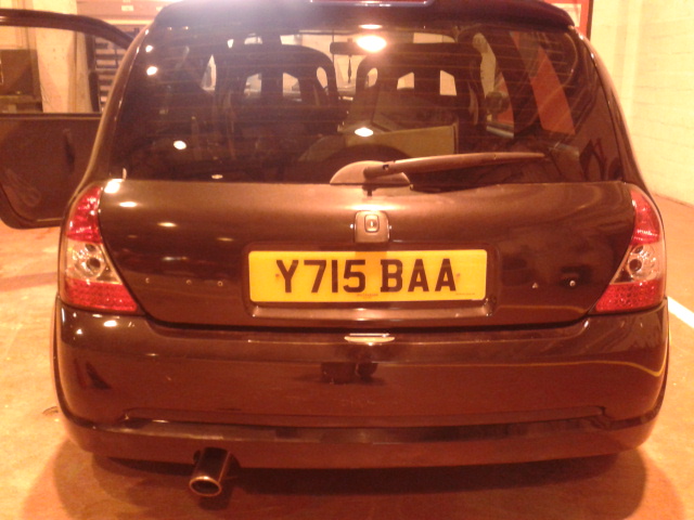

now on a course for a year, so car has sort of hit a stand still
hence the dust / dirt
