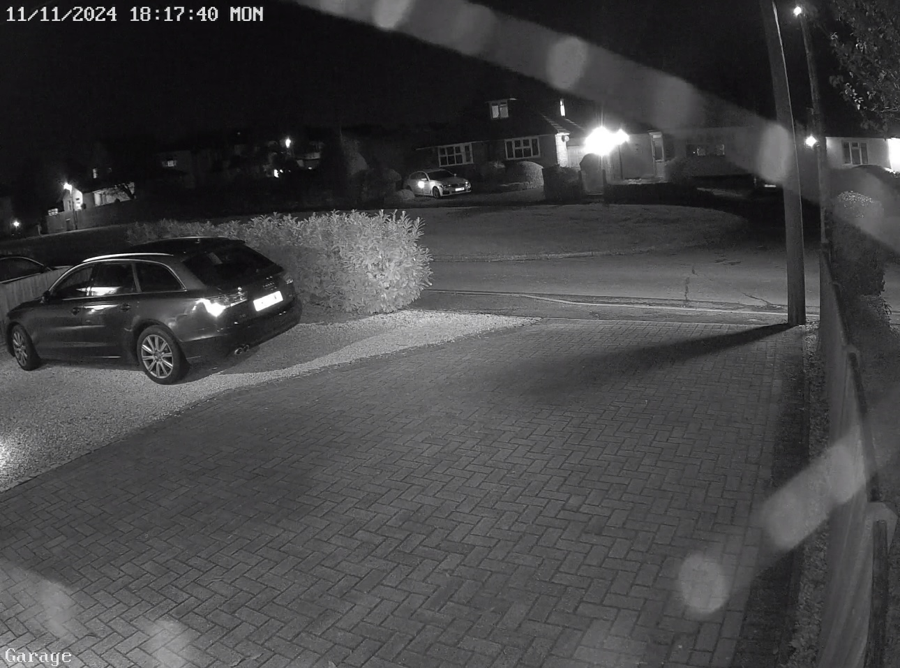

Anyone can recommend a camera that has a decent image quality, so if I zoom in a number plate 15-20m away, is readable?
Got a imou Cruiser dual at the moment, and is crap.

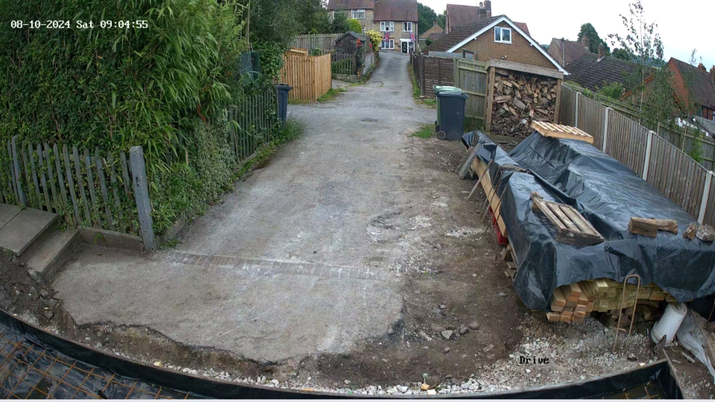

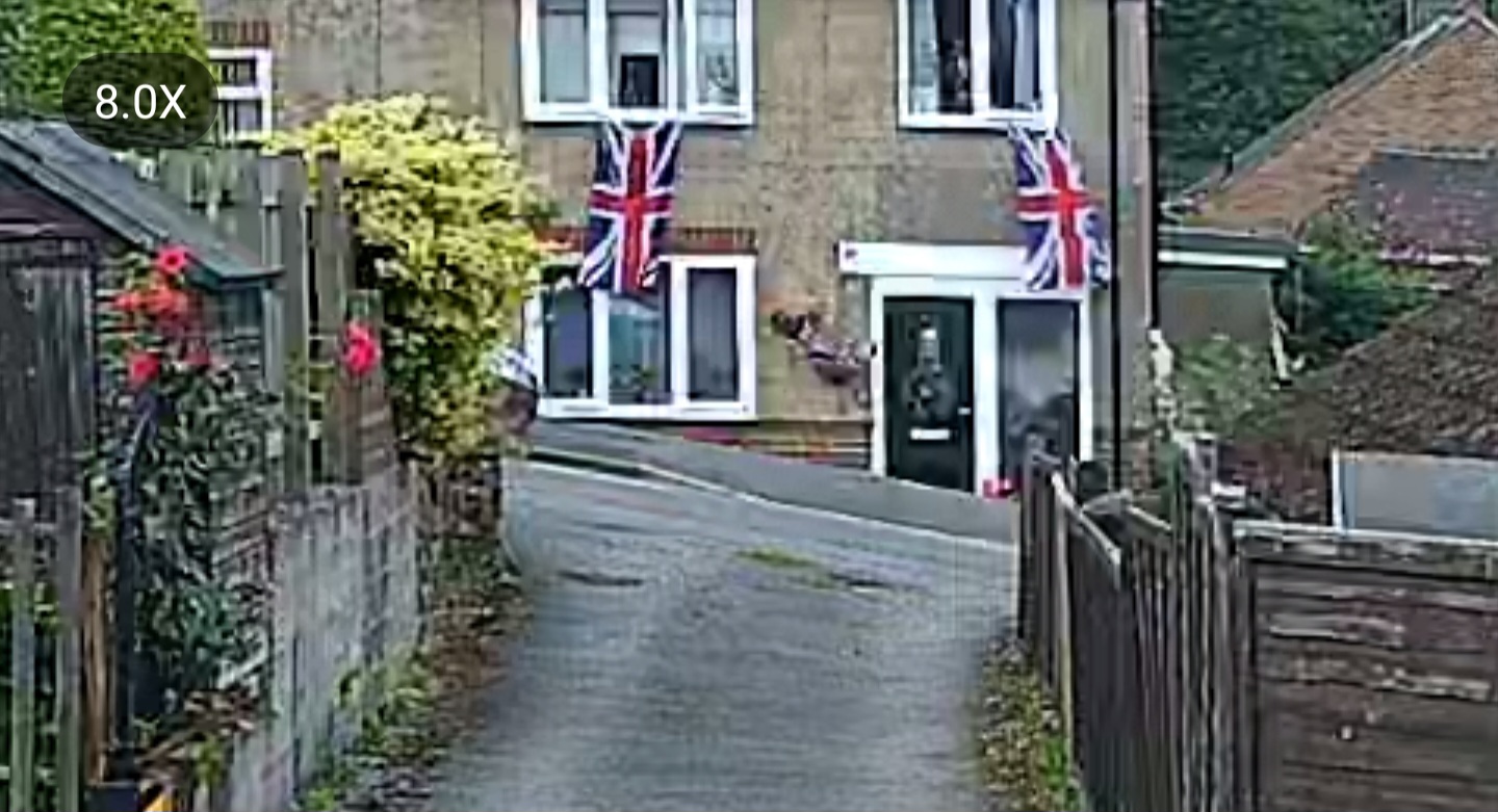

I know it doesn't show any registration plates but the 8mp colourvue cameras I have here may give you an idea of the quality at full zoom.
The quality is also much better when you download the file and export that way. I have simply just screenshotted here so it's not as good
Standard view
Zoomed in. Excuse the flags, it's not a council area either 😂

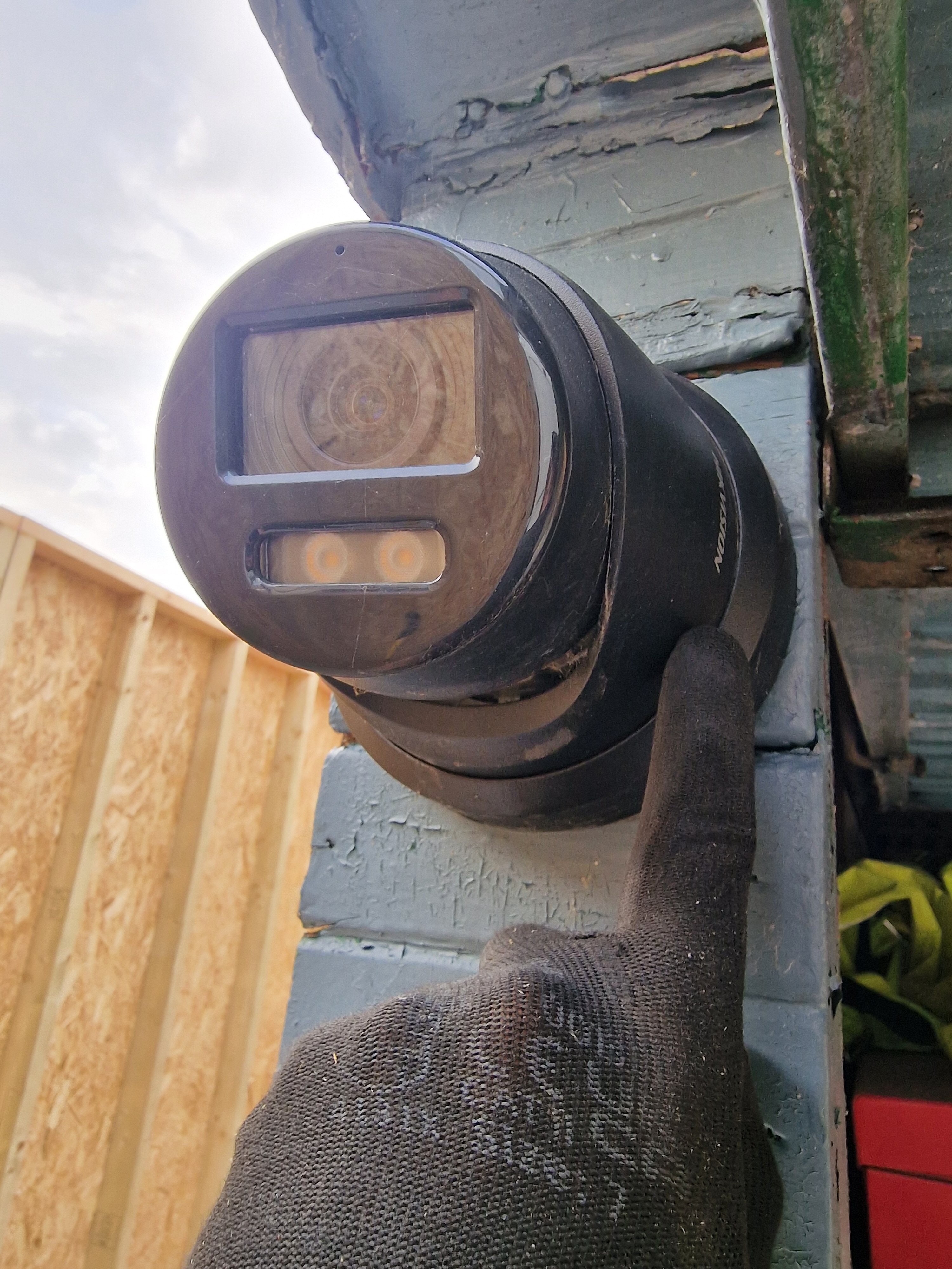

Anyone have any good tips for keeping spiders away from the cameras?
I sprayed the minty Amazon one I got two nights ago, and they’re straight back:
Cameras aren’t clever enough to decide the movement of the web can be ignored. :mad:
