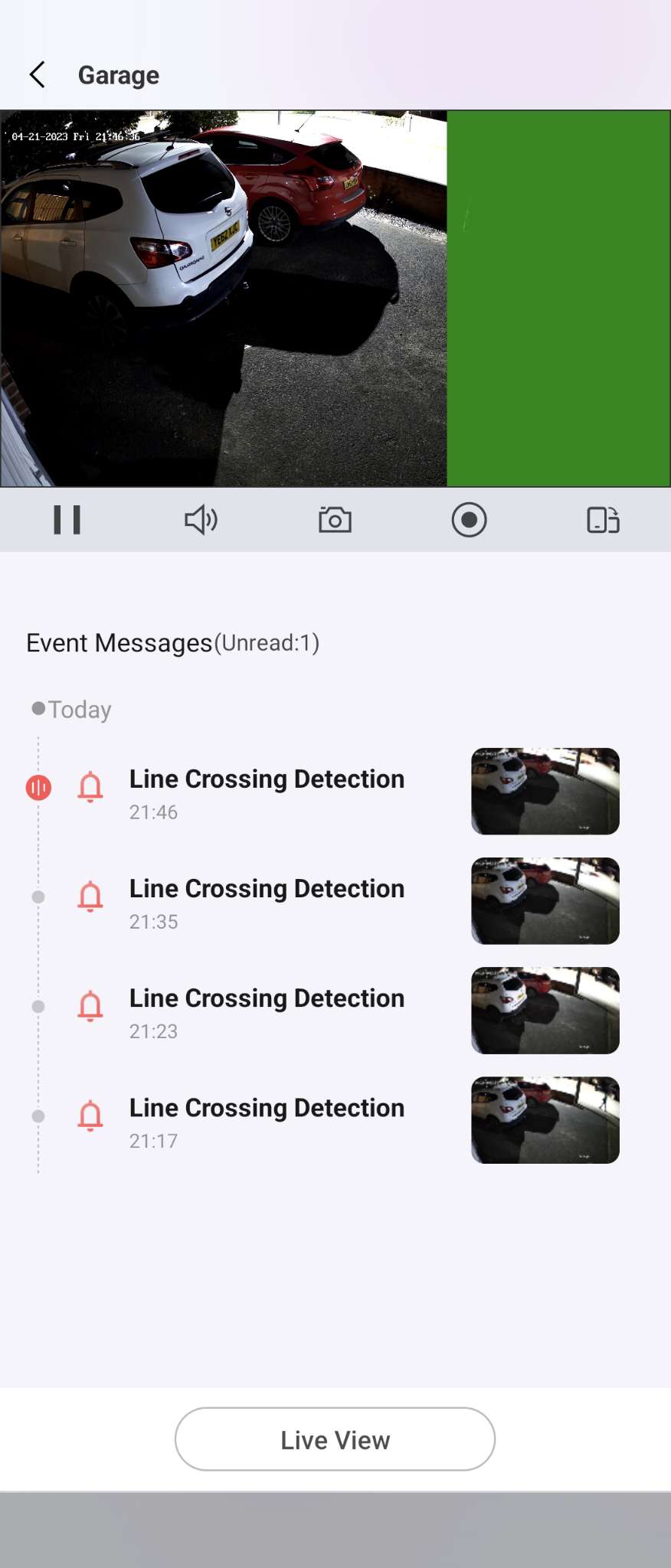

Ive got to the point where I might just send my colourvu camera back, I'm having nothing but problems with it. My dark fighter works perfect, no issues at all.
The colourvu takes ages to load then all I get is this. It's the same when I try to review a triggered event
