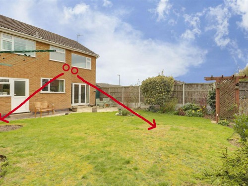

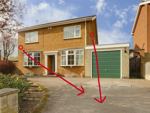

Where and more importantly, how high have people positioned their cameras?
I don't want them positioned too high and not be able to see faces clearly and won't be able to see how they look until the cables are already run.
This is what I'm thinking for the front and back. OK or do they need moving?
Steve
  LMC10, Puma E
I have the two at front set low, one by front door & other under soffit looking at the drive & cars.
You could have one by front door in porch area?
The one on the side is set high under the soffit & one on back looking at back door & rear is also under soffit (out of the weather)

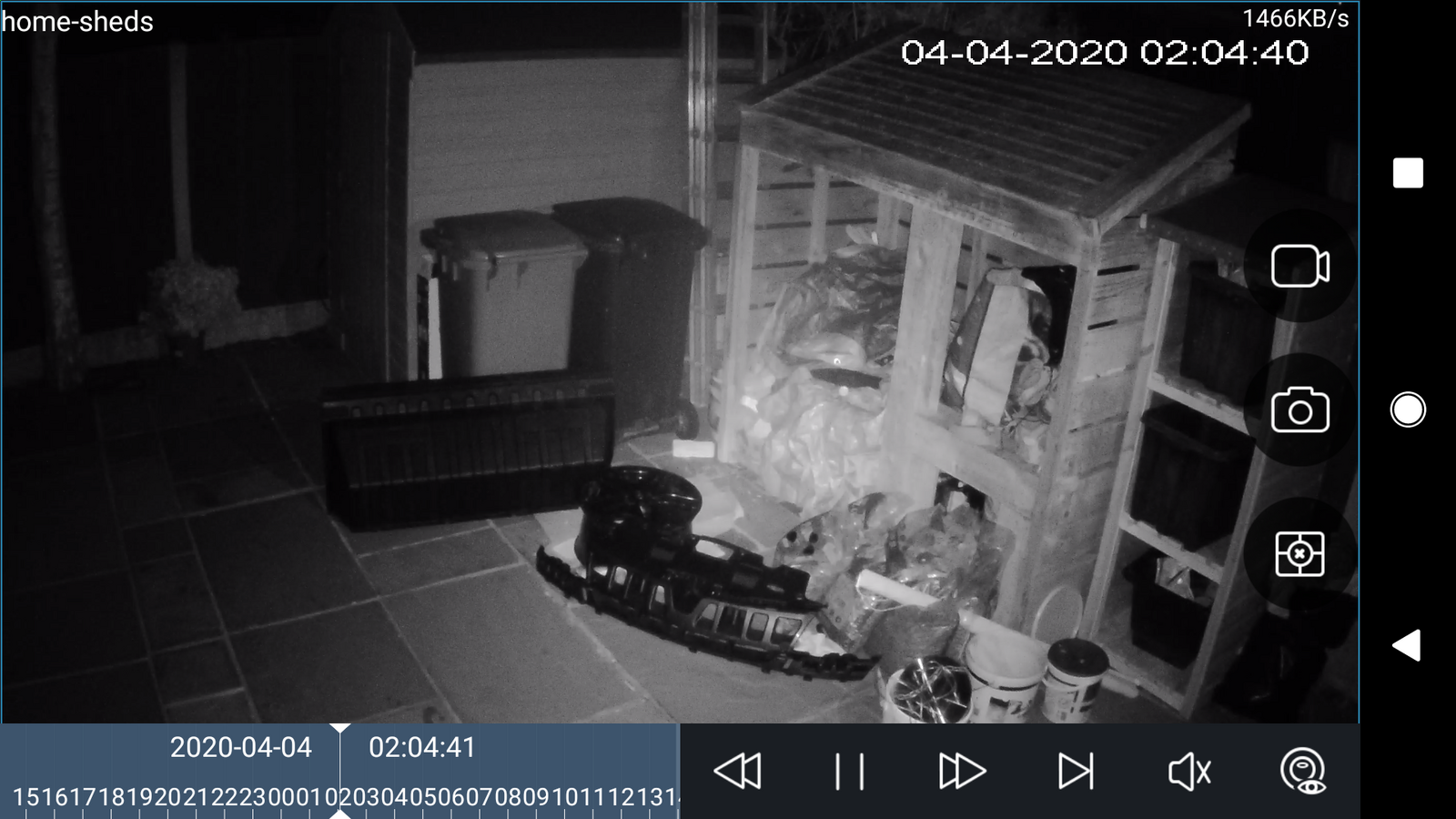

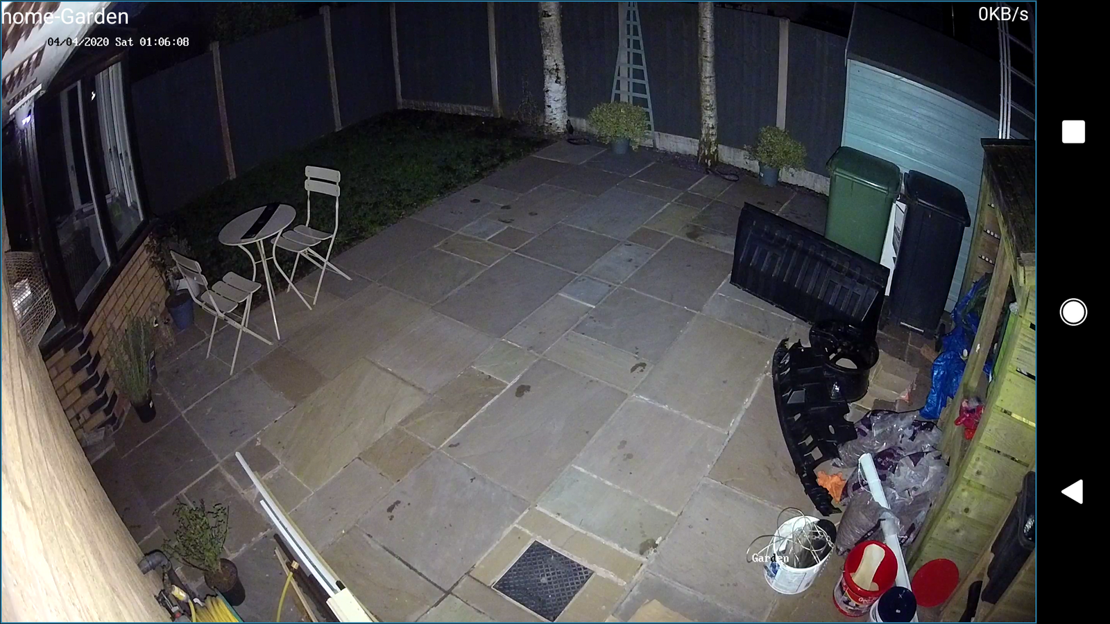

Got one on demo
Same garden - effectively they cross eachother excuse the mess got a project in the go in the house so it's now a dumping ground lol
Monochrome is a 4mp dahua dome
Colour is a hik colurview 5mp
It's ok tbh however they do run a led to illuminate if there's no supplementry lighting
Dahua make a better one that doesn't have an led - need to get my hands on one of them

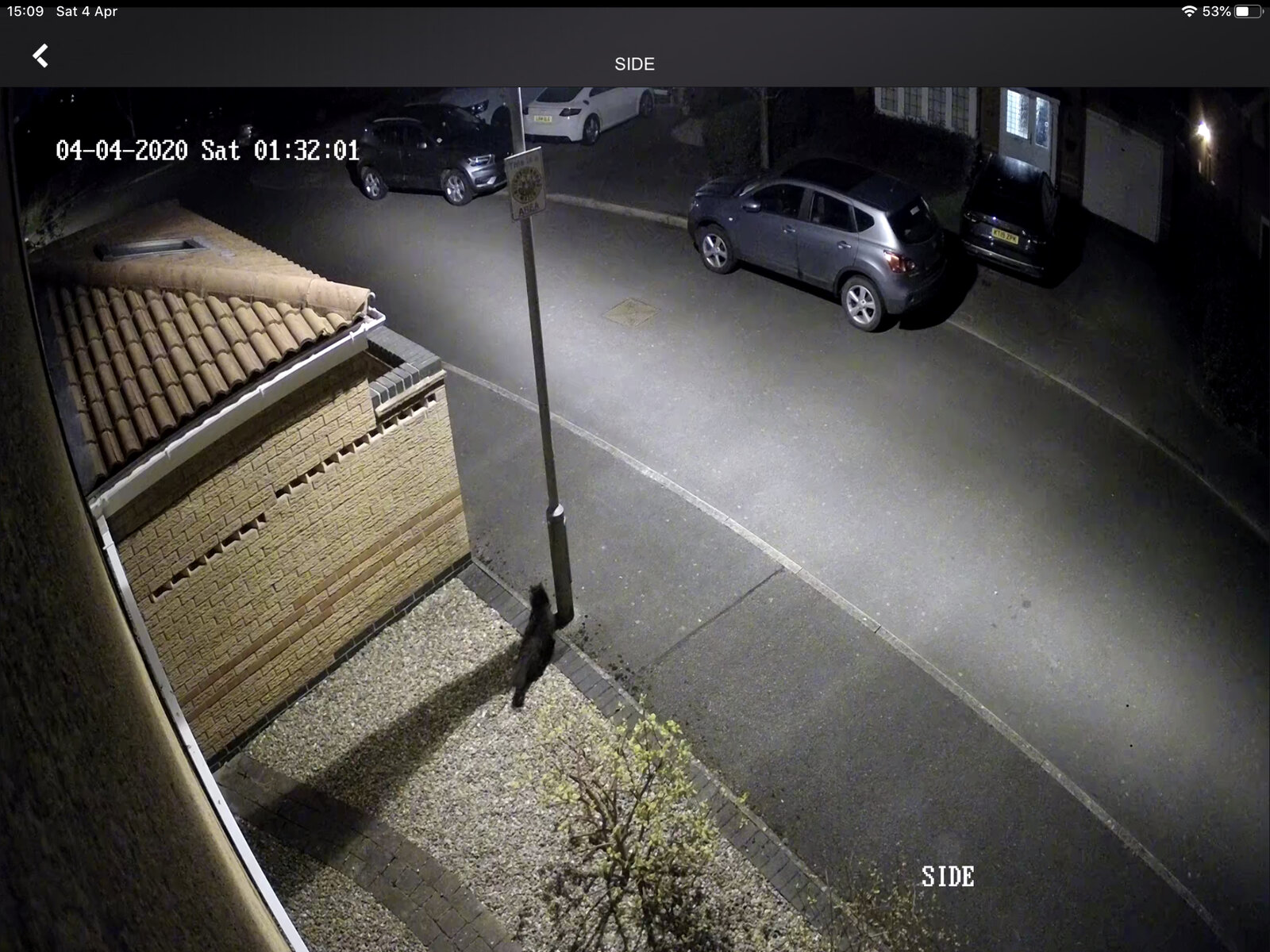

This was mine from last night, cats trigger the motion.
Screen shot from playback.
