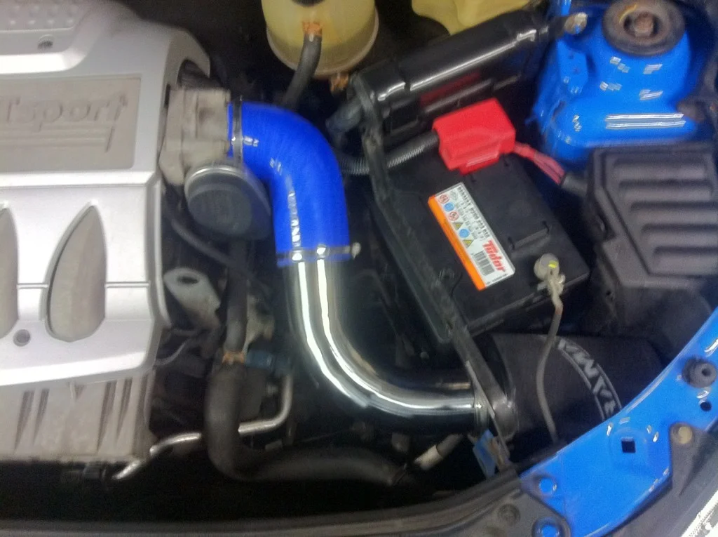

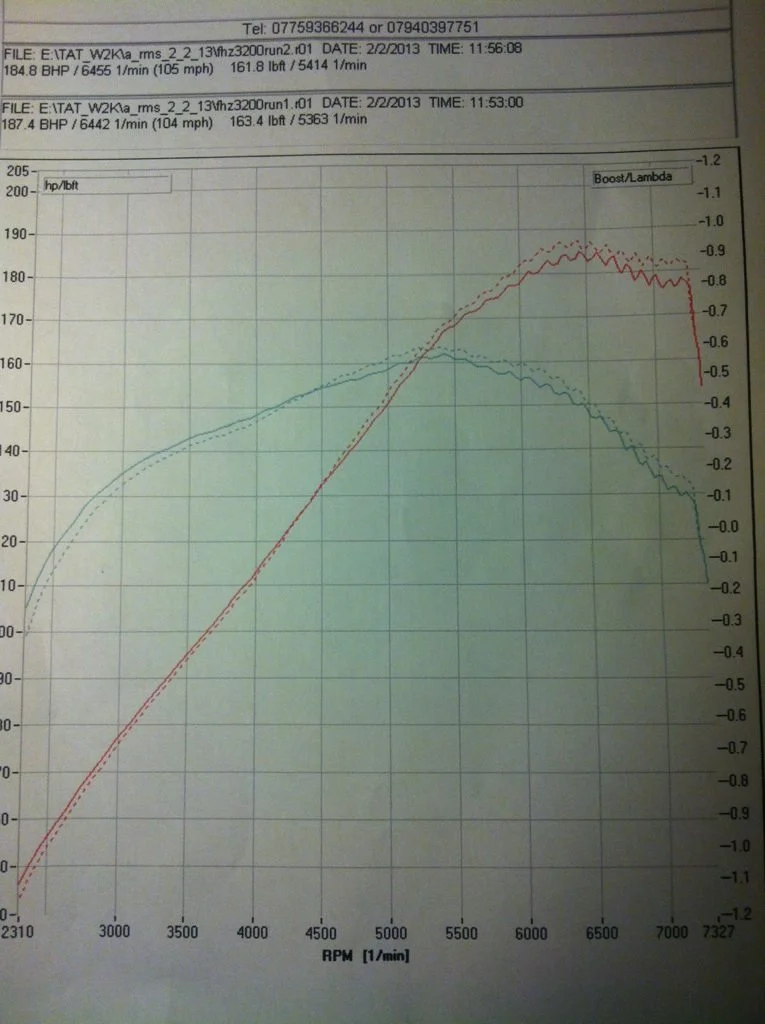

Thought I would put the clio on the dyno today and see if the induction kit made or lost hp so it was first tested with my own induction kit. The car made 187.4hp and 163.4lbft , straight after I refitted the stock airbox with a itg drop in filter car made 184.8hp and 161.8lbft I was very happy to see some gain little as they are is lol (car also has rs tuner map my own decat and piper exhaust)
It made slightly less power below 4500rpm with the induction kit but more power after any ways u can see for you self in the pix (dotted line is with the induction kit)

I would imagine you would have lost a few bhp with heat soak - I used to run my black 172 on the same rollers a few times a year, and the 2nd run would usually either stay the same as the first or drop 2/3bhp due to heat soak.
But i bet it sounds a lot better than the standard airbox :)

funny almost every car there made more hp on run 2 and I'm sure mine would have too
