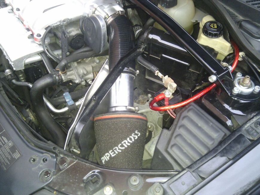

I have bought all the parts to make my own induction kit but I have a problem. I can't fit the filter in front of the battery. How have other people done it, by removing the battery?
  Clio 2.0 RS 172 Ph1
I undid the battery and pushed it back as far as it would go. That gave me some room for the filter, and mine is far too big.

Same sort of size as mine, Mine has the excessive inner cone too. I just sprayed the crap out of mine with K&N oil to make sure it actually filters and squashed it in as best I could.

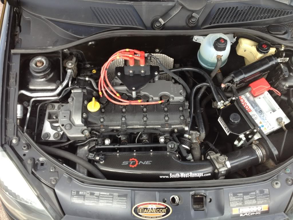

If you swap to an 063 battery it gives you more room, thats what we did when the mrs fitted our RS2.
  182/RS2/ Turbo/Mk1
That looks very tidy Chip!

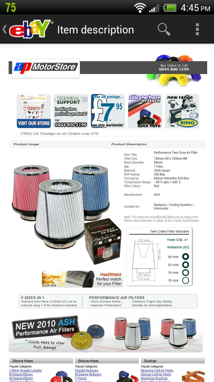

aren't those cheap filters paper rather than cotton gauze? you don't want to be oiling a paper filter. You can't clean them either

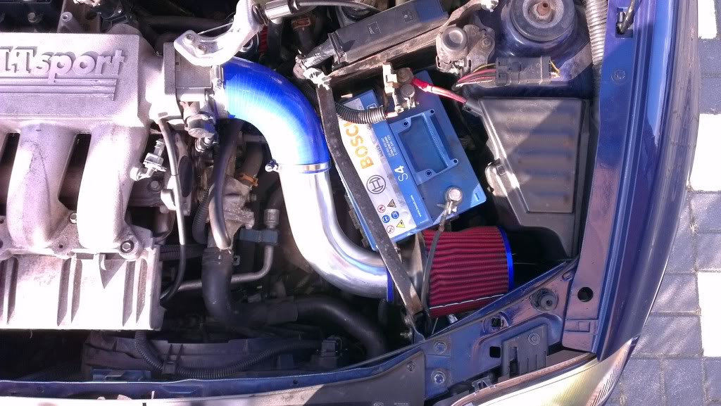

I managed to squeeze my huuuge green filter into place with a bit of bending and cutting.
BEFORE
AFTER
No, mines one of these, still cheap yes, not the best no...but cotton so the oil did no harm.
