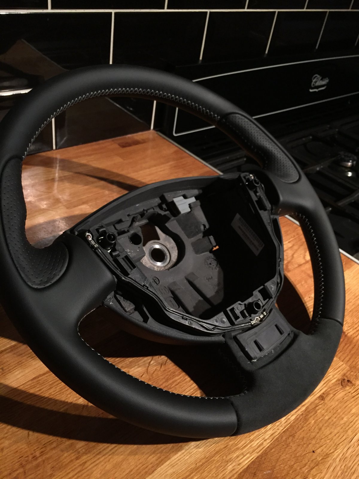

By hand grips do you mean the rubber steering wheel thumb grips? If so £140 gets you a full wheel refurb by a bloke called snappy. The rubber grips are replaced with leather.

+1 for a snappy wheel.
Now that is VERY nice and a definite improvement.
...Does he only do Clio wheels?
