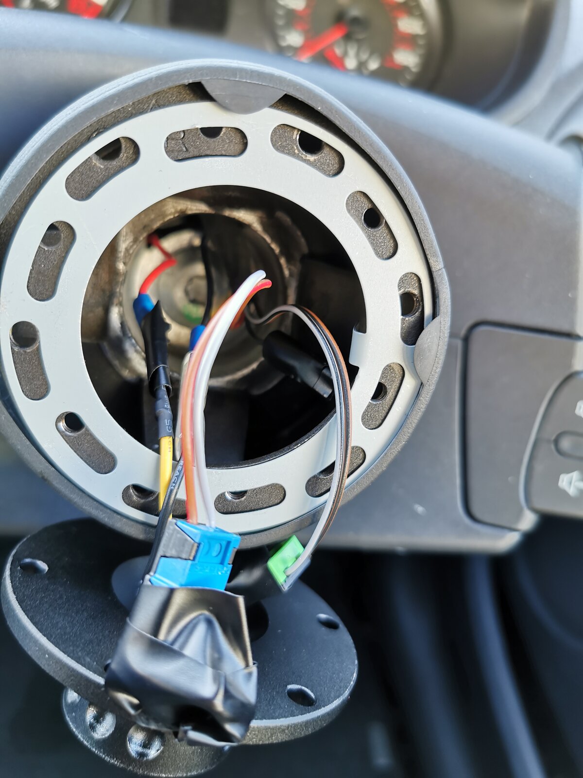

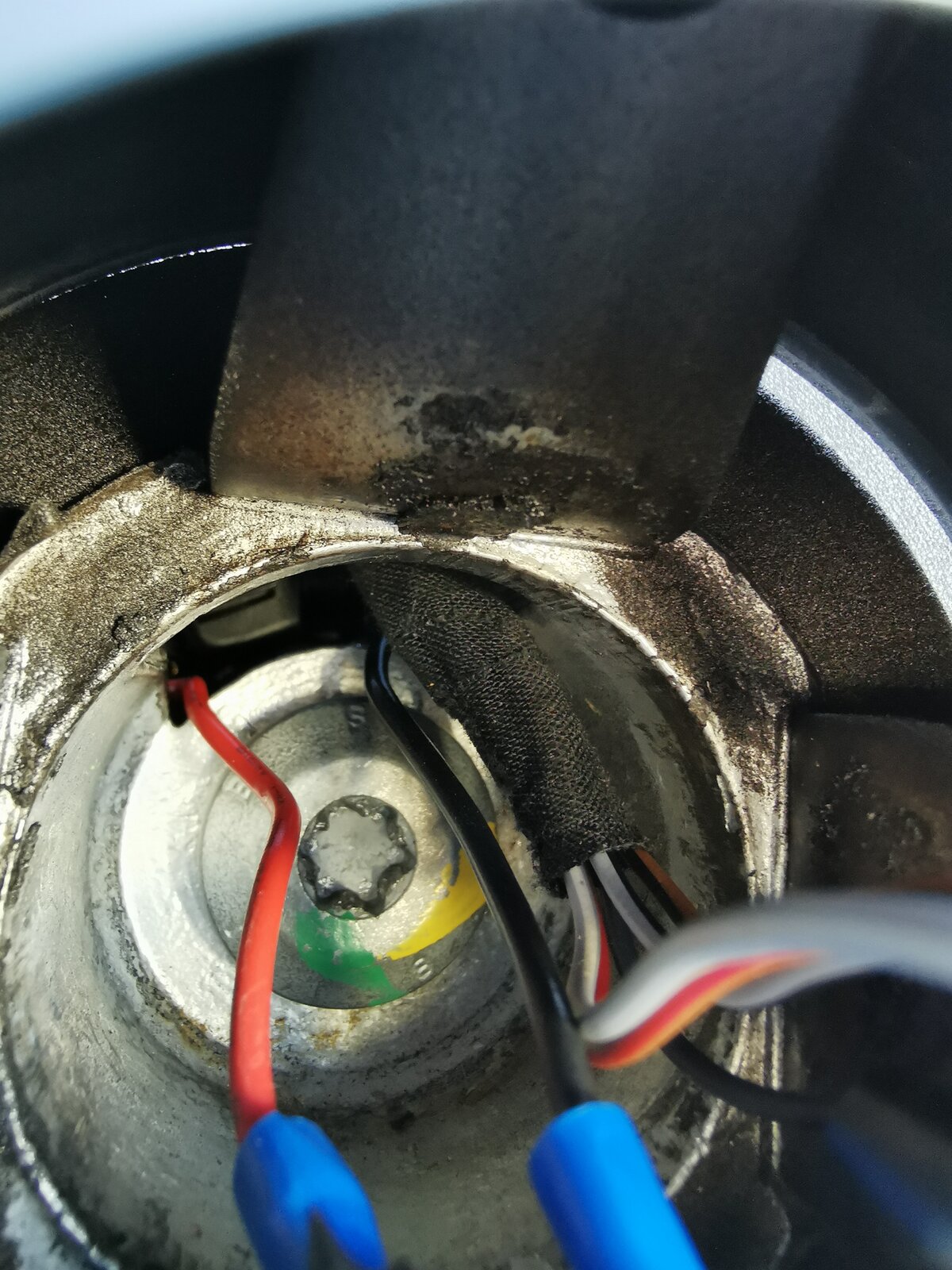

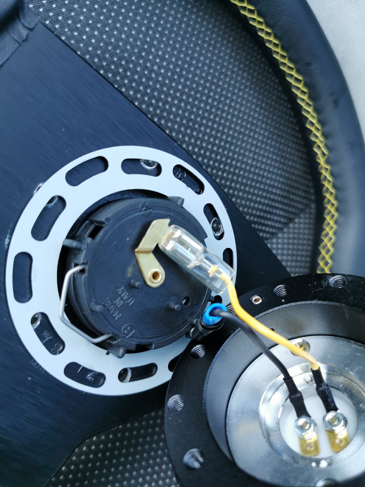

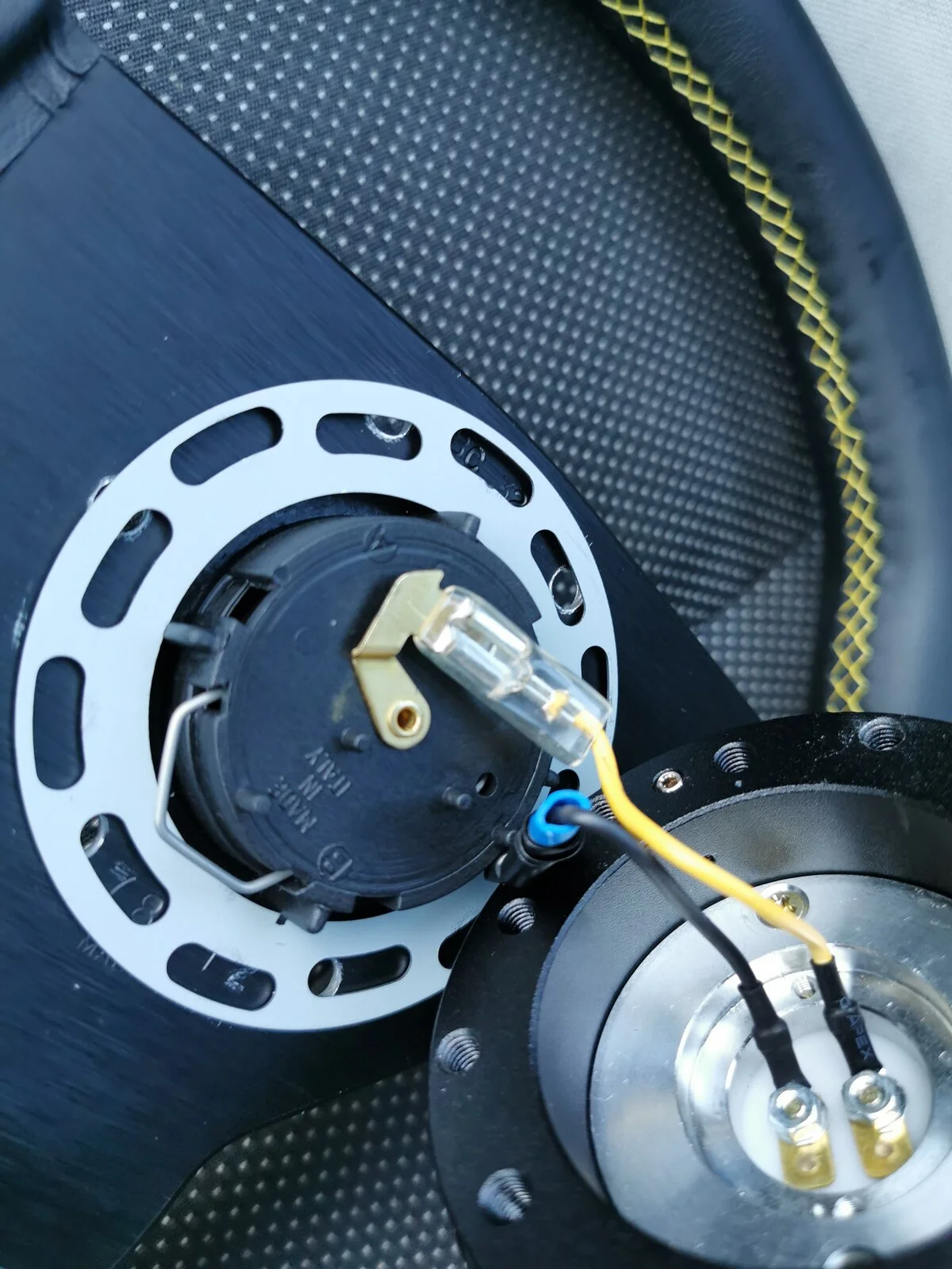

Looking for some help with a small electrical issue. Recently fitted a personal grinta steering wheel with an NGK 2.0 quick release and a simoni racing boss. I've fitted a 3.3ohm resistor to each airbag plug and taped them up to secure them but airbag light is still on. I've also tried (and failed) to wire in the horn button but that wasn't working either. Found that the fuse had blown but when I replaced it the new one blew instantly. Some pics below of how its wired up to the quick release and then the other side of the quick release to my horn button.
