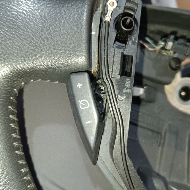

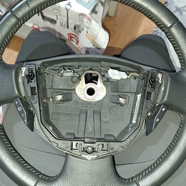

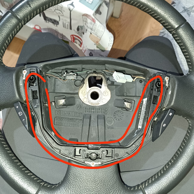

Hello, I'm writing to you in case you can give me a hand, I want to change the Cruise control and speed limiter buttons on a standard Clio steering wheel with those on my Clio sport steering wheel, the problem is that I don't know how to remove the part that I point out on the the photo. I have extracted a first part but there is another one on the steering wheel. Thanks in advance.

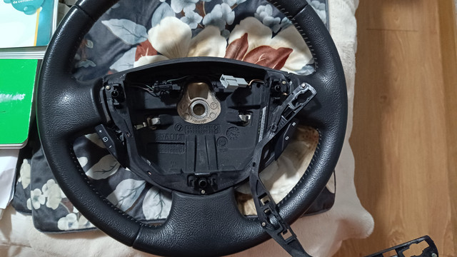

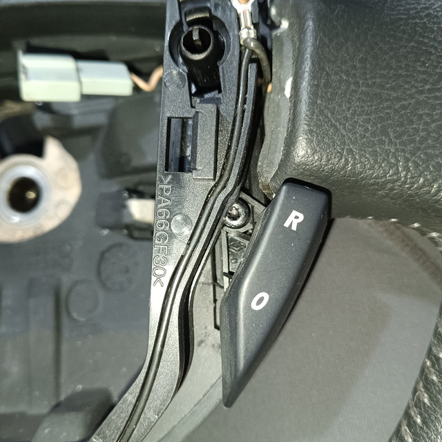

I'm going to answer for myself, I have managed to find out how that plastic is inserted, under pressure, but I think it is not necessary to remove the buttons, since they come with two 20 torx screws, one visible and the other under the plastic. I'm putting it here in case it serves as a guide to anyone in the future.
