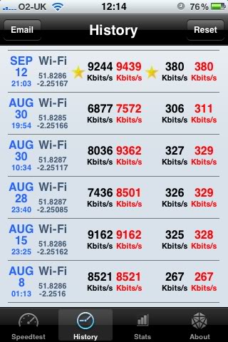

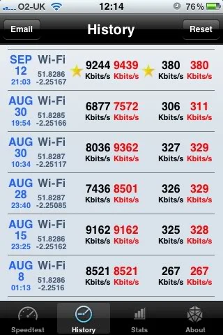

I get 15mb down and 5mb up on wifi on mine all round the house. The laptop does get more but it on wireless N. I had a problem with my old N82 and wireless when the router selected certain channels. It might be worth manually setting the channel on the router until you find one that works for you?

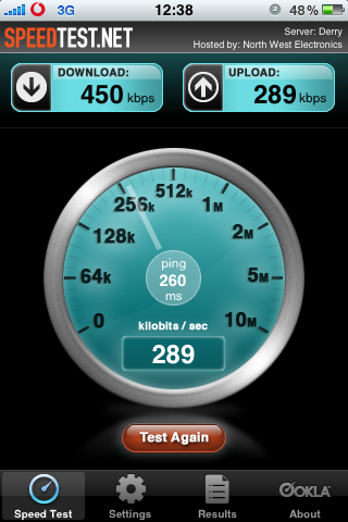

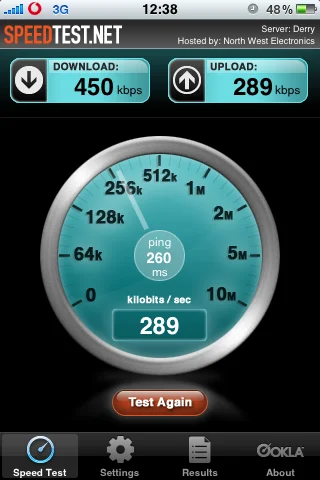

Just tried the speedtest app and it says down 1853kbps and up 368kbps. Hmmmm seems a bit better to what the other sites are telling me. Maybe it aint as bad as i thought.
