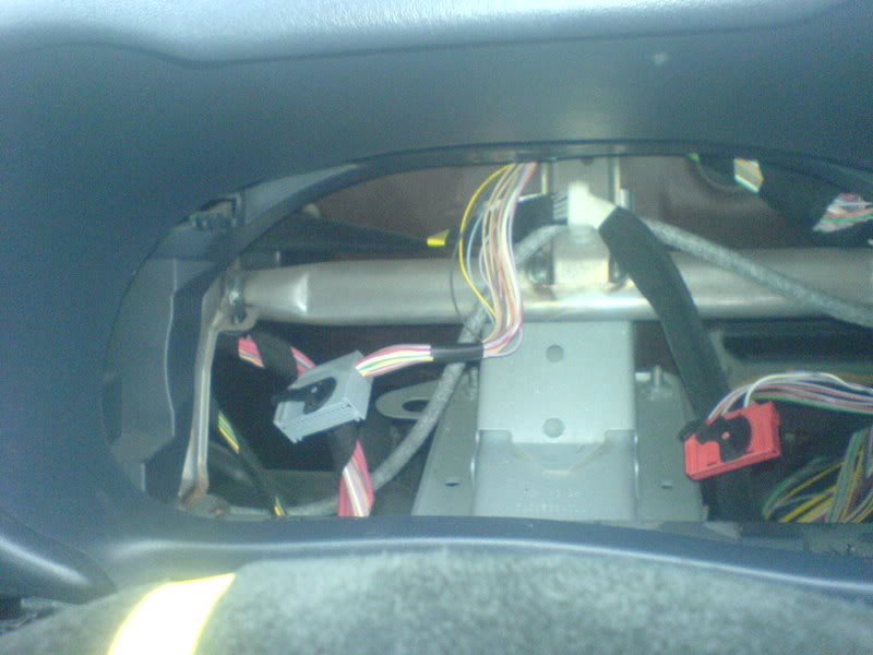

Found a pic - I take its at the back of the cowling???

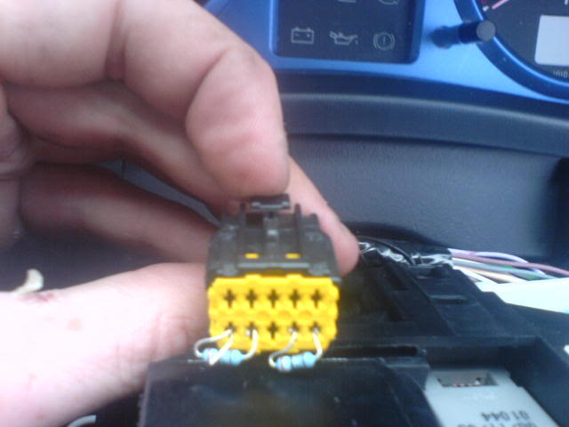

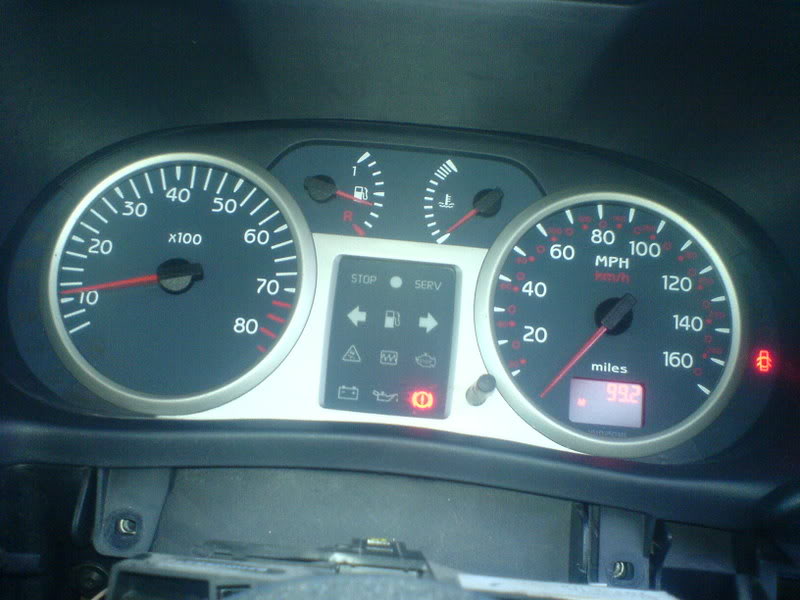

Right found it and when resistors are installed the light is still there! grrr!
I think the only way to get rid of the light is to remove and cover up the light from the binacle.

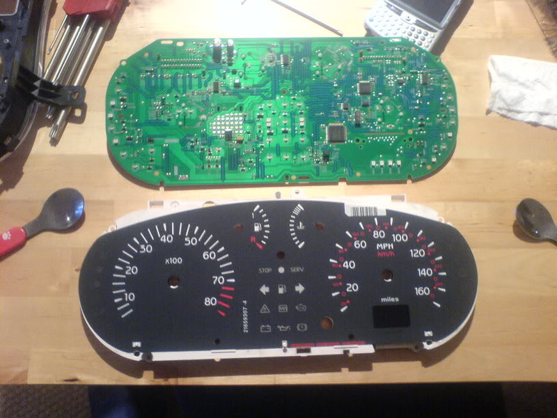

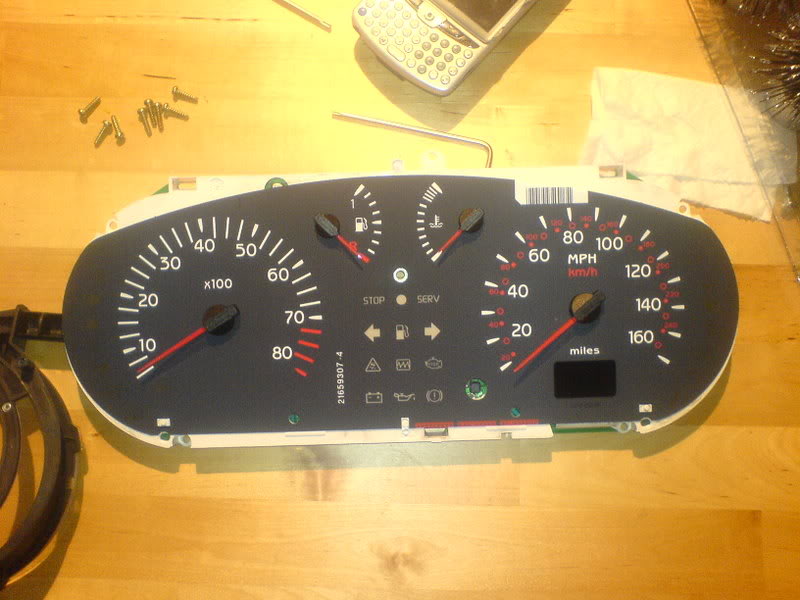

ive removed the dash - going to be nightmare putting back on.
trying wo work out how to get to the circuit board on display.... do i just pull off the needles?

  CTR--VX220D

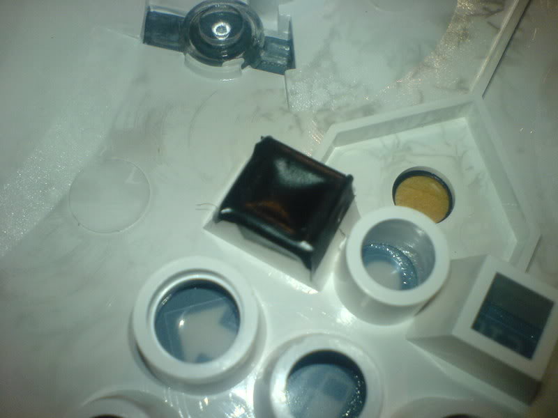

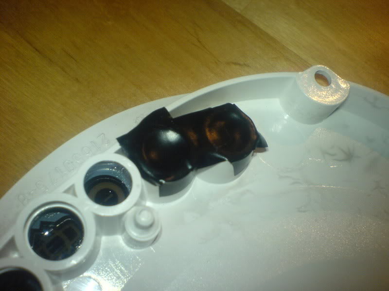

Bugger! All done - and no lights on dash!
But I didnt mark out the speedometer - now Snooper is telling me its 5 mph out ... GRRRRRRRRRRRRR! I have to do it all again!
I'll update the blog.

  CTR--VX220D
Not in the wrong way though Lee, when the dash says 30mph I am actually doing 36mph!!!!! Doh!
