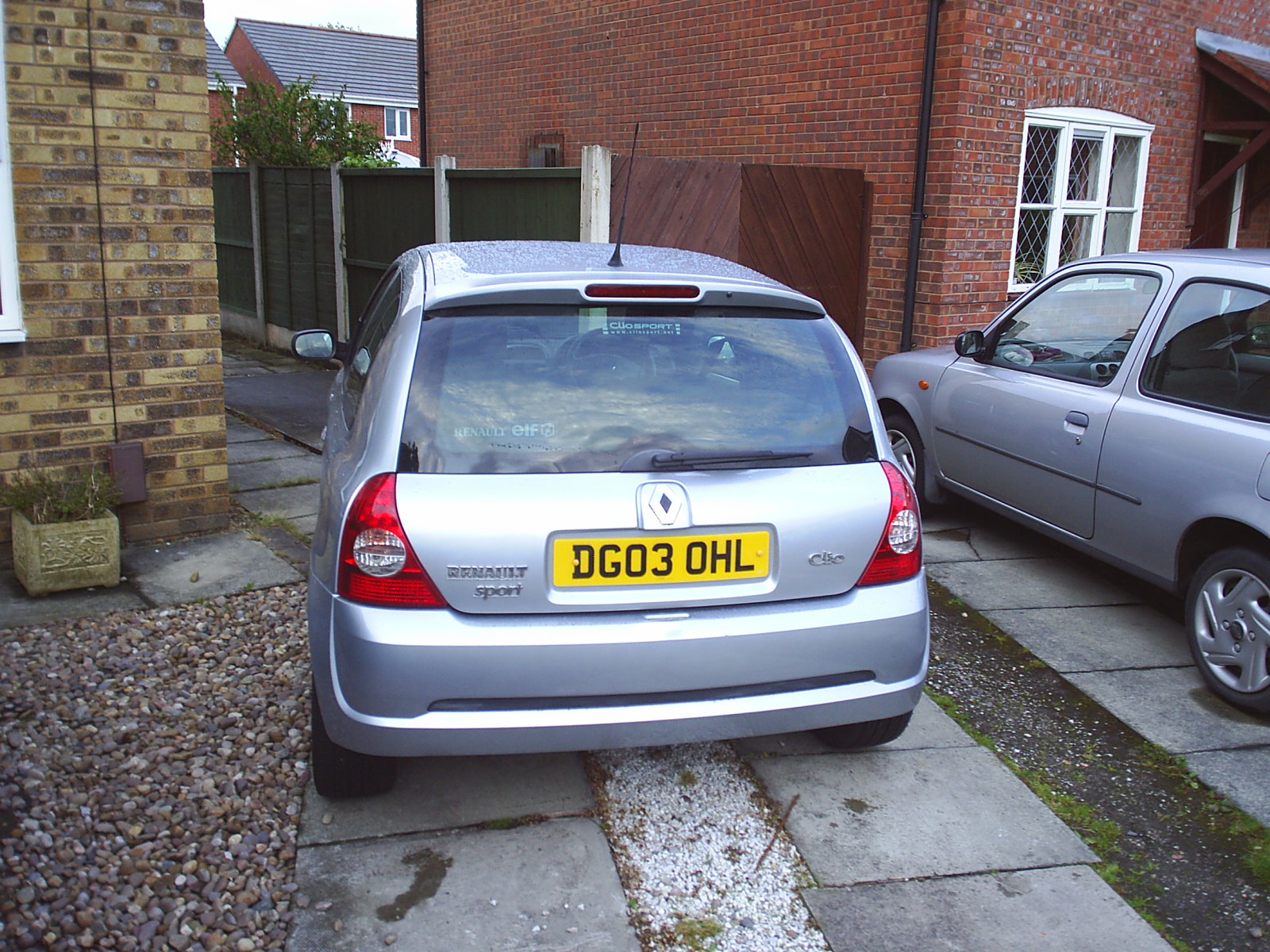

Fitted already!!!
Took me half an hour between getting it on and off and cutting the wires etc.
No moaning as this morning it was black and gold!!!!
So sprayed etc by me with cans from Halfords.

Yeah - unfortunatley I fucked it up when putting on my last coat of lacquer and it led to a bit of a blemish, as such I thought f**k it I will whack it on. Been drying for a few hour's before putting it on. Only cost me £10 to spray etc so I am not too bothered.
