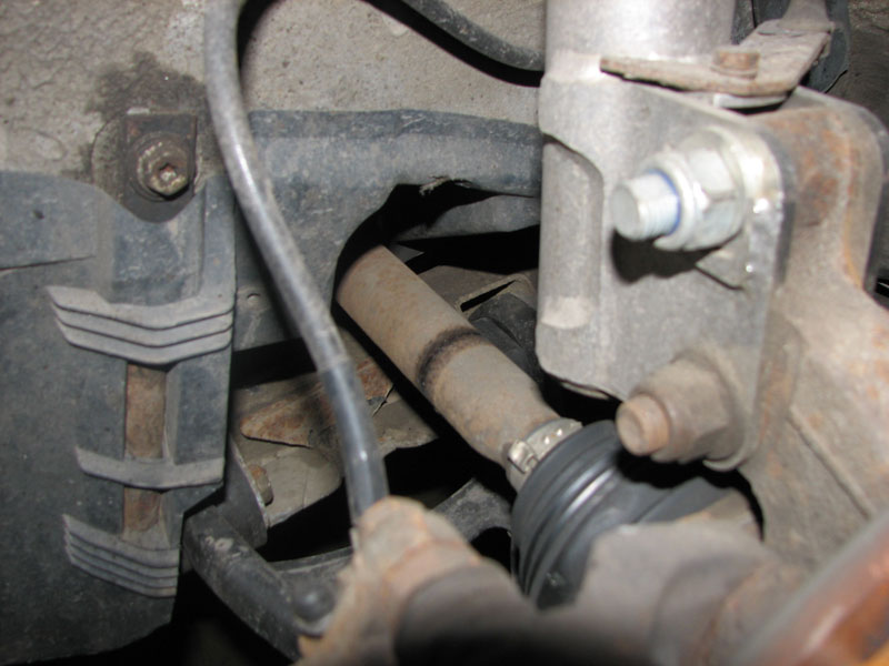

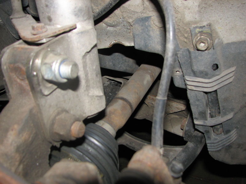

2 shots showing the problem, it is possible that it happened when the car was about 10mm lower than it is now, at 45mm of lowering

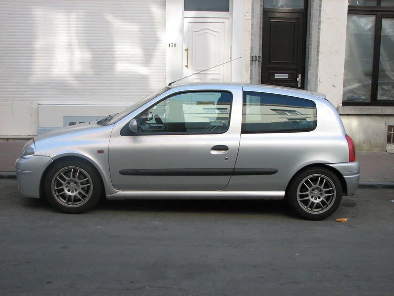

2 shots of the car to show its current height:

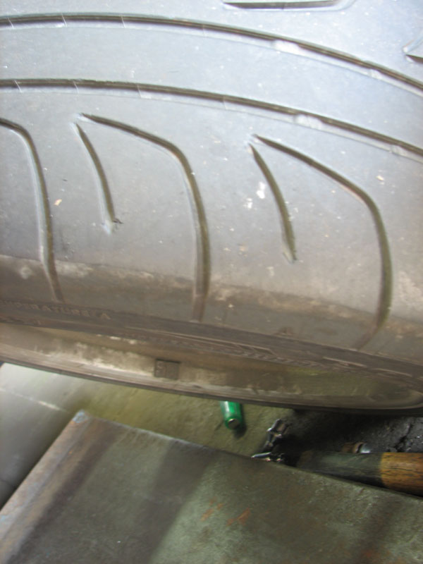

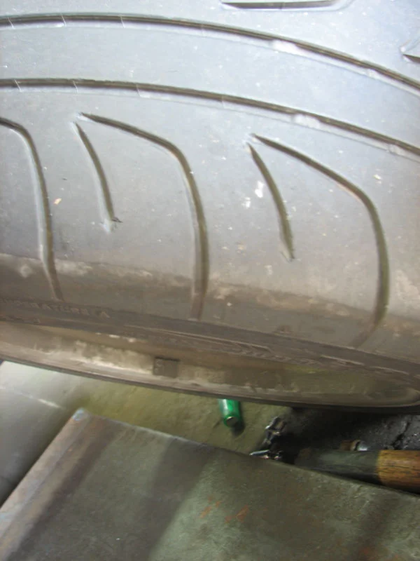

also, outside edge of what was one of the front tires, now switched to the back:

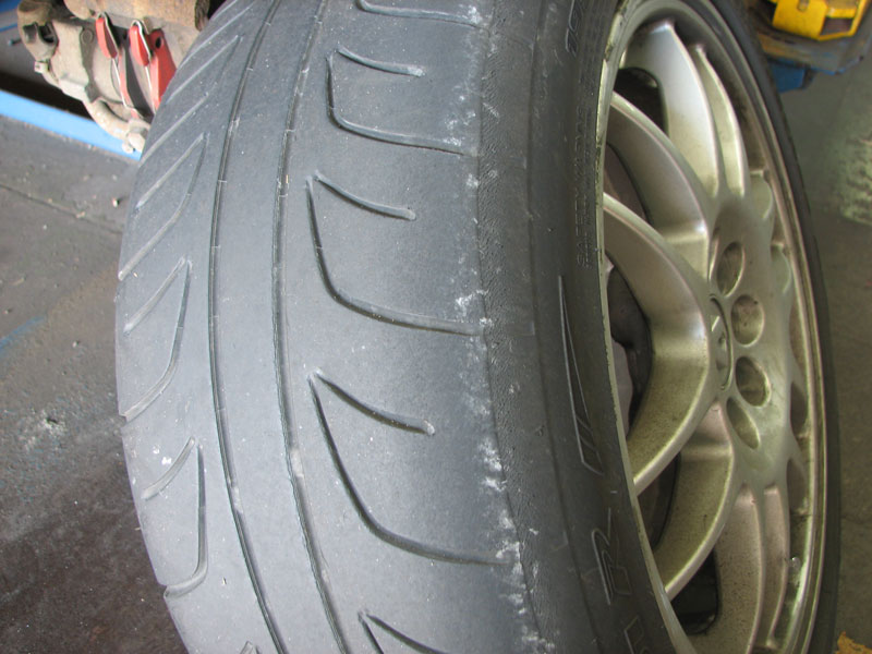

inside edge:
should I switch the tires between left and right already?

jeez that is odd, never ever heard/read of that happening!? lol?

something's definately not right. wishbones sitting too high?
Re: how do people lower their cars 50-60mm when my driveshafts are rubbing with just
This is very weird! It almost seems as if the wishbone is coming up to high. Where is it hitting as it looks like its hitting the wishbone from that angle and where the marks are?
I'm confused as to the wishbones comment :o
The driveshafts were hitting the car frame, notice the dark line around the driveshafts and the dents in the car body right above the dark lines.
The photos were taken from the front of the arches when the wheels were removed, with the car lifted up on a bridge, so the suspension was at full extension.
Sorry, I didn't see the dents up the top! It seems as if your engine is sitting to high, causing the wishbones to then be higher. Only thing I can think of!
Lol, oh, wasn't looking at the pics properly obviously. :D Dampers haven't gone have they?
