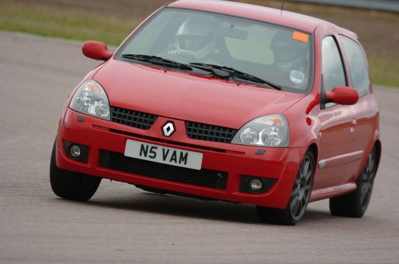

My T has just as much roll as yours:

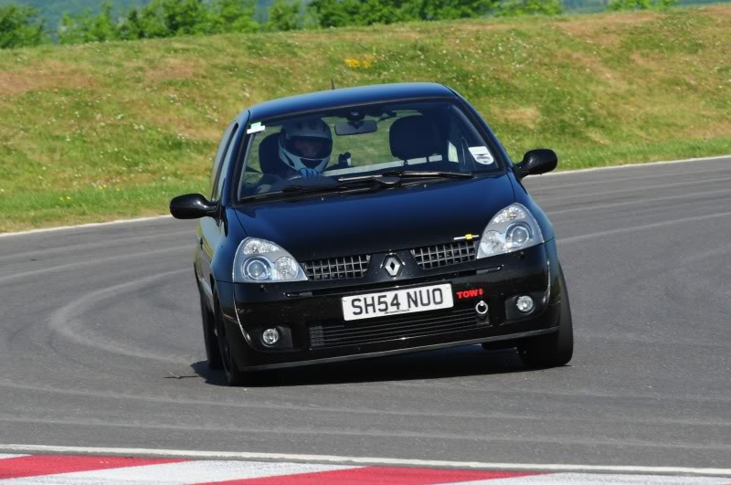

He's running 16's,

Yeh so your pics... are similar, if not worse than mine whereas I got rubbing and you don't :(
I have noticed that on the NSF archliner, there's a little bit of plastic that was covering sharp edges to some metal. I think that bit of plastic use to catch so it has now been removed, which has now however exposed the metal :s Surely my springs (NSF especially) shouldn't compress that much!

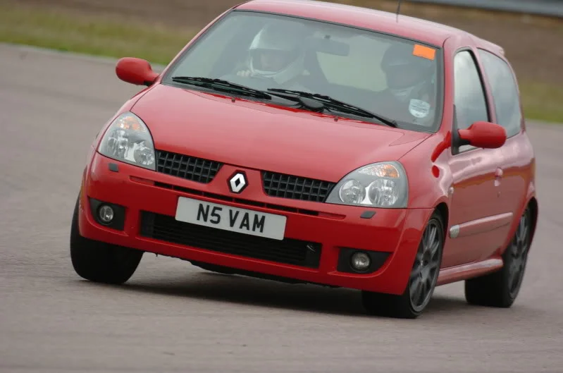

This is a pic taken from Castle Combe this weekend...
The car was again scraping on the NSF. Now there can't be THAT much bodyroll... can there?
