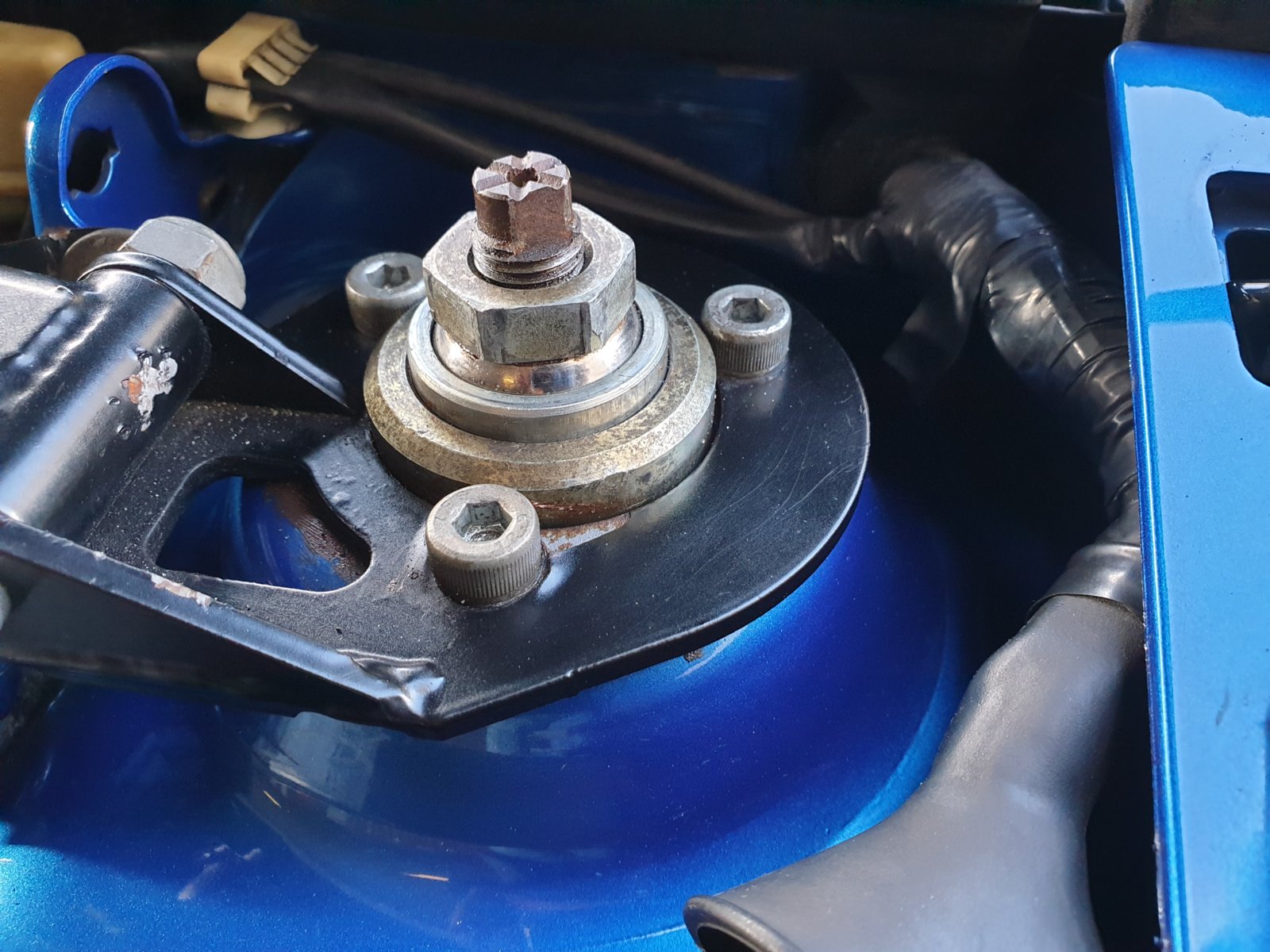

Seems like the bearing is coming up?
@puremmotorsport, is it possible for the inner race to seperate from the outer race?
saw the same few years ago, only seen it the once. replaced the bearings and they were fine.
circlip is at the bottom, this is coming out the top!
tried pushing it back in a vise, broke the vise.
next up was some threaded rod, washers and nuts...that did the trick, I even staked them! But the weight of the car pushed it up a little again.....
Need to go to a meet on sunday, so Urgently need to find a pair (one spare, always have a spare!)
the bearing is in a sleeve fwir and it gets punched up and out of the sleeve. don't waste your time pushing it back in, will come straight back out once you drive it.
