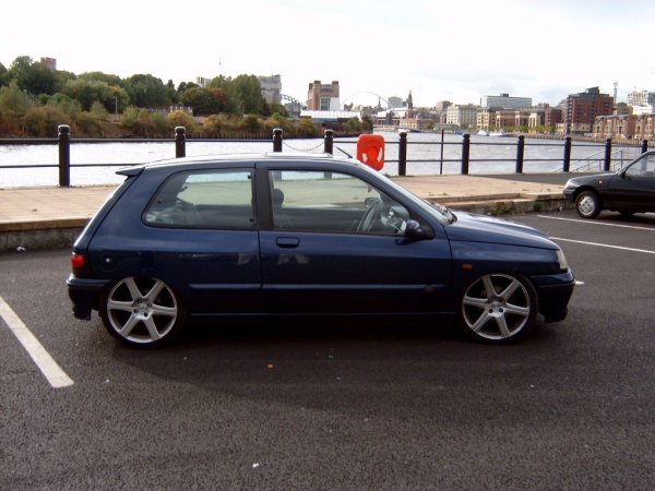

me and my cousin both run a problem free drop like this its a bit bump tho
60mm front and 80mm rear

My car scrubs a bit lowered 40 mil but your car takes the piss and looks the nuts! Defo the look im going for! Did you have to take ou the inner arch or cut the bumper on the back at all?

takes the piss that low
that is actually my cosuins car (sxi boy on here)
basically all u need to do is remove the rear arch liners and then get it slammed, then on the rear bumper its very close and wise to trim a tiny bit, usins some sand paper very slowly, as for the front your ok, if you go lower thabn this, you will need to do sum work to the archs but not much
it does scrub on front liners on big bumps and lock but not often, so its not worth removing them and getting sh*t stuck up every where

Not to mention the effects that removing arch liners cause, aerodynamics, rust, brick holes through the rear bumper...

yeh, but the rear arch lines need to be played with if u want to keep them in,
iv not had problems
stop worrying and get one with it!

well mines should be 70mm at the front, but iv not driven the car since its been lowerd and its the same as the above blue valver so it might come down a little
